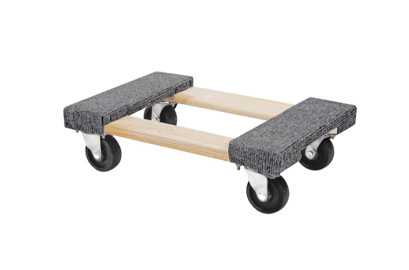

That's what I do. 4 zipties and I'm done. Zipties and Harbor Freight dollies go well together. I also put my mac2400 air compressor on a HF dolly, about 10 years ago.
Those Harbor Freight dollies are great for a variety of uses. I bought a dozen 18" x 12" when they were on sale last year for $6.99.
Not sure about the 1000# rating, but I use them under some 700# implements with no problem.
   / Easy way to install the wheels on the generator. #12
I've got probably dozens of them. Supporting everything from a 900lb chipper to a small toolbox. I've got about 2,500 sq ft of concrete floors in my sheds so they roll fairly well. I even got a couple of 6'x30" tables (bought on surplus for $10) zip tied to them so I have "rolling tables" to reconfigure my shops easily.
Have to roll them occasionally if they have a heavy load because the wheels tend to flatten.

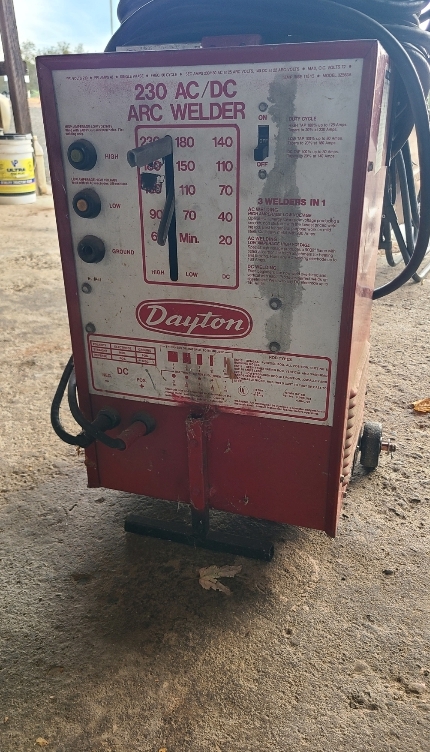

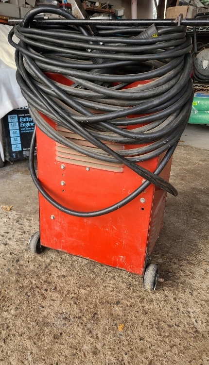

My 60's PowrKraft 230AC is on a wide hand truck intended for torch bottles. First owner widened the hand truck, crude but effective. The welder is the size of a Tombstone, too heavy to move around if it weren't on wheels.
Attached simple small wheels from recycled on the heavy welding machine is makes life easier 😅😅

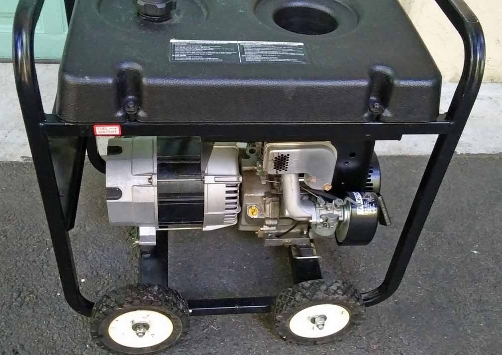

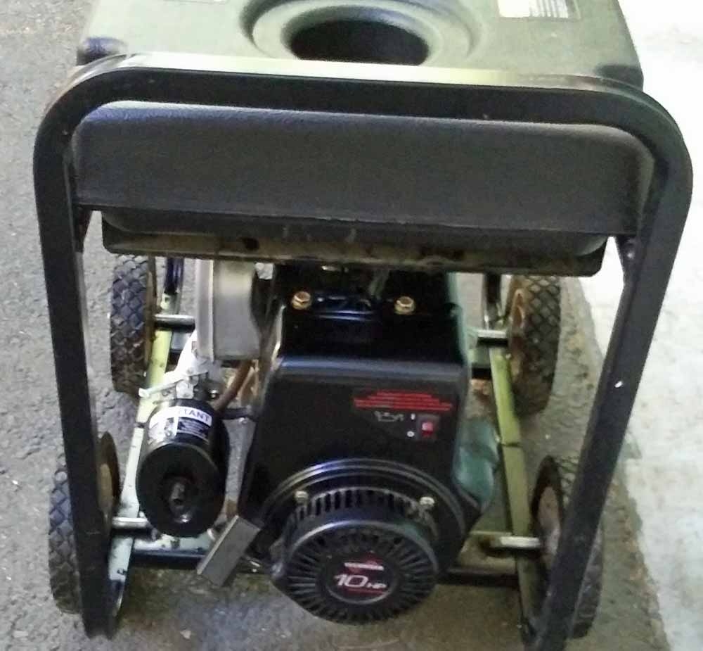

I have long since sold my super-loud, but reliable Generac 5000 generator.
Here is how I did it. I used lawnmower wheels, which I had lying around, and no casters. Super-easy, with welded on axles, also from scrap.
This approach allows you to pull-start without dragging the genny, as SCOOTR states, but it also will not roll down a slope unintentionally.
Vibration on these units is fierce, so I suspect the pivot bearings on the casters would suffer.
Later models often came with a rear pair of wheels, and a long handle to help lift, but also so it was stable when set down.

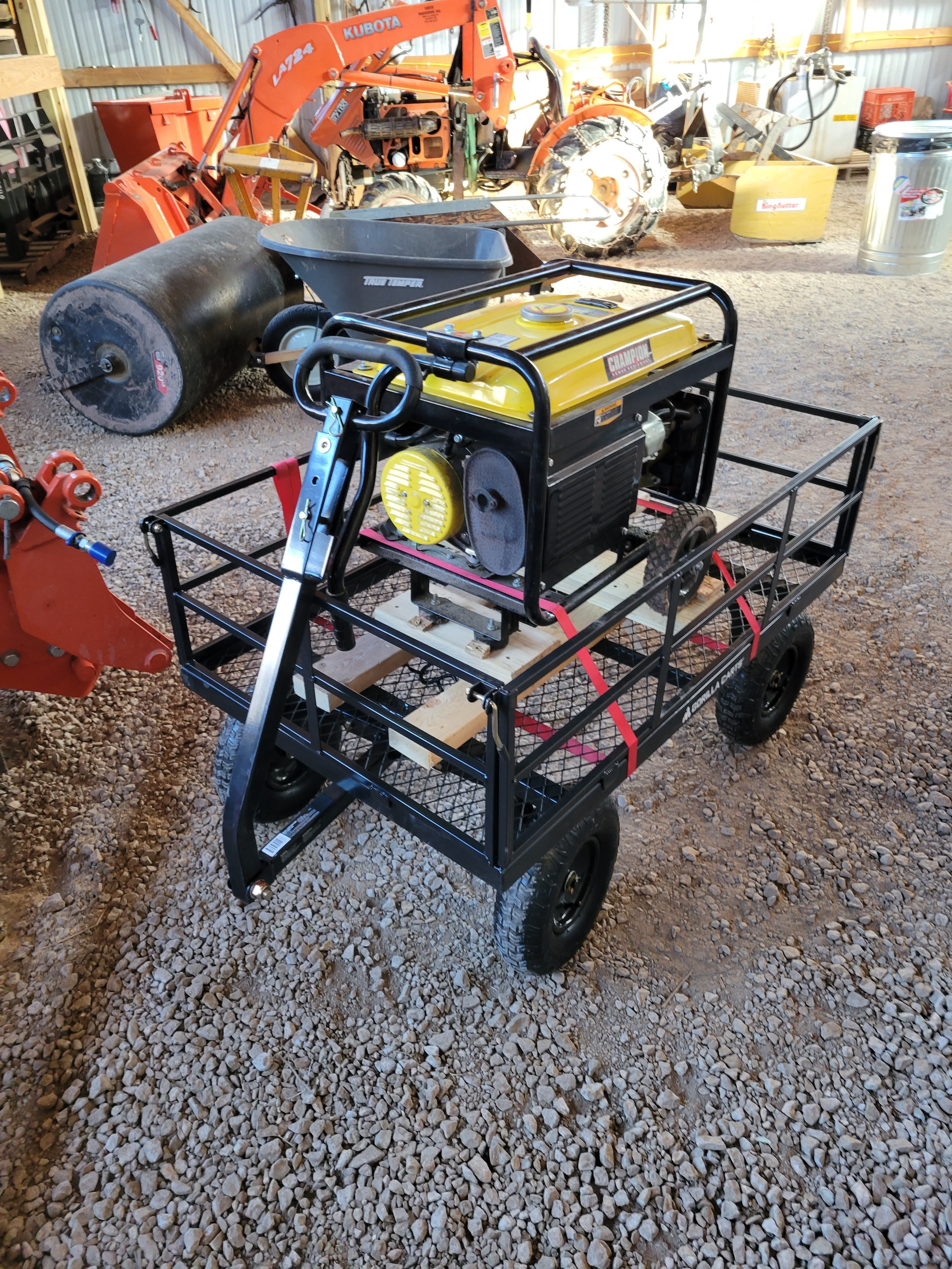

Champion 3500/4000. This what I did, concrete in the shop only. It works for me, because I have arthritis every joint. This
way it's easy for me to check or change oil and start it. Total weight about 200 lbs.
That's a good idea. Where did you get the nice wide cart?
   / Easy way to install the wheels on the generator. #20
Gorilla wagons, from Amazon. Mine is rated for 1200 lbs, change the handle and be pulled by a garden tractor etc. They
come in many different widths and weight rating. I had a narrower one on order, but someone stole it in Lower Michigan
somewhere. I cancelled that order and bought the wider one for more stability. It come with air tires, which I hate, so I
bought 4 airless tires in case I need them. There are also other brands very similar.
