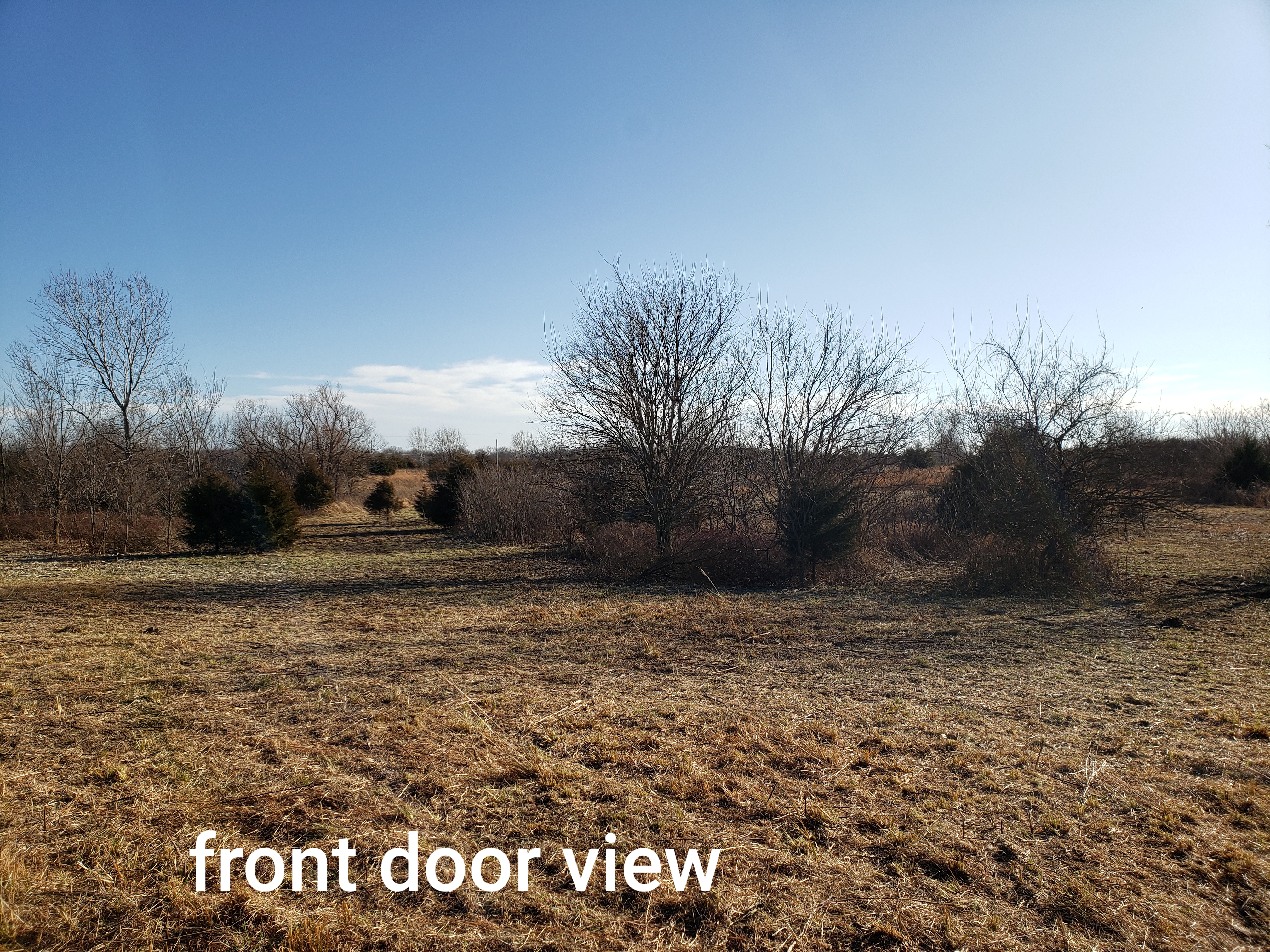

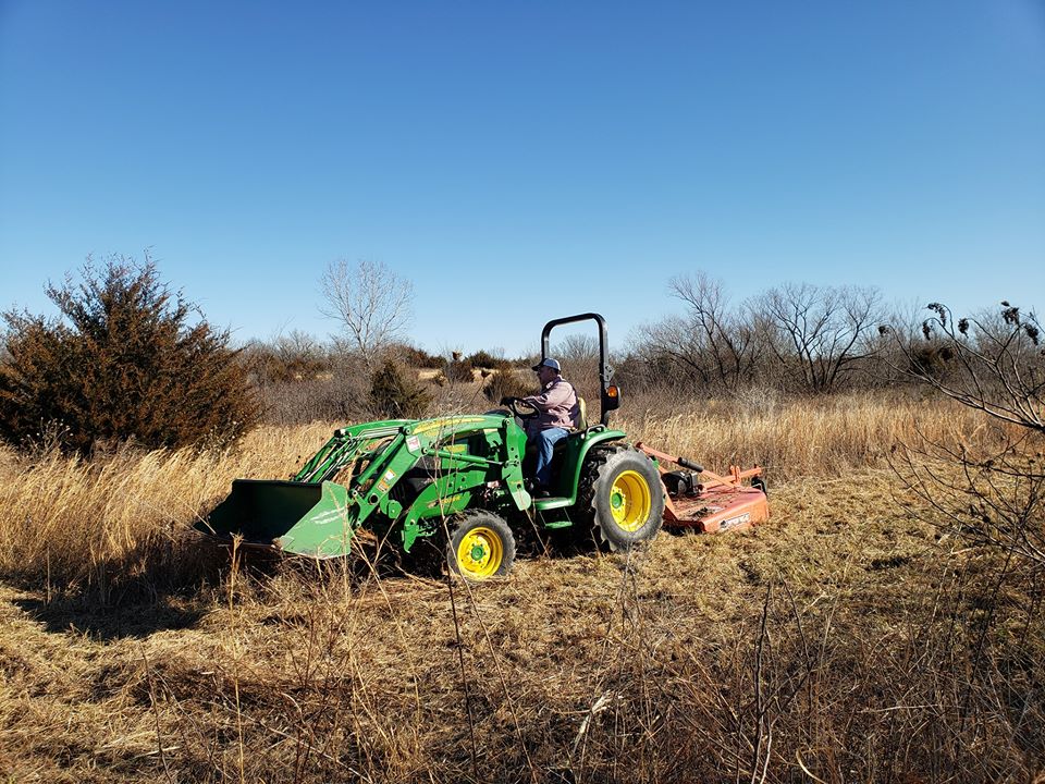

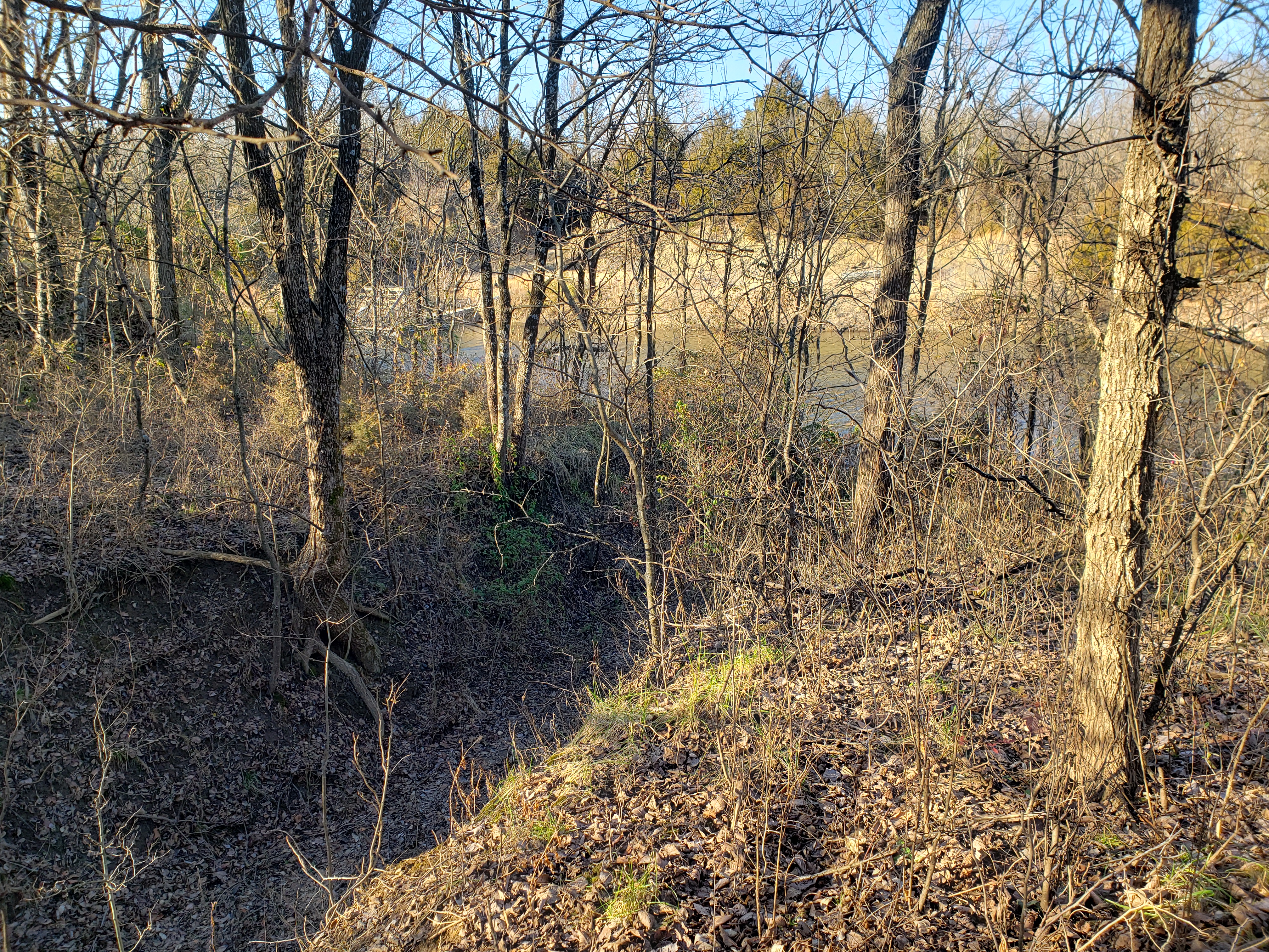

Just a few pics of what I have to tangle with. It's relatively flat for the most part. Ground is strip mine spoils, 2 inches top soil then some clay and aggregates, nothing super hard or large to deal with. The back border of the property is an old strip pit. It's 30-40 feet deep, was mined back in the 1910's. I cut out a crude trail with machette down to the water. The land sits up about 20-25 feet above the water level. The pit runs about a mile or so in a letter E shape. There is 2 other houses along the pit that have boat docks. Most of the pit land in Kansas was taken over by the Wildlife Department and they are fisheries and wildlife areas, so it's actually very rare to get private access to a pit.
I have a total of 10.3 acres in 2 different parcel. I'll build my home on one and leave the other mostly untouched except for hogging it a couple times a year. I may build another home there in the future for kids, parents, guests, who knows. It's just sort of in my back pocket.
Build plan is 96x40 post frame house and garage combination. Half is shop, half is house. I have the building engineered and just waiting to buy materials. 12 foot over the house and 14 foot over the shop for truss heights. They will be heel trusses though so I lose 2 feet of ceiling, that's strictly for insulation and being able to keep the HVAC within the insulated envelope. Without spending $15K on closed cell foam. Doing everything ourselves I expect to be into it about $180K total when finished and should appraise in my area for $320K range.
That's an extra special glimpse into my grand plan. I have no experience building anything but my wife has worked in the trades and is very capable. I think we are both fully capable or doing it ourselves and it's going to be fun, suck some days, we will make mistakes, probably injure ourselves, argue, yell, scream, and look back on it all with fondness in the end. I hope. :laughing:
Tractor work will be clearing, leveling the build pad for slab on grade, standing up walls, hanging trusses, moving building materials, backfill, gravel work, septic field, 600 feet of driveway. Maybe auger work if the attachment is available to rent. I'll also need to rent a mini-ex and probably a lift to work from. We're going to do it all straight cash and take our time. We have a 2 year window before we expect to move in. That gives my daughter time to finish high school where we are now. It's about a 90 minute drive to the new place, so there's that part too.
I'm probably insane but I gotta do what I gotta do.

Back to the earth moving subject. Sounds like I need heavy tractor and heavy tools to move dirt. I'll get the tooth bar for sure, maybe ratchet rake. I don't know about spending $3K on a heavy duty box blade though. Can the lesser blades do the job, short term, with added weight? Maybe rippers, middle busters? Whatever I can do, short of renting heavy equipment or paying for someone else to do it.
As far as doing the driveway, I don't think I will need to dig down too far maybe 2 inches. There should be clay a couple inches below the surface. Then put down railroad ballast type limestone down. Let that sit and get driven over by construction vehicles and set up nice base. Then do some 3/4 minus or similar on top, after the construction is complete.
The house and shop is post frame, so I don't have to be dead nuts flat for the build site but I need to be pretty close, within a few inches. The key will be getting the base for the slab level and perfect before we pour concrete. Planning to do insulated slab with radiant.
