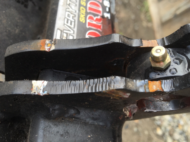

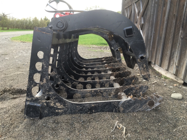

I'm eager to see the "improved" part. The original didn't look bad.
/ EA Wicked Grapple Carnage! #62
The model T was the best car Ford ever made. Almost ran them out business with not needing replaced. They learned well after that.
Good one Murph. :)
/ EA Wicked Grapple Carnage! #63
Didn't look bad in the failed pic or the Pre-failed pic??
/ EA Wicked Grapple Carnage! #64
Thumbs up for EA, but as to ovrszd input, (not criticism) I agree. Equipment/attachments of this nature will always be abused or pushed to it's limits, and should be designed 40-50% beyond "rating". It appears to me also that there was clearly room for improvment on that cyl. mount. Attachment weight becomes more important as the carrier gets smaller, but another 2 pounds of steel on those mounts is irrelevant.
Again, it's refreshing to so a company "stand up". They are clearly in it for the long game.
#65
Well I'm not the best at stopping to take pics, but I have the lids both done. Can't see me ever needing to address these again. The replacements are stout. I need to use the grapple to clean up a neighbors downed oak tree so I might wait to do the rear since they will take a little longer. Total time was prolly 1.5 hrs so far but I was taking my time
Brett
