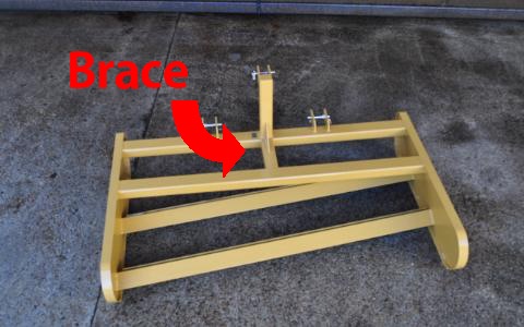

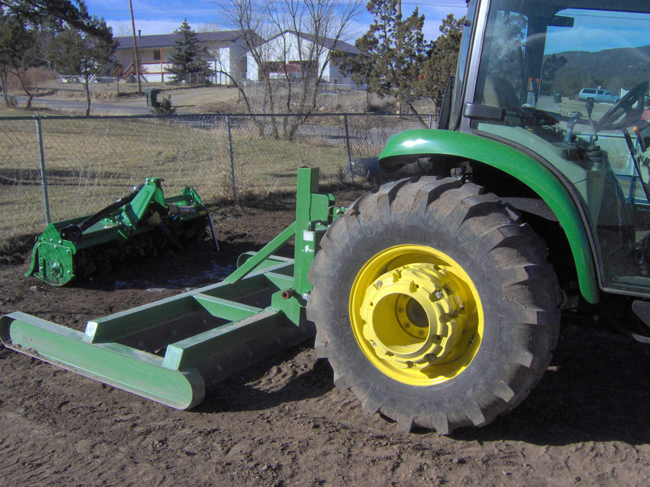

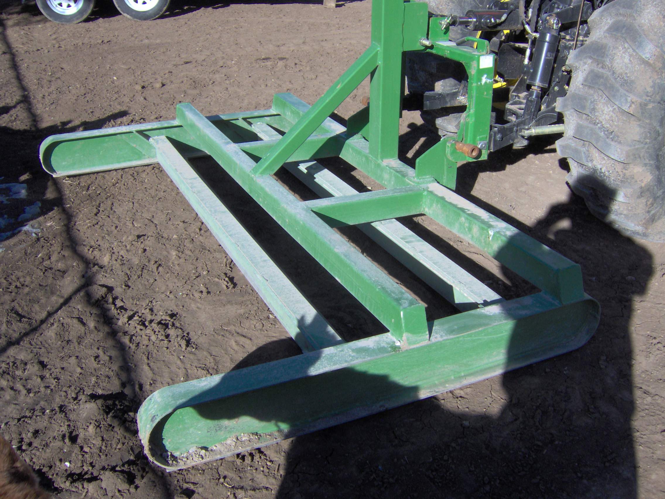

I have 1 brace and I doubt that it does all that much, although every little bit helps. The GradeMaster looks to have a tube in there to me. When things are built with 3/8" & 1/2" steel, not as much support-bracing is required. As far as the hitch points, those look to be about 14" off the ground. Where do you think that they need to be for your tractor?
If you are willing to wait, you should be able to get the LP unit without any shipping charges, although those guys will sure try to get them from you.
Just my :2cents:
The lower link points do not have supporting connections to the rearward cross bar, that is all I am saying.
I would think thick enough steel would work but I like the idea of the extra bracing.
Your picture shows that little piece of steel for the upper connection but the lower connections have no extra bracing.
The LP Unit have the extra bracing for the lower pins that extends rearward to the second cross bar; I like that idea.
It is just something I have in my head that allows better distribution of the pulling effort. Is it any better, I don't know for sure, just something I like.

I don't think you need the extra strength extending from the lower pins to the rear crossbar for pulling but they are very important to reduce twisting of the frame when viewed from the side. I am not an engineer but I do know that the frame on a plane needs to eliminate the twisting or flexing where one side runner might want to climb over a mound while the other side follows the ground. In order for a land plane to work its best the frame work needs to be very rigid.
Having the cross tubes and support frames align with the hitch mountings provides the distribution of pulling forces and helps reduce the frame twisting and flexing.

I think what will be found is that the units with all the bracing are units that are built with smaller thinner material. I know that my LPGSers have very little bracing, are as rigid and heavier than most anything currently available.

Look at the size of the tubing, not much comparison in strength there. I believe that back when this front to back bracing thing came into this thread, while the picture that was posted did not have that bracing, the poster was talking about a wider than 5' unit and the wider units do have that bracing between the 2 cross supports.
If you look, the LP with the extra braces appears to have a piece of 2.5x2.5 or 3x3 angle for the 2nd cross bar vs a piece of 2x4 tube. That could make enough of a difference that the 2nd brace is unneeded.
Aaron Z
Best if both front and rear cross brace are made of tubing, very easy to twist angle iron end to end but tubing is difficult to twist. I have 4x4x5/16 front tubing and 4x3x1/4 rear tubing on my plane. If I did it again I would use the 4x4 tubing for both.

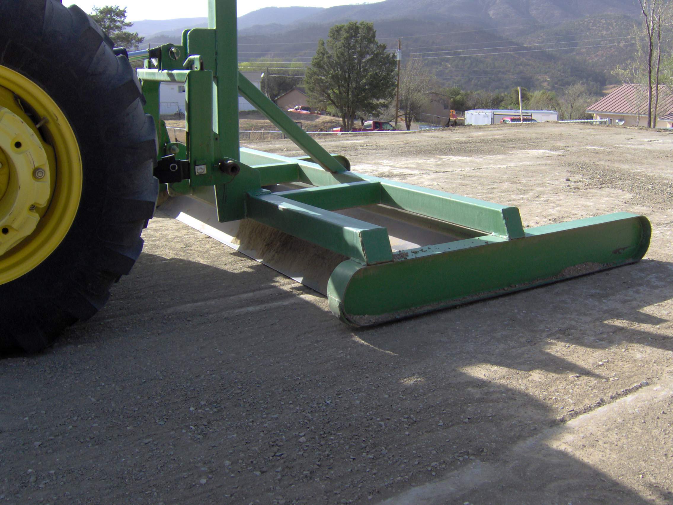

Well, the OP asked about EA's land plane. Most any will do what my homebrew does and then some, but to buy one my vote goes to Everything Attachments with no reservation(s). :thumbsup: (IMO it's the one to copy if one has more time, mtls than $$)
Of course, with PEC or similar it's not much trouble to switch implements, so I use the box blade for ripping and finish with my unnamed prototype 'finisher'. It's not just about the tool, but how well you apply it. tog
