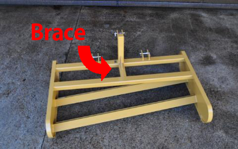

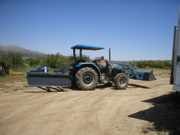

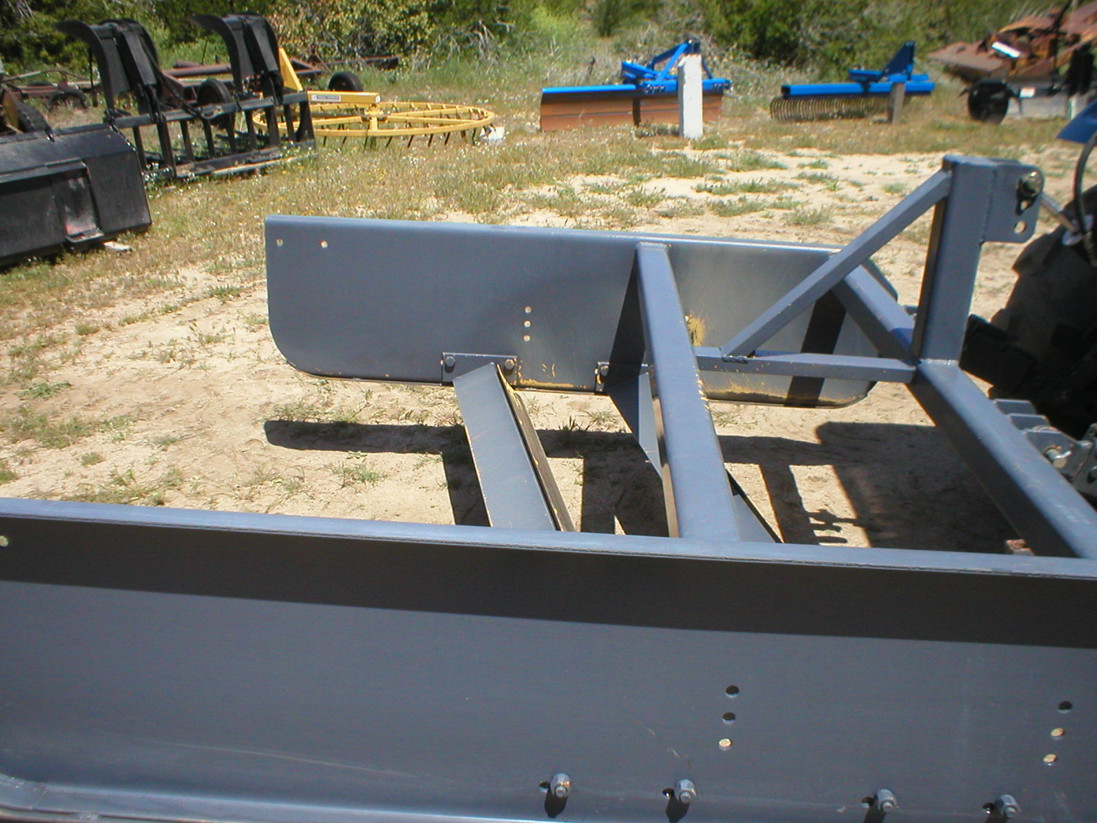

Yes, a tiny triangular gusset and no side bracing. I'm not saying that would be totally necessary for general use with a 40hp and under tractor(which is what theirs is rated for), but we all like a little extra don't we?
A unit with back and side braces would withstand more punishment and be more likely to survive a side impact from a blunt object.
Regarding the cutting edges, wouldn't flipping the blade and having a brand new edge be better than moving down a worn out edge?
I'm not saying that the other wouldn't get the job done, but i think they're far more than a couple hundred dollars of extra value packed into ours.
Travis

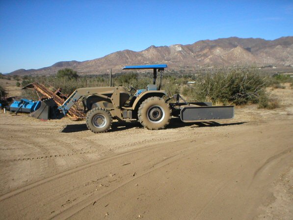

As far as the side-side bracing, all I can say is that neither of mine have it, I am pretty sure that no one else on TBN uses their LPGS behind a 12,000lb tractor, moves as much dirt as I have. I can move over 3 cubic yards at a time when the conditions (moisture content) are right. If you take a side hit that would damage the mast, you have major 3pt damage before that ever happens, wouldn't you?
As far as the reversible cutting edges, yes it is probably better to be able to turn the blade over and have a nice new cutting edge. My reason for bringing it up is that so many people see or hear (non reversible edge) and think that they only get that 1"-1 1/2" of wear when there is a very good chance that they get double that. ;)

If the photos on their website are accurate, it doesn't look like the grademaster's cutting edges are reversible.
Hitches are way different...no back braces and nothing for side stability.
No other specs are given, so it's very hard to even compare.

I looked at the pictures of the Grade Master Unit, heavy duty, but my main thought of aggravation would be the lower two hitch points. HD at first look but there is no attachment from the front cross support to the second cross support, there should be an attaching bar to spread the pulling stress.
Thks for the info, good looking product but I am still looking to Pally's to supply me with a 60" Land Pride Unit and you for the hydraulics.
   / EA Land leveler for driveway, comments please #39
??????:confused:
I have 1 brace and I doubt that it does all that much, although every little bit helps. The GradeMaster looks to have a tube in there to me. When things are built with 3/8" & 1/2" steel, not as much support-bracing is required. As far as the hitch points, those look to be about 14" off the ground. Where do you think that they need to be for your tractor?
