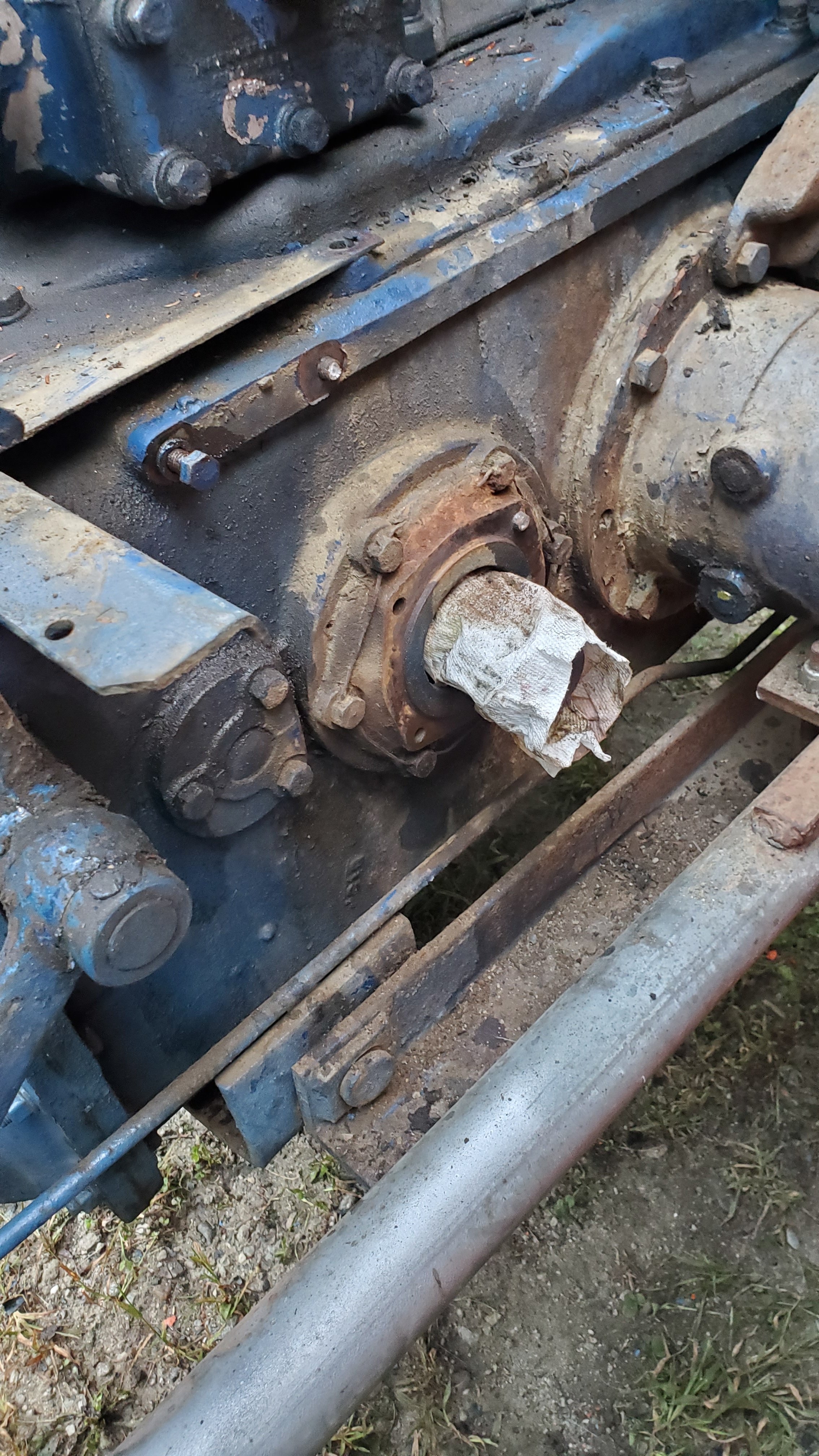

The left side brake on the e27n has always been "grabby", and since it's such a nice summer day I thought I would dig into it and see what might be a miss.
Turns out the main pivot stud is broken off at the mounting stud threads.
I just got it all apart and half cleaned up. The piece is mounted in the lathe four jaw chuck, I'm going to drill and tap it for 1/2-20 to replace the missing stud.
Also going to spend a little time looking for a replacement. But it looks like the Fordson Diesel Major brakes are different. Two studs instead of one.
Oh well, tractors!
/ E27n Fordson Broken Brake Pivot
#2
Well, The stud is all repaired and bolted tight to the backing plate.
I only snapped off two 3/8 in dia. cap screws getting access/ '-(
Fortunately each left a short stub protruding from the cast iron/ The smoke wrench should have an easy time of it,,,,tomorrow!
I'm tuckered out from all that clambering around.
All back together again.
I'm getting to old to be crawling around, up, over and under old tractors in the yard. I guess I should be happy it's not a little one that would be harder to get under.
Boy , did I ever use the gas heating up those broken cap screws! But they did come free. So all is well.
