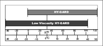

I have a JD 4310 E Hydro and I'm getting ready to change the trans oil, the dealer sold me Hy-Gard low vis for year around use.
After looking in the manual I see that this oil is only recommenced for up to 80 degrees.
Is this right? I can use just plain Hy-Gard, but not sure about winter use.
What do you guy's use that have hot and cold weather?
I use the tractor for snow removal in winter, and brush hog, and tiller in the summer.
Kind of at a loss here.
   / E Hydro oil Question #2
Lo-Vis is the correct stuff.
Dunno where you got your info for 80 degrees but this is what I found from Deere:

For the reason Dave points out I use low viscosity year round. There is a small, probably unworthy of mentioning but noticable performance difference: the FEL bucket when full of heavy material tends to "flop" empty on hot days with low-vis compared to hi-vis. But it doesn't take very long to develop a feel for it and compensate.
   / E Hydro oil Question #4
And to be fair and balanced, at -20F during the winter the tractor moves much more readily with low-vis!
   / E Hydro oil Question #5
Down here in North Carolina, my dealer buys much more hy-gard than low viscosity hy-gard. I run the low-vis in my JD318 garden tractor because I use it for snow removal. When I change out the hydro oil in my JD4520 CUT, I'll switch to plain 'ol hy-gard. Due to volumes, dealer has better price and machine is primarily for mowing and will see little winter use when it's below freezing.
If I was back in New England, I would run lo-vis. So like many such oil decisions, it's "where are you" and "what are you doing".
