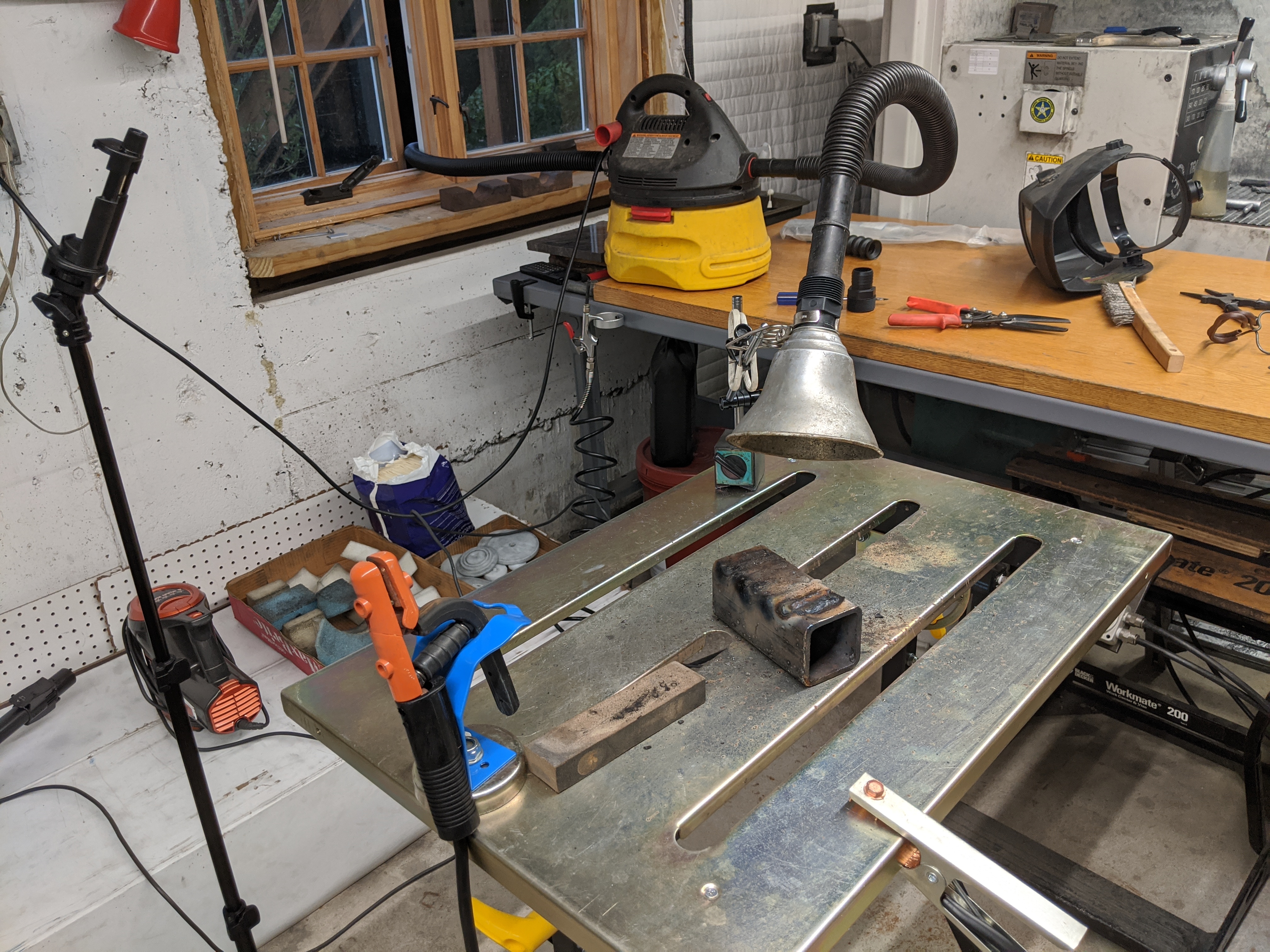

Guys, who built their own welding fume extractor? I put this one together on the fly yesterday, using a wet/dry vac. It works ok, but I'm not super thrilled with it. Here's it here:
I was thinking one of those inline duct fans with ductwork could work. The 6" ones move 240 cfm. Would that be enough for a fairly short run of duct exhausting out the window. Would even a 4" 100cfm duct fan work here?

Look at portable dust collectors the smallest will move about 500 cm, remove the dust bag to reduce the fire hazard and replace it with a length of 4 - 6" duct.

How much risk is there of you sucking up sparks or hot bits of metal with this fume extractor?
If there is, I might see about running through a bucket of water to cool off any such bits of metal.
Could also use that to reduce the nasties in the fumes going out.
If that little Shop-Vac wasn't enough, I would get a bigger one that has an actual 2-in hose and use that. I have one made by Rigid and it is amazingly quiet.
If you are going to mostly welding at the table like that, you could put a piece of 2-in metal conduit together with a 90 and a 45 to connect to your filter bucket.

Thanks man, sparks are a good point! Well wet/dry vac, I guess I could just suck some water into it, right? Yeh, this vacuum is loud! Would love a quieter one. Also, it doesn't seem powerful enough, I want it to suck up more of the fumes. Another problem is the sump pump hose I'm using to exhaust out the window makes a whistling racket. I'm thinking a smooth long hose would be quieter if I stayed on this route of using a shop vac.

I'm in a tricky position here in regards to cfm's. On the one hand, needs to be powerful enough to get the smoke/fumes out of the shop. But then, not too powerful so that it's sucking out all my heat in the winter, or my breathing air for that matter. This is a longish 1-car garage I'm working it, heating it with electric space heaters in the winter.
Here's a quick vid I made of my shop vac extractomajigger, so you could see how it's working or not working. And yeh, looking at my vid, I think the concern about sparks is legit guys, thanks for pointing that out.

Gene, a couple of suggestions. Not sure what your neighbor situation is but you might want to consider moving your shopvac outside and add a remote switch. That noise would drive me crazy in short order.

Yes you do need more CFM's for exhausting fumes, and I had to put ear plugs in to watch your welding video, ha.

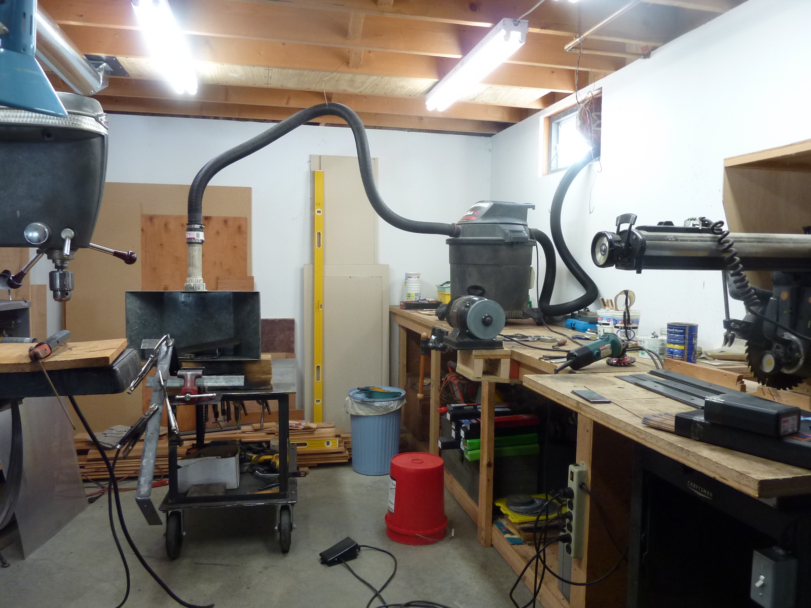

When absolutely needed I use the same shop vac idea but I have beastly vac with with a 3.5" hose. I don't use a filter and sparks are out ( I hope ) by the time they get outside where the vac sits. Instead of a remote switch I just have a cord running in under the overhead and just plug in when welding. It's pretty effective and yet I seldom use it. It takes a bit to get it set up and the small projects are done by the time I would get it set up and the bigger projects would require a lot of moving it around. There's no good way on the cheap unless you are patient and forgiving. Good Luck !

A bigger "hood" and bigger vac will make it quite effective actually if you can set the hood up right where you are welding. I have a smoke alarm about 18' away and it doesn't set it off. But as the others said I hate the noise and it is a tight area not really good for welding so I only use it when I have to in the middle of winter. I remove the filter from the vac and place a cake pan of water in the bottom. I use a foot switch to turn on and off. I also stay down there for a half hour min after I am done welding just to make sure. Never thought of putting the vac outside - that is a super idea. Wonder if it will run at 20 below....

Ha, that's what I did at first! That rocket vacuum cleaner you can catch a glimpse off in the video, that's what I used at first, and I just stuck it out the window and ran the sump pump hose from it. I had 2 problems, first the longer hose made a ton of whistling noise, it was so annoying! And then...it started raining. :shocked:

Do you have it enclosed outside, what do you do about rain and stuff?

Oh that's a bigazz hood, yeh that's a great idea! The vacuum noise is annoying though, I'm with you right there. I'm curious what a 6" duct fan would sound like, that's where I'm starting to look with this fume exhaust thing.
