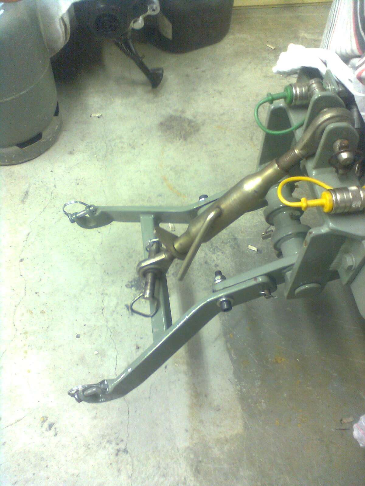

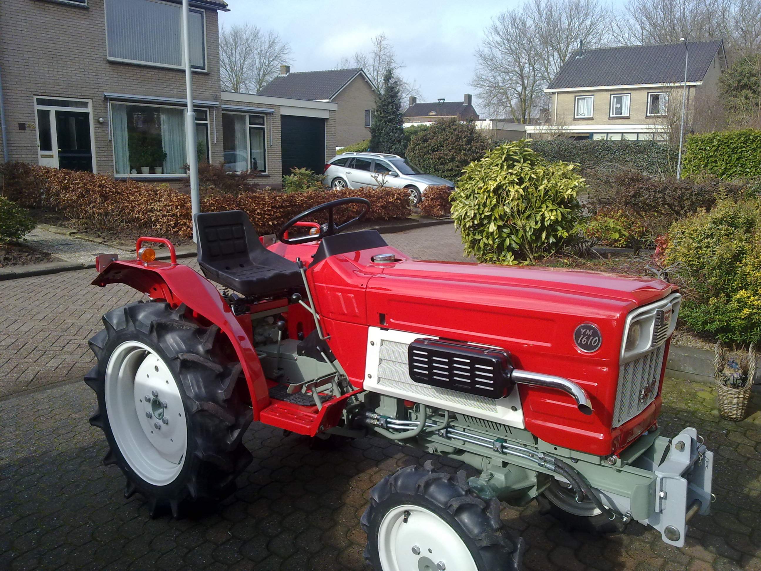

this my home made snowplow

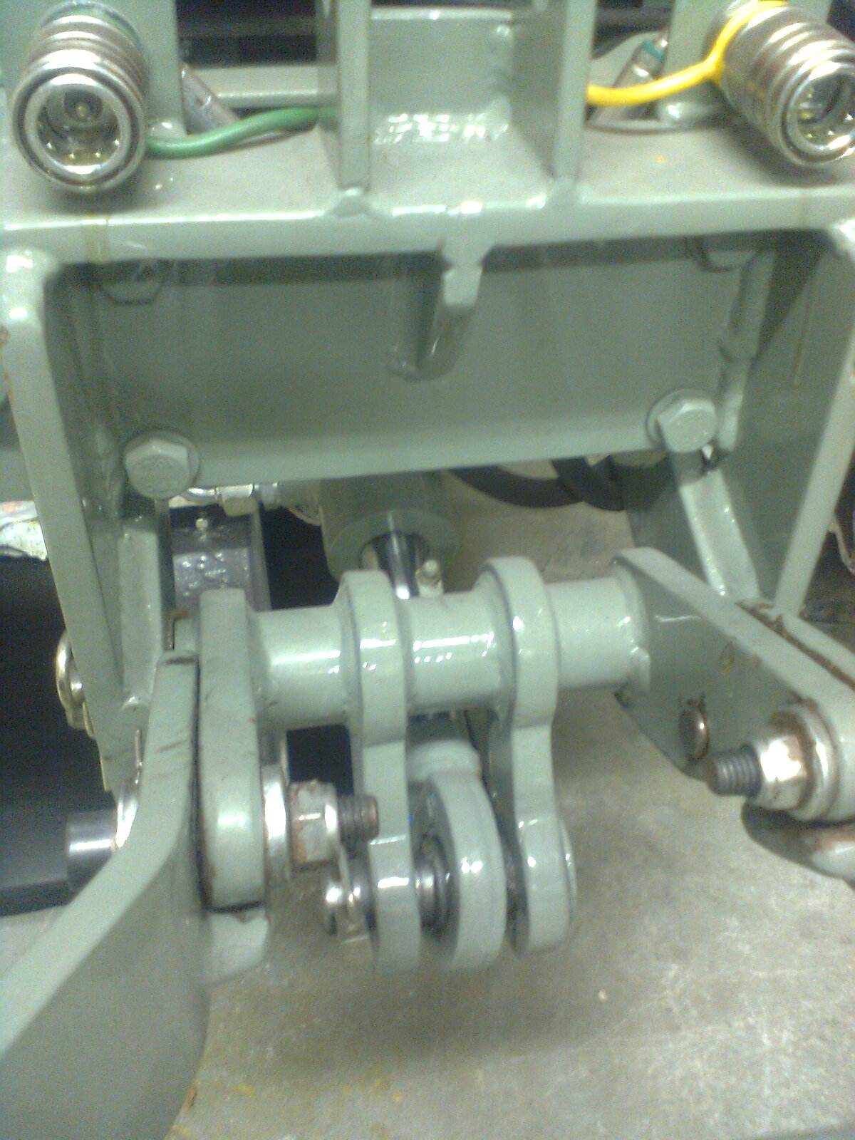

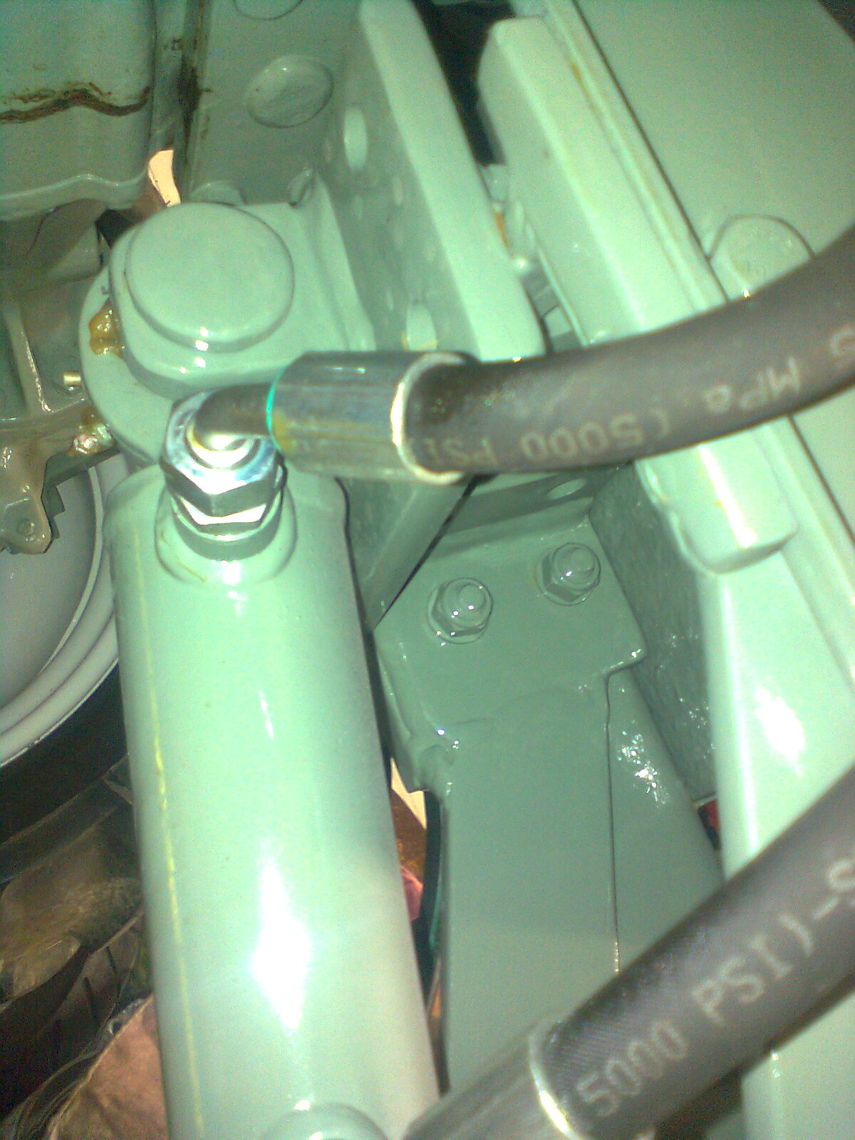

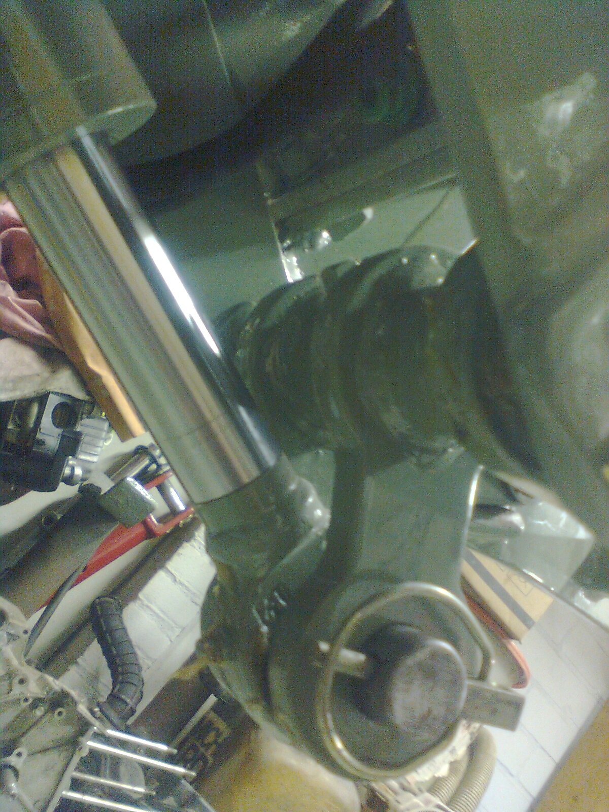

Very nice work. I have a question about how you raise the plow off the ground. I can't see in the photos, if there is a piston under the front of the tractor, that connects to the modified three point hitch assembly. I was wondering how the plow raises, and could you show a few pictures of the mechanism by which this is done? I really think you have done great job.
   / Dutch Snowplow home made #3
I really like that.:thumbsup: It looks very stable and quite strong. How do you lift the blade/3 pt? Is there a hyd cylinder that we do not see underneath the mount? Have you thought about hitting a hidden and immovable object like a curb? Many snow plows are set up so that they will tip forward against springs.
Good job. I for one would like a few more pics that give the specifics of how you mounted the lift mechanism. If you have any pics of the build post them too. let us learn from your nice work.
Mike

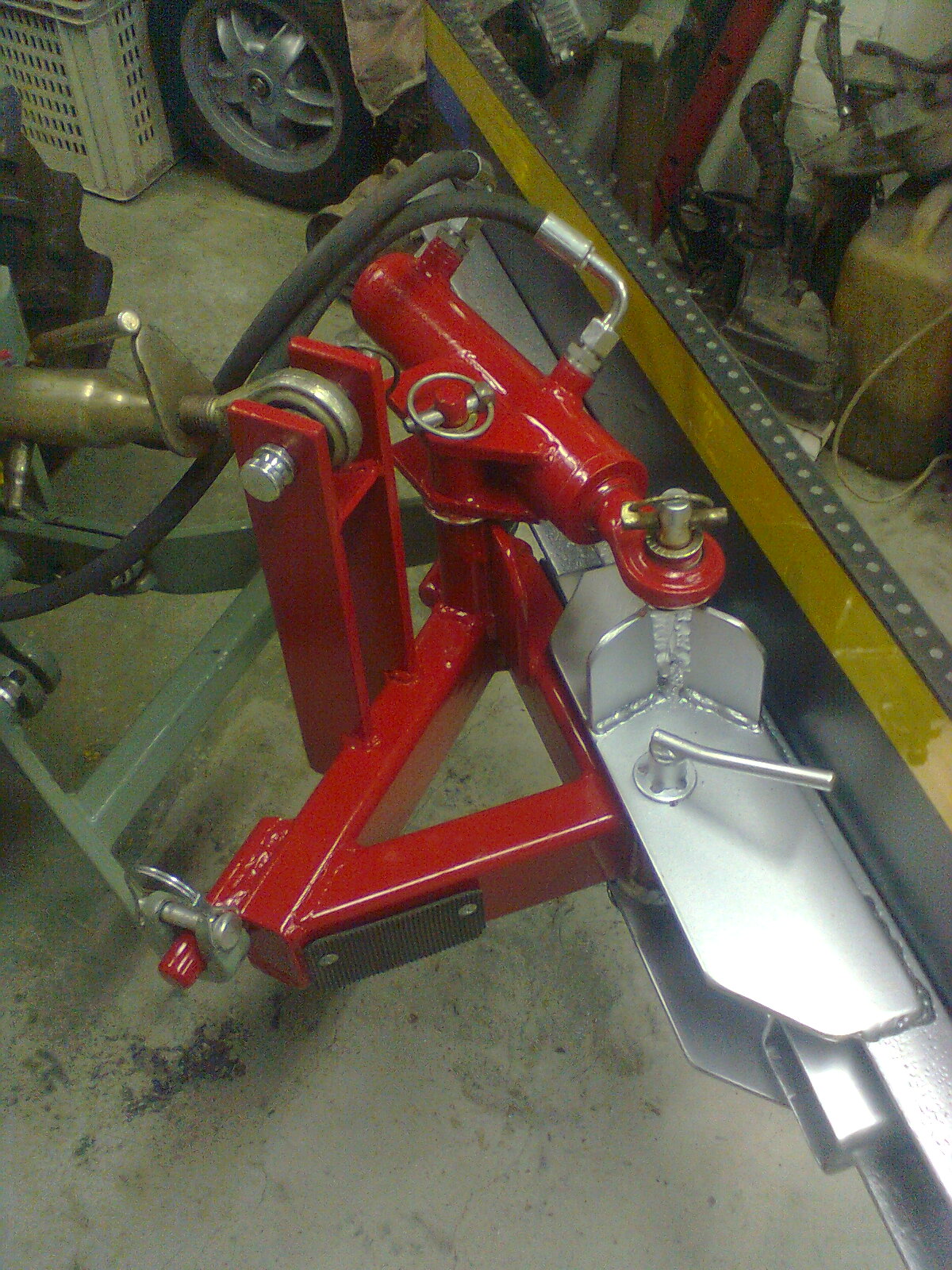

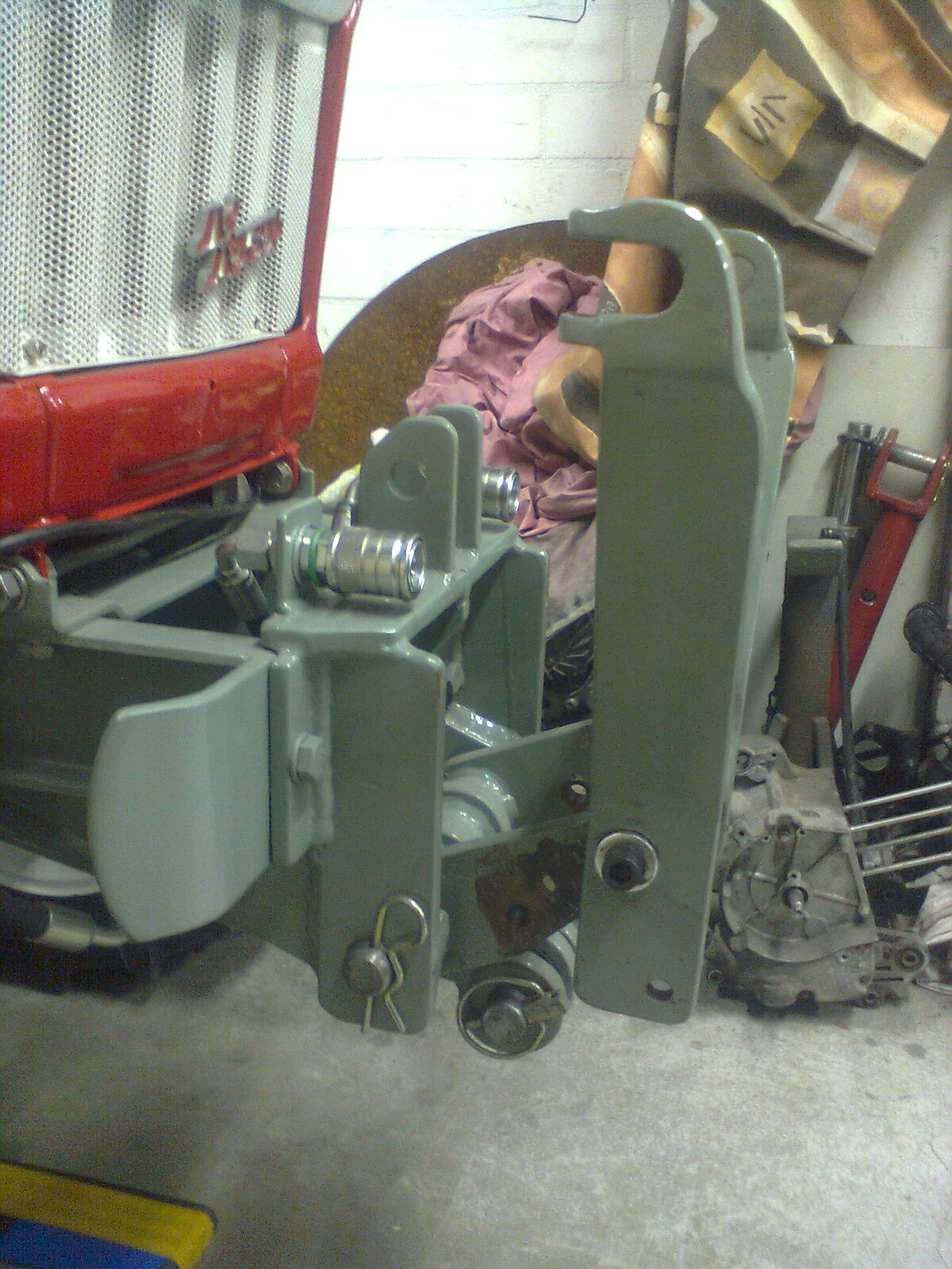

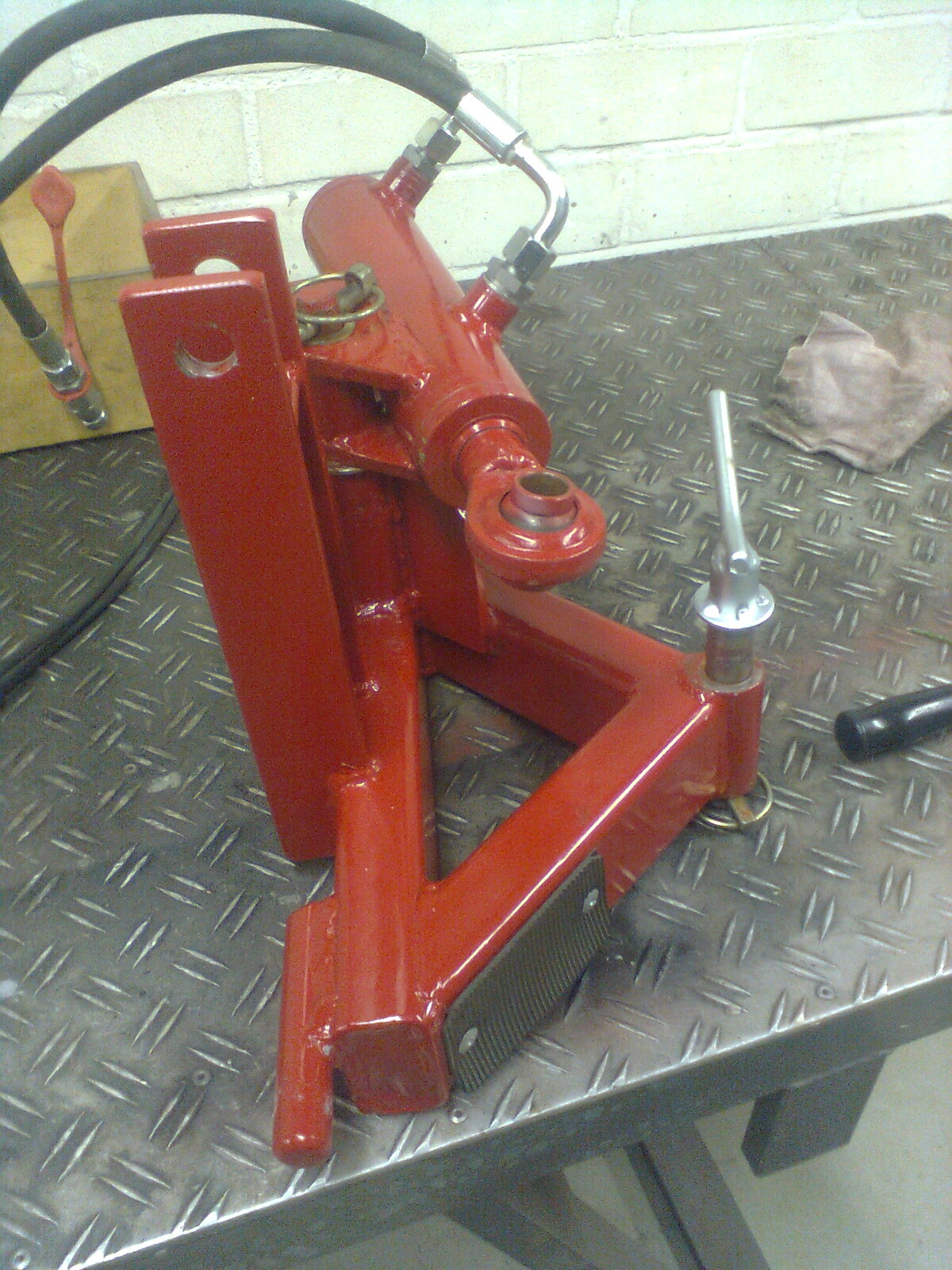

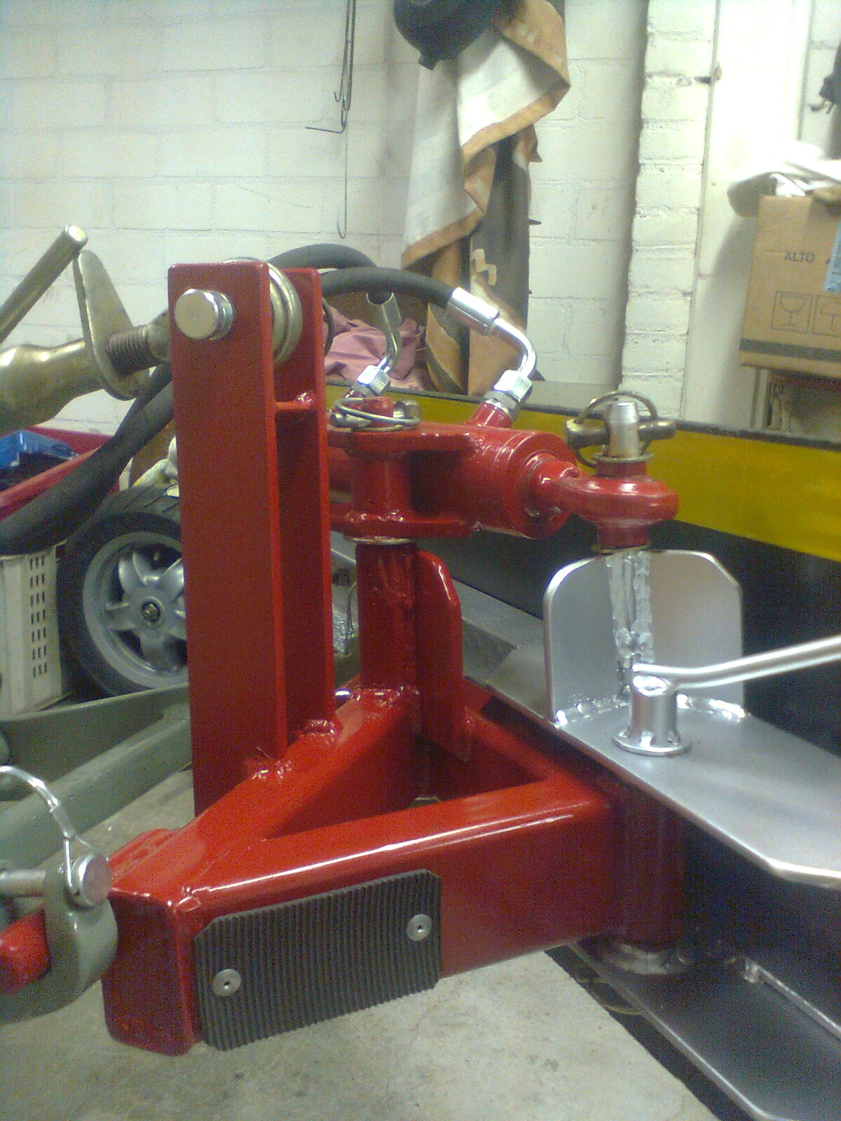

I found more pics
I have lookt at google pics "fronlift"
it can lift more than 1000 kg. but when i wil do the frontaxel wil broke
   / Dutch Snowplow home made #6
I really like the short pivot hydraulic cylinder. They do not exist at the budget stores where I purchase cylinders.
Craig Clayton
   / Dutch Snowplow home made #7
Pivot radius looks short compared to commercial snowplows. Have you moved snow with it yet? Nice fit & finish work. MikeD74t

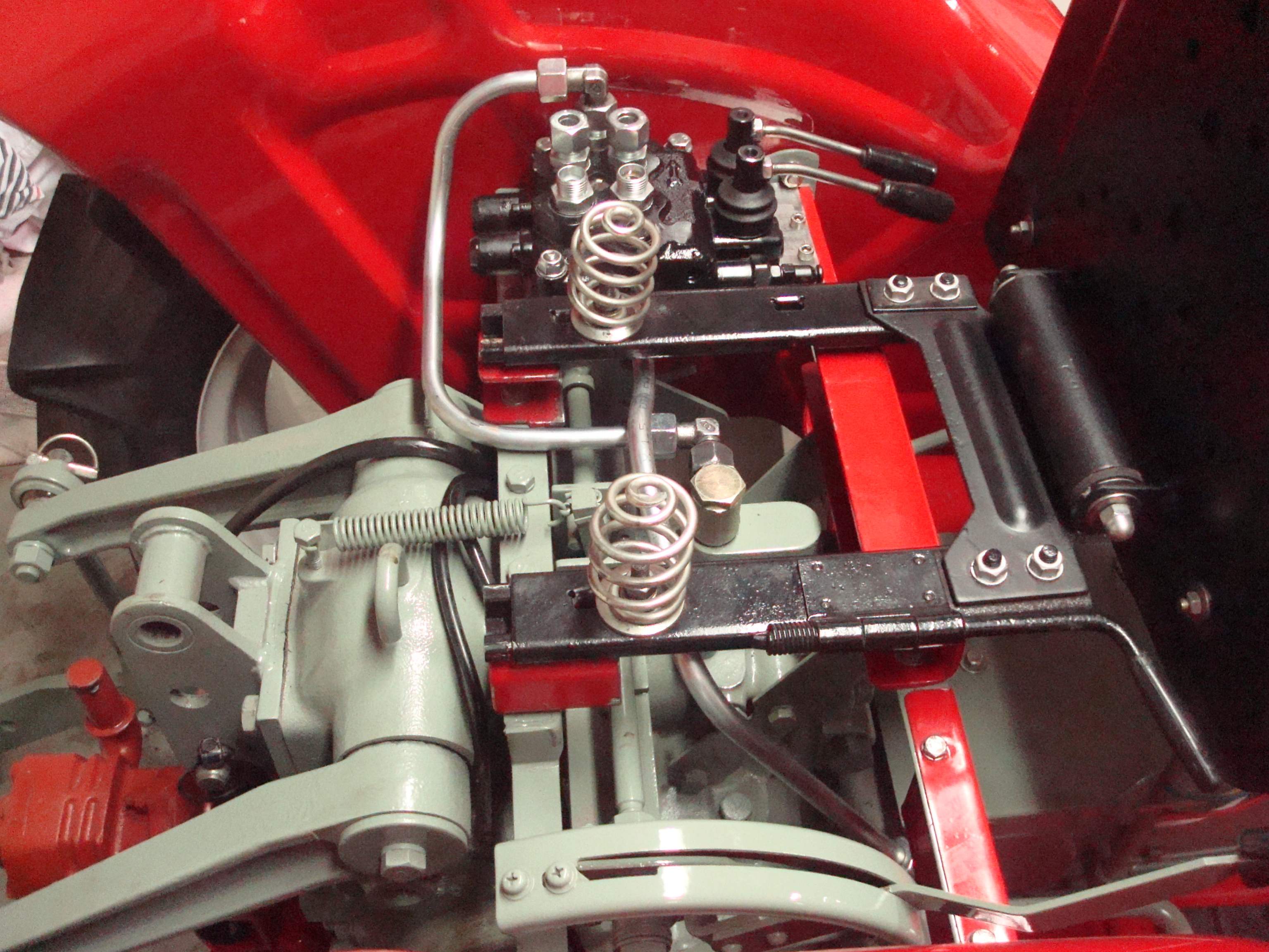

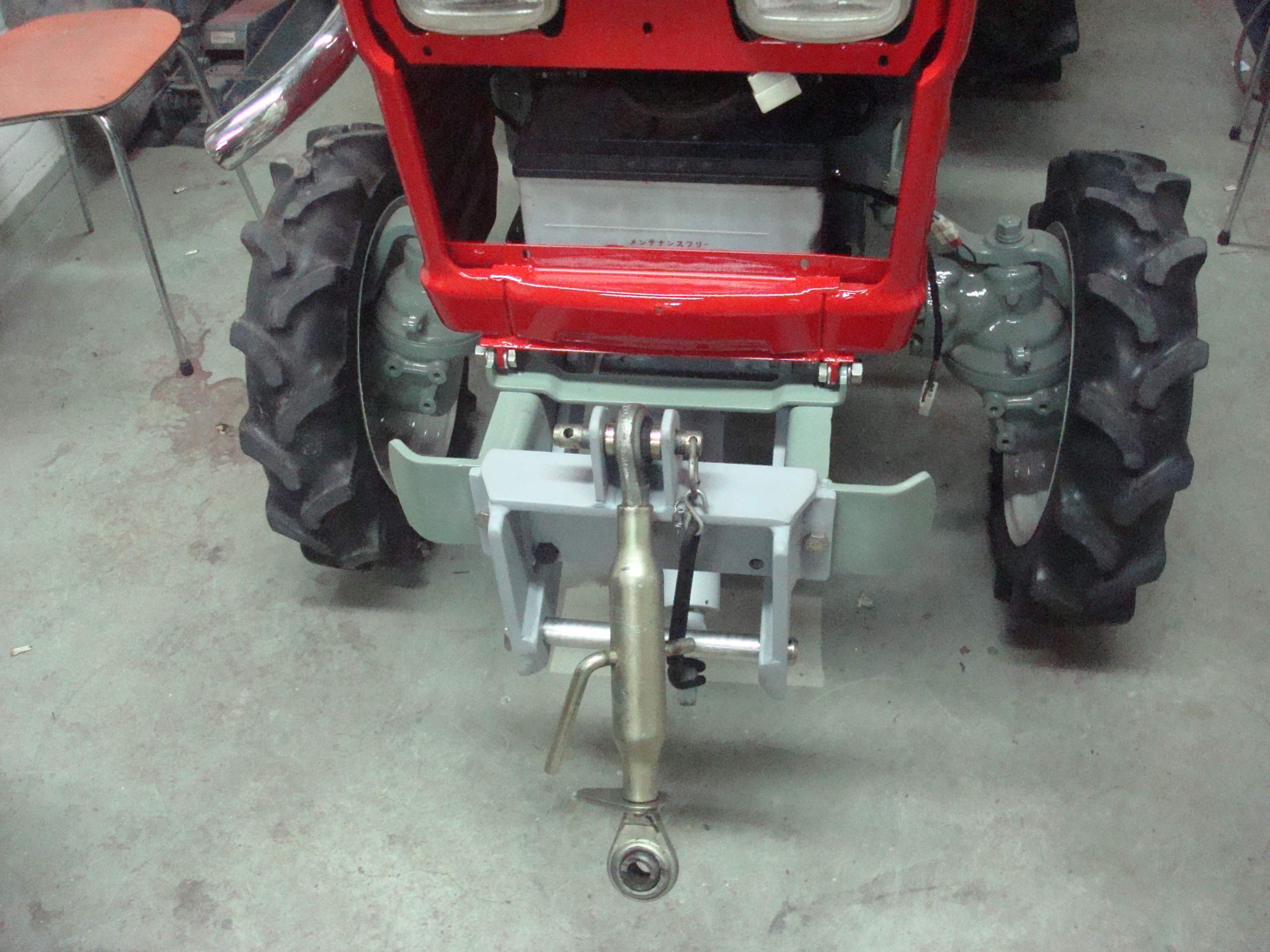

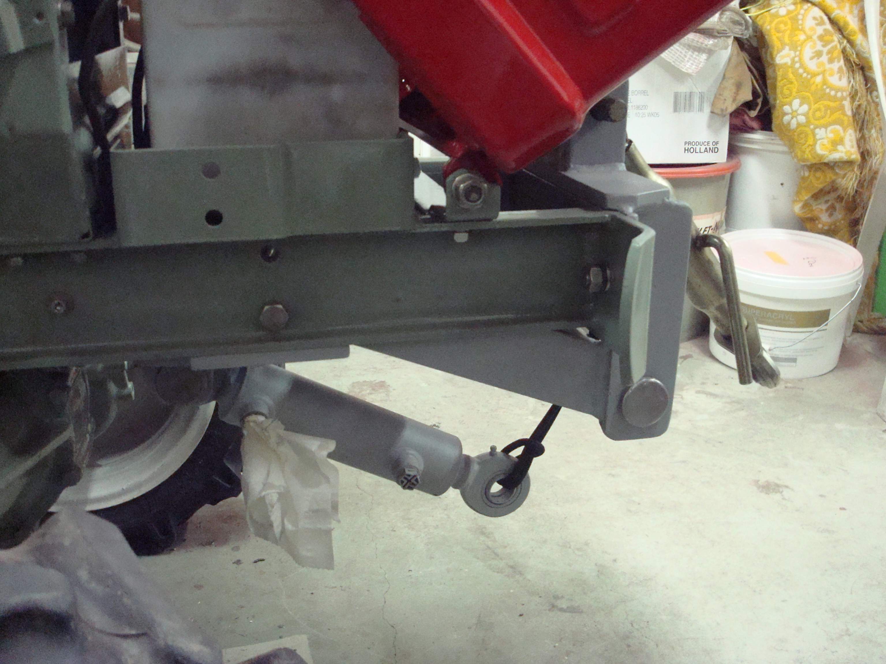

I hope i have gif pics zo you can make it yourself :thumbsup: :confused:
