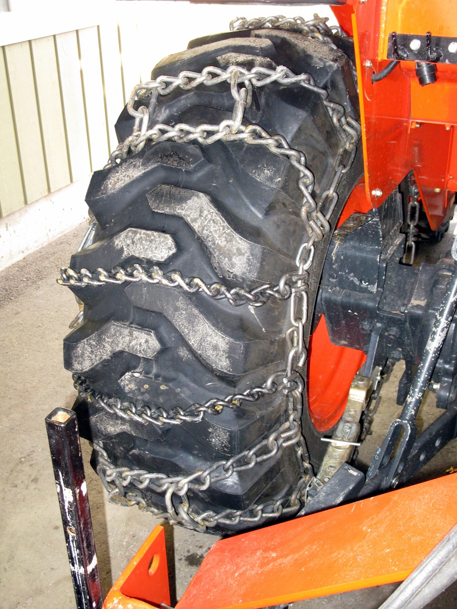

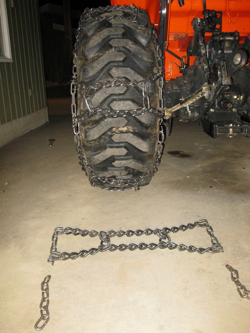

My DUO chains are very effective but can be improved. The gap between the patterns makes for a rougn ride and slippage, and I had to fill the large gap at the end with a couple of ladder cross chains. Each chain now has seven DUO patterns plus two added straight cross chains to fill the end gap.
Here is a photo of my existing chains plus one from a website:

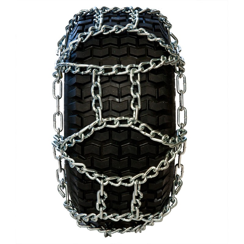

A standard option to fill the inter-pattern gap is to add straight cross chains, converting them to DUO-ladder style as shown here:

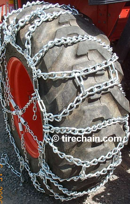

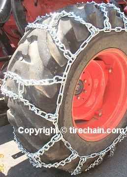

What may be more effective is to convert them a more dense H-pattern scheme similar to these two photos:
It would involve moving six of the patterns so they connect to the cross-hook of the previous pattern. It would free-up twelve sidelinks, making room for three additional DUO patterns. The chains would also be a bit higher on the side wall making room for one more pattern. So each chain would have 11 patterns instead of 7.
I checked with the local supplier where I bought the original chains. They have 125 bulk patterns of my chain in stock. The cost is $21.90 per pattern or $175.20 for the 8 patterns.
If I do it, this will be a spring project. I have chain pliers. At say, 5 minutes per crosshook and 84 crosshooks to open/close(4 per pattern, 22 patterns, and 4 hooks do not have to move), it would take 420 minutes (7 hours) to rebuild the chains. I'm retired and have the luxury of being able to do this over several nice days. So the labour isn't a concern.
I'm interested in hearing if others have built or used such a pattern, and opinions on whether or not it is a good idea.

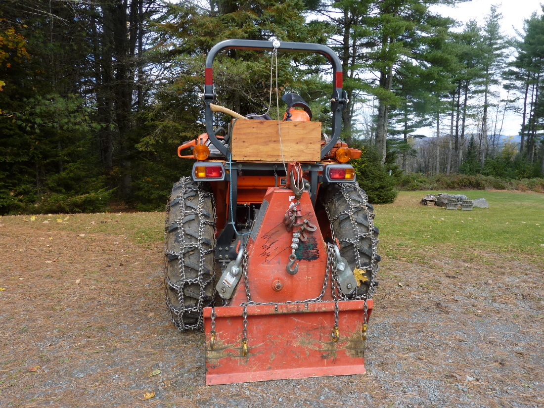

I use this H pattern and find it very good on my R1 tires
/ DUO Chains - planned modifications #3
That looks Excellent! my duo's help out alot, but they fall down in the deep R-1's so I know im not benefitting from them fully. I think this is going on my to do list! Did you get yours from tirechains.com?
/ DUO Chains - planned modifications #5
My Duo Chains work on my R4's but they leave a lot to be desired. I too want to add chain to mine. I think adding chain length wise, similar in idea to Gordon Gould's chains would work the best at keeping the chains from falling into the deep tire tread. You also wouldn't have to tear yours apart, you would simply be adding chain. I've been wanting to do this for several years now but haven't gotten around to doing it.

I got them locally from Western Equipment who build them from bulk cross-chain stock. I'm in Canada so ordering chains from the US is expensive. A popular supplier here is canadianchains.ca who sell Quality Chain Corp chains which are in the US and Canada. My local supplier uses Laclede chains which is a US company. The Quality Chain Corp and Laclede DUO patterns appear to be the same, so perhaps they are connected. My chains have the 13 link DUO236 cross-chain (see the attached catalogue page) which isn't even listed in the bulk continuous chain (the closest are 12 & 14 links).
Yes, those would work better. I'm not sure how one would connect the new length-wise pieces to the DUO cross chains, and it may be expensive. The Scandanavian manufacturers seem to use a pin coupler or chain extension similar to what is shown in this attachment.

WEll kco I took the plunge and ordered the extra 8 patterns as well as the chain tool. Sould be a fun little experience.

Yes, opening and reclosing all those links should provide hours of entertainment.
I ordered my patterns Monday (Jan 28) and they should be here next week. My (Vernon) supplier's tire chains are all built at their Prince George branch. Since I"m in no hurry they will ship them for free with other items to the local store.
I see in another tire chain thread your supplier questioned what we are planning. On the other hand, my supplier thinks it's a great idea. I promised to send him a photo when I'm done.
I'm sure these will work out well for both of us.

Yes, it is a pain modifying chains with a hammer and chisel. The few additions I made to my DUO's last year taught me that.
So this fall I bought a chain tool to build 2-link ladders for my front tires out of large 4-link ladders. They are old truck chains with 5/16" hooks. The large tool from my supplier was $63. A good deal--CanadianChains.ca lists them at $130 and TireChains.com at $90.
The chain tool makes it easy to open and close the cross-hooks. I even tested it on a couple of my DUO's 3/8" hooks last fall and they work fine. I just got back from opening a 3/8" cross-hook on my DUO's. Your post got me wondering if it really was that easy(it is).
I'll keep track of how long it takes to do the job and will post photos when done.

I think one needs one pattern for every two existing patterns. I have 7 patterns so theoretically need 3.5 patterns. However there's a sizeable end gap filled with two regular chains. The additional DUO patterns will move the side chains a bit higher on the tread, so there should be room for the 4th pattern. But it may require some non-standard modification. My biggest problem is a mere 1.5" inside clearance to the fender support--there's little room for extra hardware to make the inside connection.
From the Laclede catalogue it looks like your Deere 5083E's 16.9 x 30 AG's use a DUO271 chain with 10 patterns of DUO298(17 links, 31.55" long). If so, that would require 4.5 patterns per side? An idea may be to stick with the 4 per side and order others if required.
My supplier builds DUO chains from drums of bulk DUO patterns. My DUO's have 13 link, 25" crosschain patterns. They are the second set. He misjudged the first, building them with 15-link crosschains. The links joining each pattern's crosschains barely fit on the tread, and the inter-pattern gaps were much larger than the area covered with chain. Here's a photo:
He replaced those with my present 13-link chains. They are OK, but 12 links would have been better. The mistake is understandable. My supplier is in Prince George and I imagine most chains he makes are for large forestry, mining, and oilfield equipment.
Even CandianChains.ca(who use Quality Chain products) seems confused with 43x16-20 tires. Last year they switched from DUO239 with 7 patterns of 12-link crosschains to DUO242 with 9 patterns of 11-link crosschain(which did not agree with their new catalogue). This year they are back to DUO239 BUT using 10-link crosschains(DUO293). Ten links seems short, so I wonder if that is another error. Laclede on the other hand doesn't even specify a chain for 43x16-20's. TireChains.com no longer shows DUO's for my tires, but I think they did last year.
It's been interesting and I'm actually looking forward to messing with the chains. I'm sure the end result will be good. But if I were starting from scratch I would likely forgo the DUO's and use something similar to Gordon Gould's chains(post #2 in this thread).

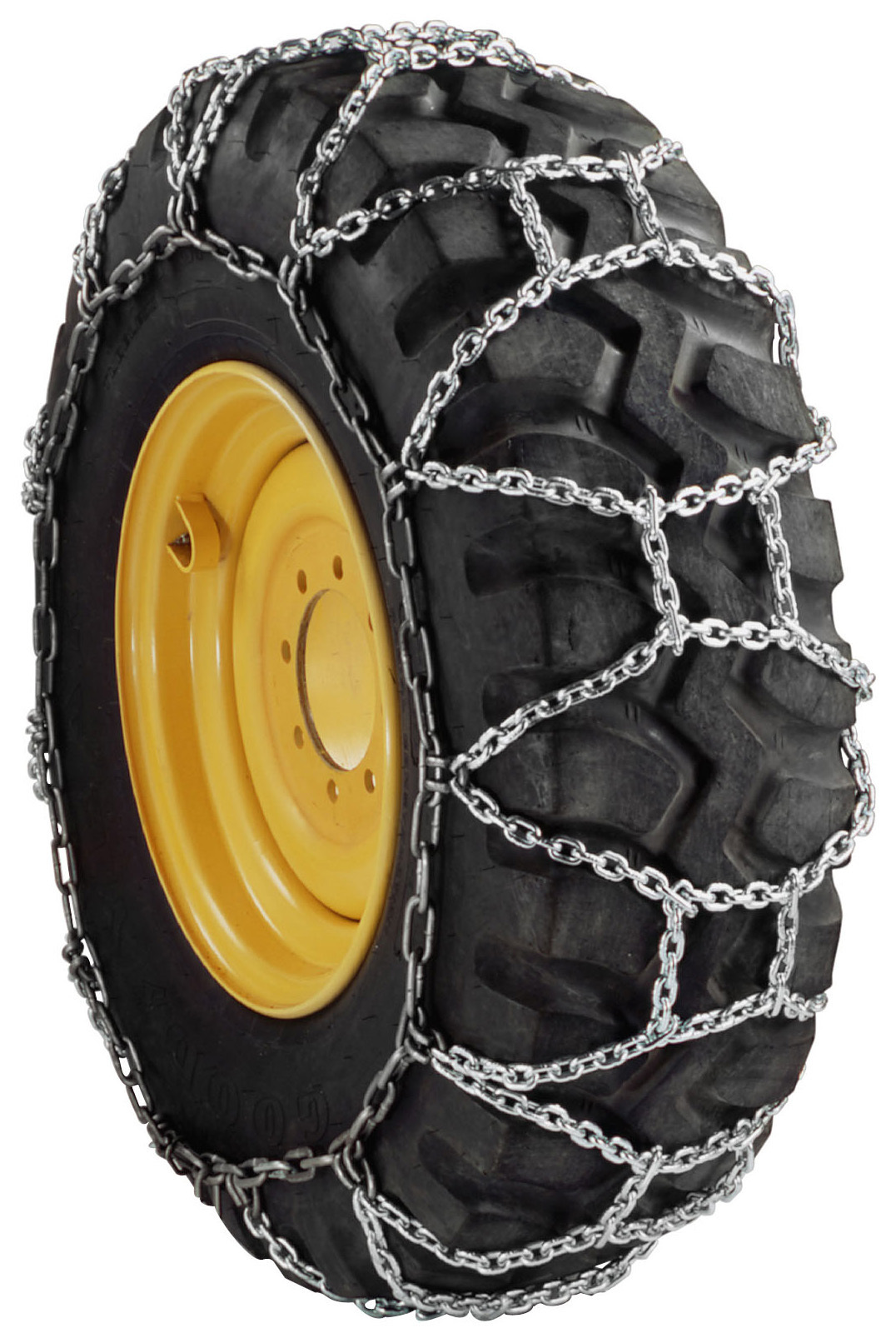

Regarding other styles--attached is a page from LongLife Chains catalogue showing a couple of interesting zig-zag patterns for truck chains.
The full Tellesfdal catalogue also has some interesting designs.
  • TruckChains_p8.pdf
