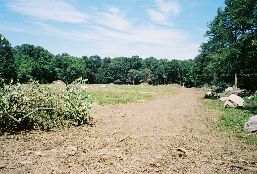

PAexcavator - Thank you the message. I had not thought about the dead weight but maneuverability on my logging roads with the overall length was a concern I had for a trailer. At this point I will be renting an F650 with a 10ft dump to see how much hauling I can get done over a weekend. That should give me an idea on whether the bed should be larger for volume reasons. Right now my estimation is that a 12ft bed is in the right ballpark with 24inch sides. My bio-matter cleared field is attached. I still have larger stones to remove.
