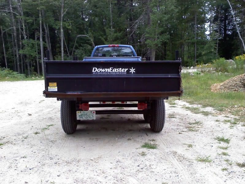

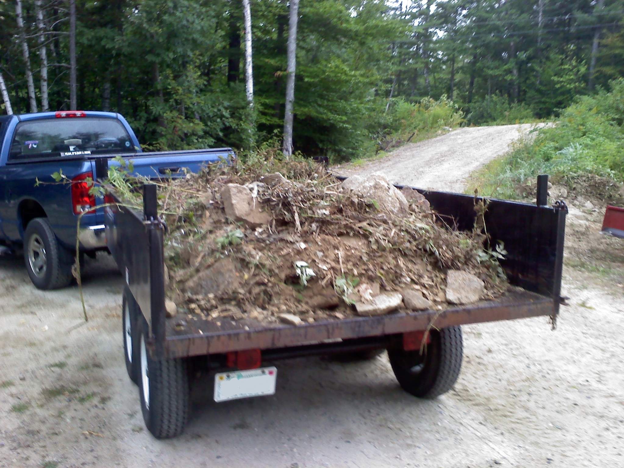

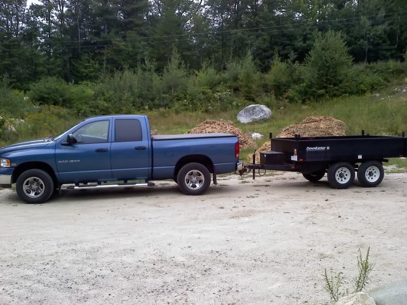

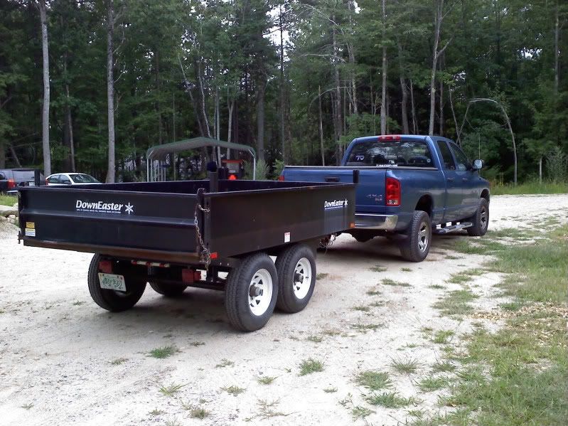

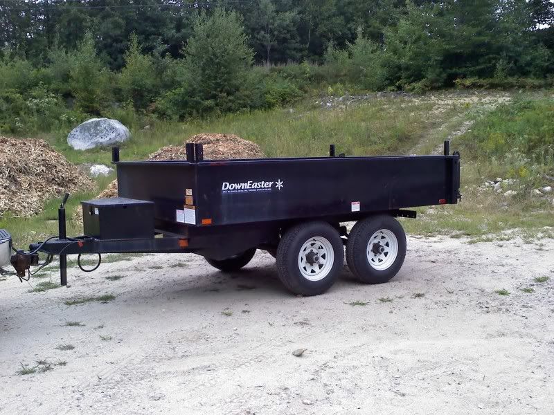

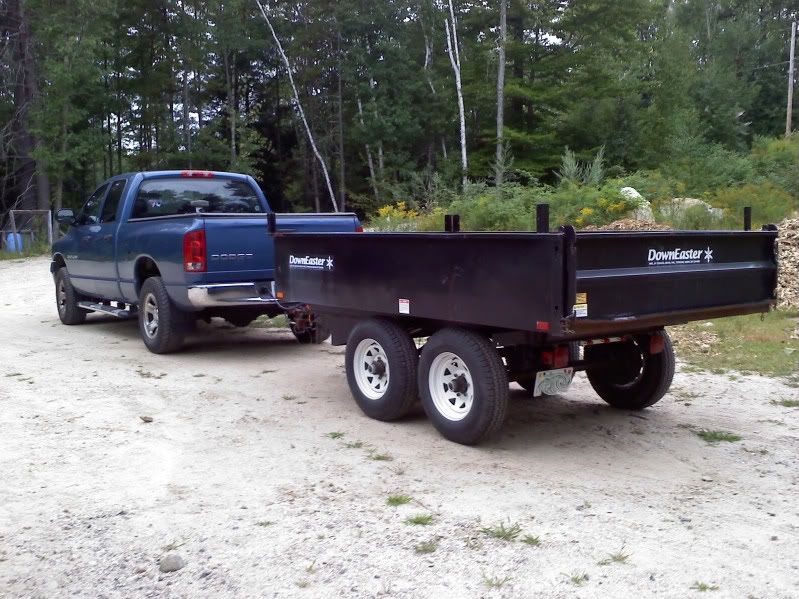

Personally, I'm not a fan of scissor-type lifts. I've had them on trailers and dump trucks and find they are slower, bind up with use, add weight and cost more. I like a plain and simple straight piston or dual piston setup. My 10k DownEaster dump trailer has yet to not lift a load as long as the batery is charged and my heighest scaled load was 6500lbs of crushed gravel. One piston right in the middle with two grease zerks, plain and simple.
