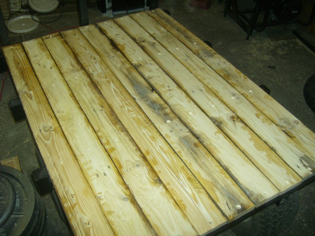

More Progress. I set up the deck and got the holes drilled. It's too cold to varnish right now, but I may sneak home for lunch and put a coat on.

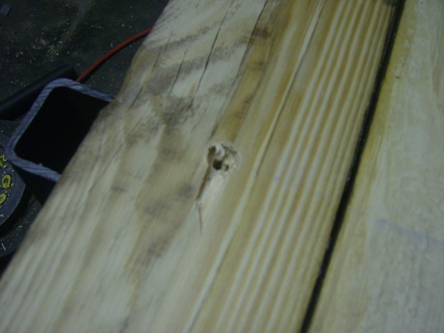

When I was counter sinking the bolts, I tore up a few of the boards. The combination of the wood, the bit and the drill that I was using to counter sink would grab at the wood, and I lifted the top grain up to a few inches away from some of the holes. I'm sure a few weeks of use will even everything out, though.

I came home for lunch to varnish the deck. The temperature outside is registering at 45 degrees. I don't have many other options, and the weather is likely not going to get much warmer for a while, so I'm hanging a heat lamp over the deck and hoping for the best.

IPLAYFARMER, Bondo or other catalyzed filler is perfectly good for use on wood and is sold at the big box stores for that purpose. You can fill your tearouts with that and it will slow/stop rot as it will prevent moisture or wet material from accumulating in the tearouts.
Pat.

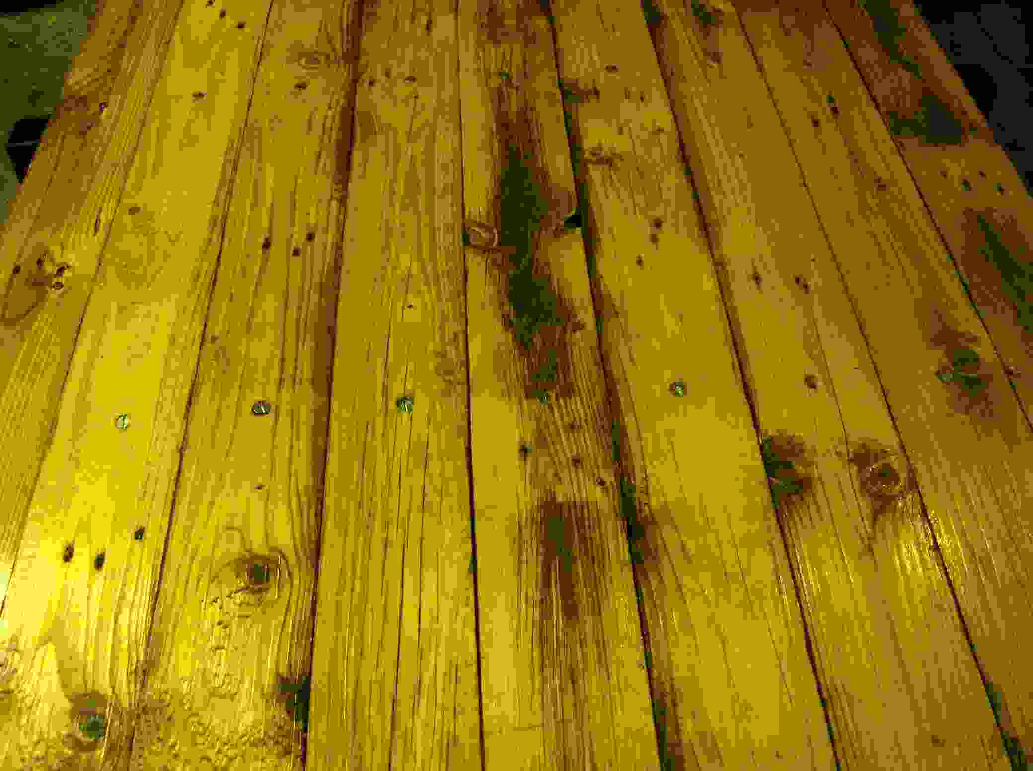

Our pretty significant snow came as forecast...
The snow was wet and heavy. With leaves still on the trees, the branches couldn't handle the weight. We had branches down all over the place. The power was out for about 7 hours.
I did get a little more done on the trailer, though. I installed all the bolts in the deck.
