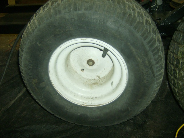

I think I know what they look like, but just in case I am wrong, can you post a picture of then side of the wheels on the trailer, as to how they are held onto the axle. (bolt pattern, E-clip, etc)
David from jax
   / Dump Trailer
#212
sandman2234 said:
Iplayfarmer,
David from jax
Sure. Why?
In the first picture if you squint you can see the flat top and bottom of the bolt as it comes through the matching hole in the wheel. This is how the axle turns the wheel (or in my case now how the wheel turns the axle).
The second picture shows how a single bolt holds the wheel to the axle.
I actually tried taking the wheels off before I switched axles and None of the six wheels I had to work with would even budge. They're on there pretty good.

I was hoping that your axles had bolt patterns, instead of the E-clips. I am going to be building a pair of axles for my buddies mini dump trailer, and thought I might build four instead of two. However, adding the costs of the hubs and rims and tires, plus freight, it gets kind of expensive to change out an set of axles that there is nothing wrong with. I was just thinking that I could make you a set that would last that would still match your existing rims. Thanks for taking the time and effort to satisfy my curiousity.

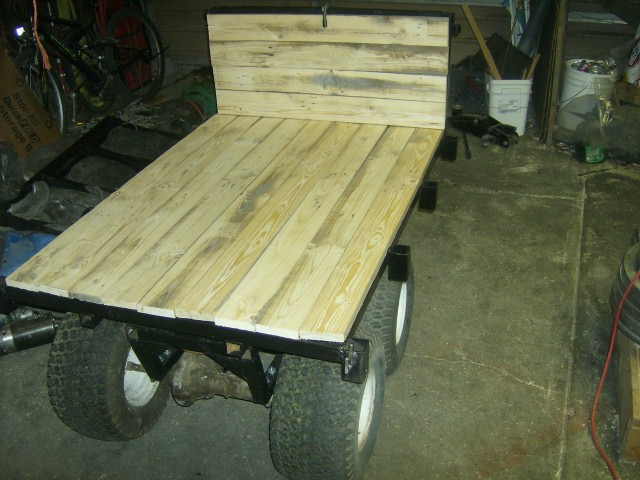

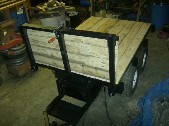

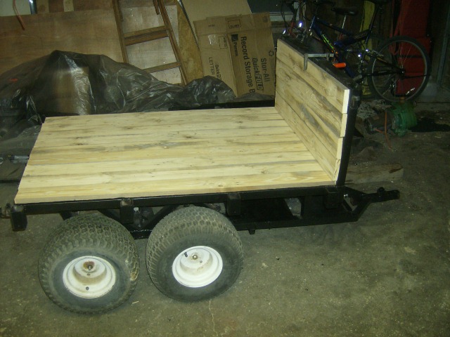

I made some more progress today. I've attached a few pictures of the decking I did today.
Pic 1 shows that the wood all started as a crate. (I'd posted this pic before, but it's relevant here again.)
Pics 2 through 4 show some different shots of the decking and the front.
I've got some more wood prepared to plane down and cut out for the sides and the back, but that will have to wait until next time.
I'm having a hard time deciding whether to paint the wood black to match the rest of the trailer or to leave it natural with some kind of varnish on it. Any input here would be welcome.
