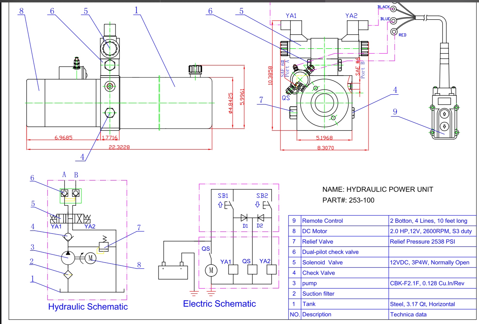

A dump trailer we use to haul muck was being lowered after dumping a load when the bed suddenly dropped about 3 feet. Nice bang, and oil all over the place! I wasn't there so I don't have first hand observation of the failure. Person who was there says there's no more to know than bang and splash.
Preliminary inspection is that the plastic reservoir is ruptured - large split all the way down one side, and, of course oil all over the place in the pump box. I think reservoir is vented, so the build must have been very fast.
The "obvious" resolution is that I need a new reservoir (and believe it or not, the first answer I got from the manufacturers parts department).
However, I got to thinking about this, and I think there's more going on - like something else failed, causing pressure to build to high levels quickly in the reservoir, causing it to rupture. Feels to me like a check valve/flow control in the pump gave way. Could we have lost a seal in a cylinder that back-fed pressure (pressure from gravity on the bed) to the lift side of the pump? If this is true, a new reservoir will fail in a similar way.
These trailers are a little strange to me - they are pressure up, gravity down. But the pump controls the down speed and has to move fluid to fill the back side of the cylinder - the reservoir is engineered so that it does not hold lots of fluid, only the difference between one side of the cylinder and the other (the rod).
Parts guy is doing some investigation, but I thought I would run this by the forum.

If it's "gravity down" is there really fluid on the back side of the cylinder or just vented? How many hydraulics lines go to cylinder?
If just one, I'd guess cylinder is ok, but whatever restricts flow to reservoir or a valve that is suppose to block pump pressure to reservoir has failed.
If it is a double acting (2 hose connections) cylinder, (not strictly gravity down), then maybe losing a seal in cylinder could pressurize tank....but I don't fully understand how.

There were separate valves to opposite sides of the cylinder, one opens the other does not, I don’t think that’s the case...but one path could still be blocked.
The weight (gravity) pushing the oil out of the cylinder can overcome the vacuum being created on the other side of the ram because no fluid can enter.
I don’t know OP’s unit, but my thinking is based on a typical like in the following. Unit goes up when path is though “YA1”, goes down when path switches direction through “YA2”, and hold when there’s no path like shown.

A lift system like this should only need a regular spool valve; when it's in the raise position it activates a switch that turns on the hydraulic pump, when it's in the lower position gravity does the work, just like a fel or forklift with the engine off. The top of the cylinder is usually vented with a sintered bronze fitting, or a vent hose.
If it has solenoid valves, like some kind of Bobcat hand control system, it would need some kind of electronic control to feather the inputs, and even so, a full scale downward deployment should be well within the engineered specs.
