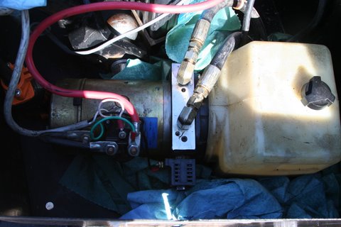

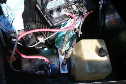

How about some pictures of the cylinder, and the solenoid set up?
The shaft end hose is probably just hooked up, but gong nowhere , maybe has a filter on the end of the hose.
They make a kit for double acting pump. maybe something got mixed up some whee.

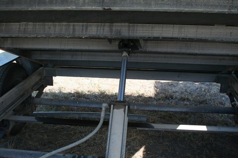

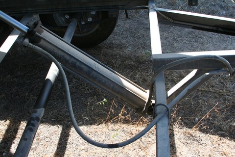

Here you go. I think the hose on the bottom of the picture is the pressure and the top hose is the vent. BTW, the oil in the picture on the frame and cylinder is from me oiling the cylinder and end bearings and pins. There are no leaks.

When you disconnected both hoses did you get any fluid out of the pressure hose? With both hoses disconnected the box should have dropped very fast. If this doesn't happen the next test should be disconnect the vent hose at the cylinder when the box is PART of the way up. BEFORE YOU DISCONNECT THE HOSE PUT A 2/4 OR STEEL PIPE SO THE BOX DOESN'T DROP ON YOU. After removing hose then raise box up and remove the pipe or 2/4 and see how fast it drops. if it drops fast then the vent hose might have a plug or trash in it. You might also want to check the fitting I know that sometimes the teflon tape they put on the fitting wads up and can plug the fitting or hose.

Let me guess at this. I would say a bent shaft, and its cocking the piston and binding on the end cap. with that cyl all the way out it wouldn't take a lot to bend it. Get the cyl out and see if it goes in and out by hand, if not take it apart and have a look. what size is the shaft? Maybe they just put the wrong cyls under the trailers and that is why the other guy has the same trouble.
/ Dump Trailer Problem #15
My totally un-educated guess is that they used a double-acting cylinder in a single action application! That ram sure looks like it's got pressure ports on both ends. What they've done would work fine, as long as the upper void stayed clean and somewhat lubed! I'll bet that there's 'junk/rust/plugged-vent/condensation' or all the above in the upper void that the rod retracts into. I'd be disconnecting the ram to the workbench, and cleaning up everything. I might even pressurize the upper port, and 'power-retract' that rod by "bumping" the pump switch. If it retracts, a few cycles, might get you back in business! As always, be careful of pressurized lines and ports! ~Scotty

The theory behind a single-acting ram is simple. Your pump only has to pressurize the lower/base cavity, to apply pressure to the piston and seals, to raise the trailer bed. Unlike a double acting cylinder, that you would reverse the fluid flow to the rod end, for retraction, it simply relies on the weight of the trailer bed to force it back down. Now, 'enter the second hose'! Typically a SA ram will only have a vent at the top to allow the air to exit the top cavity during the pressurized extention cycle, and, allow the air back in the ram during the 'gravity' return. Since your is plumbed from both fittings, I suspect that the top line from the rod end is just plumbed back to the resevior, (There must be a vent on the pump/resevoir) Thus, when working properly, the gravity compression of the cylinder during lowering, would suck fluid out of the resevoir, slowing the desent, and lubing the upper chamber. (Probably a good thing!) Since you detached the hoses at the pump unit with no further luck, I suspect that there is a restriction in one or both of the hoses, or as prevoiusly mentioned a mechanical flaw/bent-rod etc. I'd remove the hoses at the cylinder, and see if you can move the ram. Note the above safety warnings about blocking! Don't crush yourself! We all want to know how this turns out!! :D
