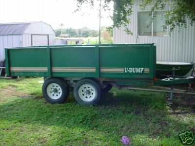

I just bought the dump trailer pictured in the atttachment on EBay for $1,800. Better yet, it's located about 60 miles from my property, so I can easily pick it up.
It's 6' x 12', rated at 12,000# GVW, has self contained electro-hydraulic dump, brakes work, tires are OK. The floor of the bed is rusted at one end but I can weld in a patch.
I can pull it with my tractor on site, and I can pull it with my Dakota when loaded up to about 2,500# (5,000# total), which means I can use it to haul stuff to the landfill or transport my tractor, but I won't be able to use it to haul full loads of shell rock or fill until I get a bigger truck. Off to look at trucks.

   / dump trailer pricing #26
I don't know Don......
You think that nice <font color="blue"> BLUE </font> tractor is going to like being in that big <font color="green"> GREEN </font> trailer?? /forums/images/graemlins/shocked.gif
You might want to paint that trailer to keep peace in the family! /forums/images/graemlins/ooo.gif /forums/images/graemlins/smile.gif
   / dump trailer pricing #27
Don,
Good deal. A new one, is at least 4-5K.
I have used a similar U-Dump and liked it, except the bifold rear gate.
Be careful with that trailer when its full and that TC18. My TN70 slows down a bit going up a steep hill with a full dump trailer in tow and its alot heavier.
