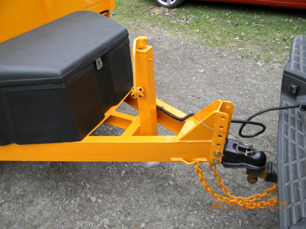

I've been looking at dump trailers in the 14k GVW range and figure that I'll need a load equalizer type hitch for it. I have a Reese Equalizer for my RV trailer (11,000 # GVW) which works well and plan to use it for the dump trailer as well. However, the I-Beam type trailer does not accommodate the snap-up bracket. Welding in a plate to box the beam is an option, but the I-beam is 4" wide and the snap-up bracket only accommodates 2-3/4" wide frame. Even the square tube trailers are to wide. So, how do you put a snap-up bracket on your trailer tongue? Is there a particular brand that works?

Check a different brand of dump trailer. I have a 16' 14K dump trailer. The tongue is 2"x5" C-Channel. Main frame is combination of 2"x8" box tube and 2 1/2"x8" C-Channel. Tongue takes my standard WD snap up brackets. Never seen a trailer with 4" wide I beam.

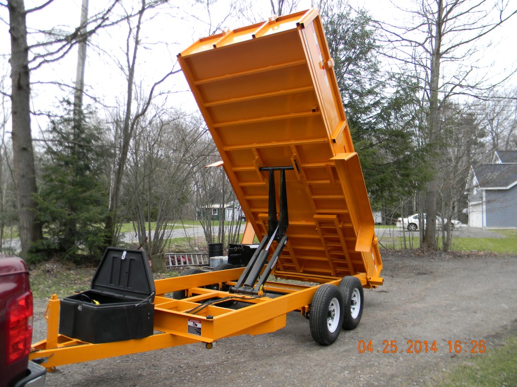

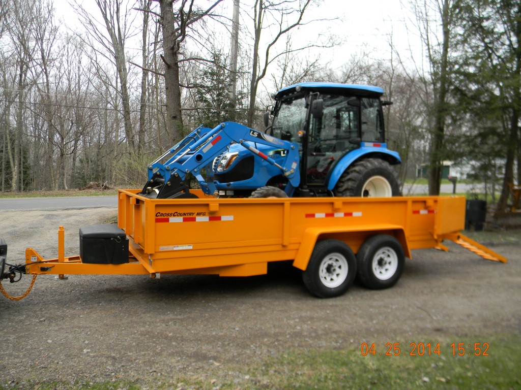

My trailer is built by Cross Country Mfg. here in NY. Also a single cylinder. DSCN1122 (Medium).JPGDSCN1124 (Medium).JPGDSCN1129 (Medium).JPG
Pics do not show my WD hitch brackets as they were taken the day I brought it home.
