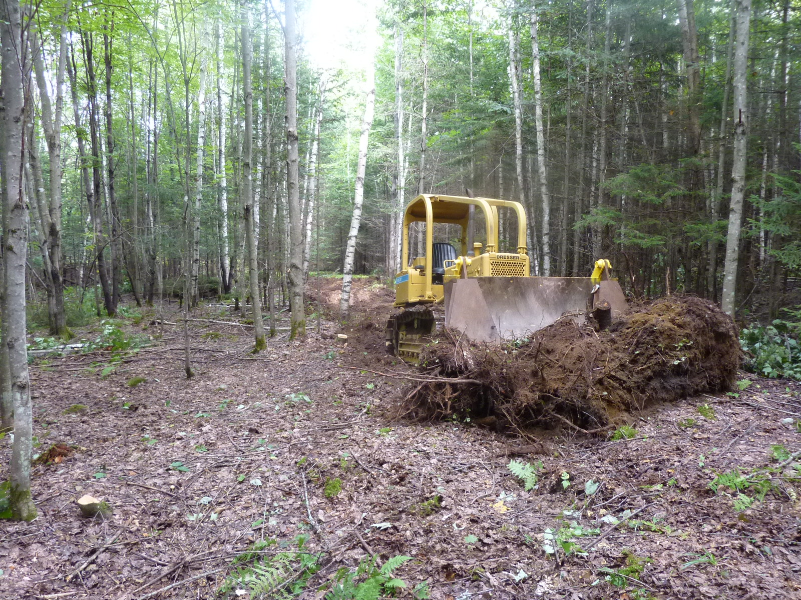

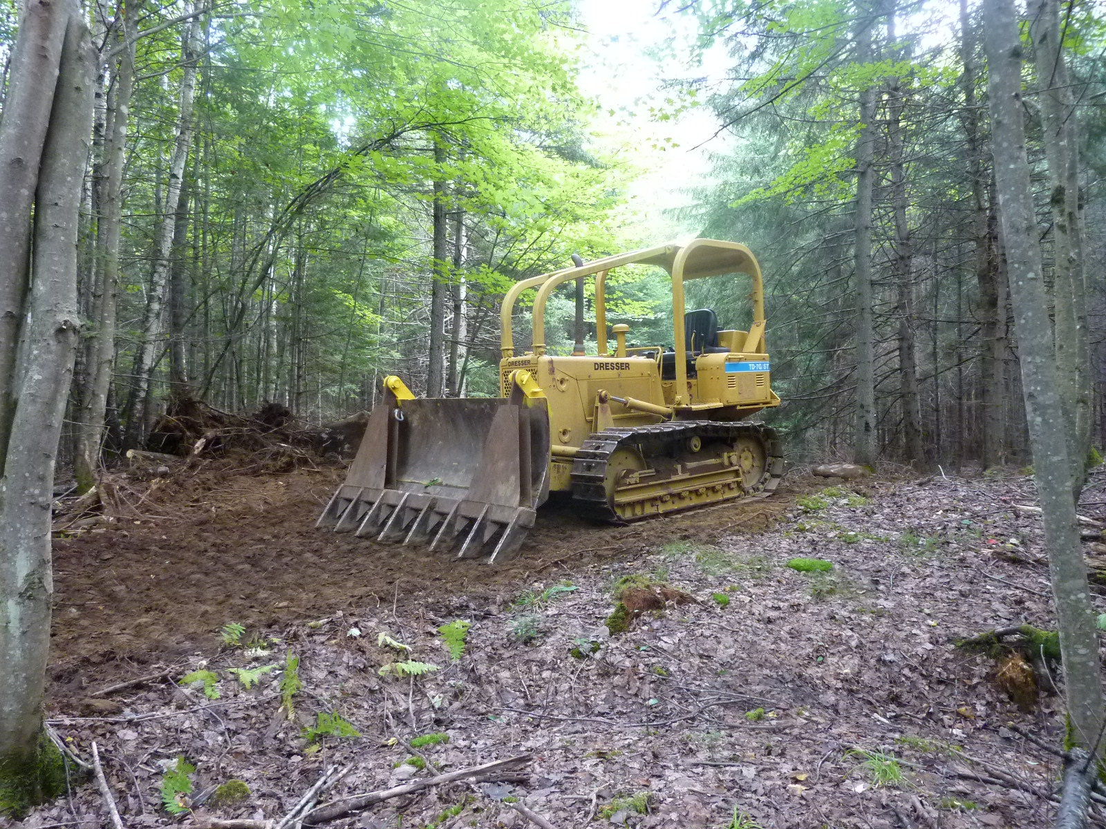

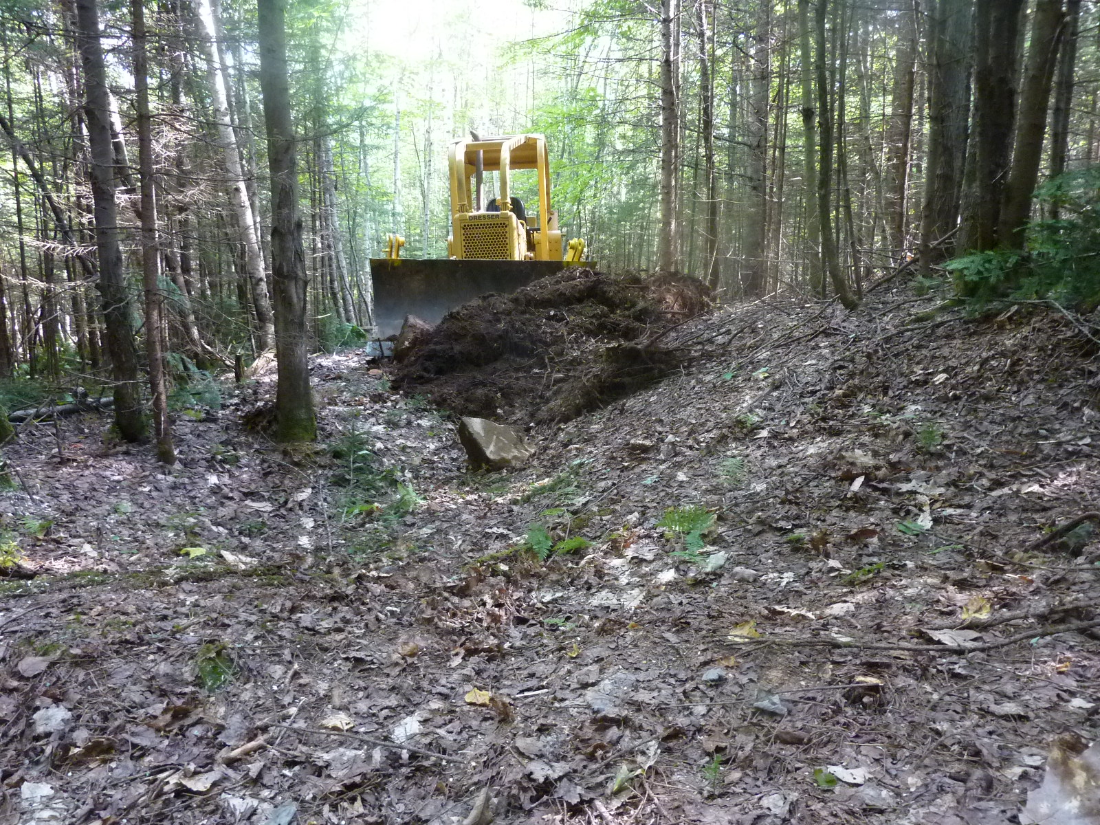

Pics of the Dresser would be nice.

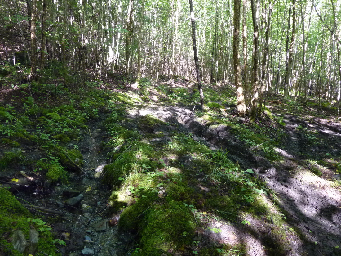

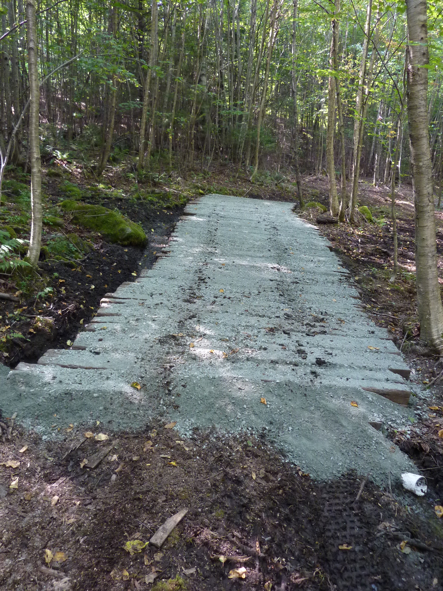

I have tried all kinds of things. Road base works best because it packs together and acts like a solid piece if you don't use the road when it is real wet like spring mud season. Straight rock lasts for a while but slowly migrates into the mud and disappears. In my mind a $25 load of road base makes more sense for fixing a single mud hole like that than making a corduroy road. They are a ton of work. Maybe I am just lazy. I have done it both ways and like gravel. The easiest way for corduroy was to go to the saw mill and get some edge slabs but they chip everything now and slabs aren't available. I put this one in about 10 years ago with old RR ties that were free. It has lasted very well.
This was when it was dry
When I finished

That road base/gravel looks like crushed rock. Around here I seen some loggers use railroad ties for temp use, they put it down and take it back up with a big pulp loader, on fields, power lines.....
