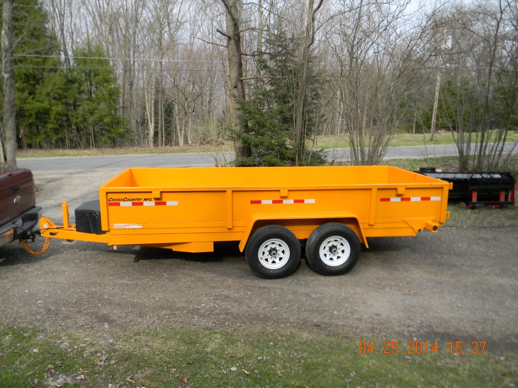

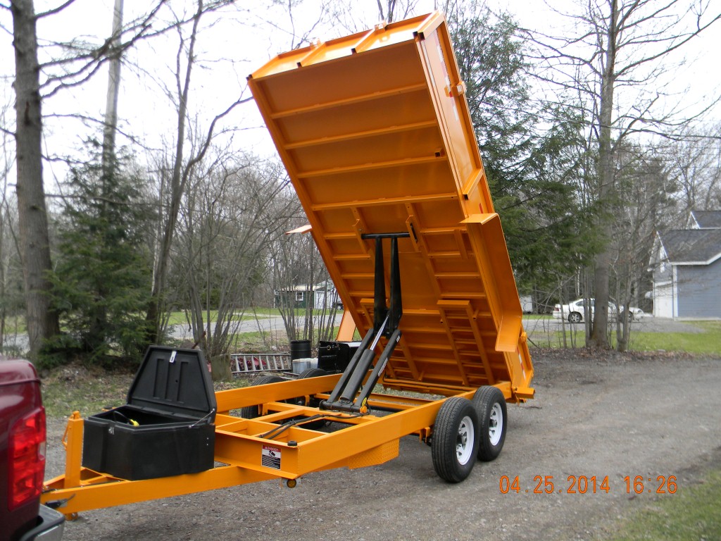

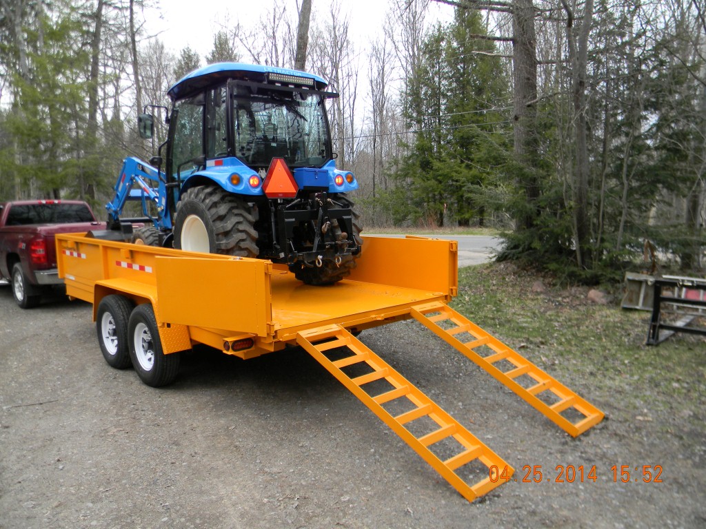

I have a 16' Cross Country Dump trailer. Its a bumper pull rated for 13,800 (10K load). Tows great with my 2016 2500HD and 2 5/16" ball.
Re: the one you rented, you may want to check your trailer plug on the truck. When its plugged in your truck should recharge the trailer battery. If it went dead after 5 dumps its not charging.
Mine has the single cylinder and does strain with a full load as Tyler mentioned.

Do you have support to put under those ramps when loading/unloading?
I sure do hope so.
   / Dump trailer blues... sometimes a lot is just too much. #8
I sure do hope so.
Ramps are rated for 5000 lb. each according to mfg. Tractor weighs 5600. Driving tractor up ramps raises the truck a little but not off the ground. Truck and trailer were on level ground and wheels blocked. The pic of the tractor on the trailer is only to show it can be used that way. Bed has 6 D-rings for tie down points.
I don't use the dump trailer to haul the tractor. I use a 22' 14K PJ TL tilt bed for the tractor or other vehicles.

That's a good looking trailer. The workmanship looks much nicer than my PJ.
   / Dump trailer blues... sometimes a lot is just too much. #10
Yes it is well built. The Mfg. is here in NY about 75 miles south from me. Mine was a special order. Standard lengths are 10,12, and 14'. Mine is 16' and 80" wide. Has D ring tie downs, slide in HD ramps, LED lighting, 12K jack. Came with wired remote for up / down and I added a wireless remote.
Not sure what model PJ you have but my PJ seems to be built with the same quality. Dump trailer is rated for 13,800 and PJ is 14K.
