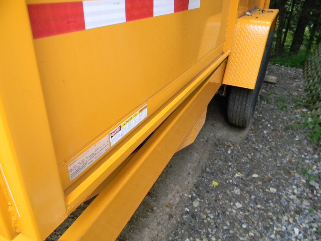

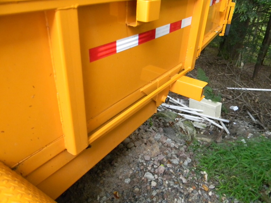

I welded 1/2" angle on my dump trailer to attach the bungees to. It was cheaper than 1x1 tubing then adding hooks.
I agree to wire in a hidden switch. I think you bought the power up and gravity down pump so you only need to wire the hidden switch in series with the small wire on the solenoid. I guess from you asking this question you didn't mount the new pump in a locking box on the tongue. That would have solved that problem.
I had recently built a spare tire holder in that location. So I did not have room for this. I wish I had the room now because I would like to have a box for my tarp and bungees

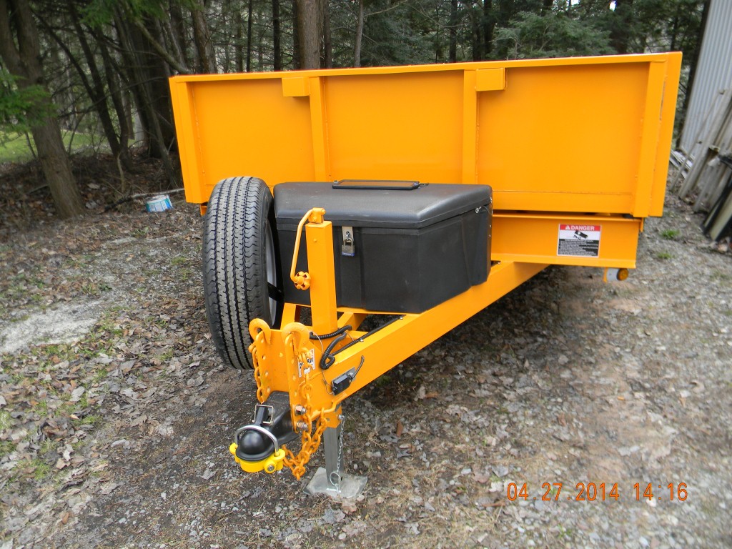

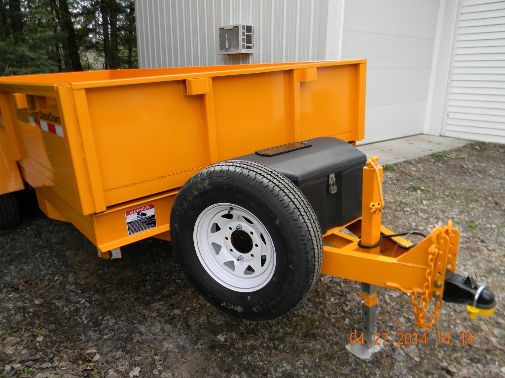

Move your spare tire to the right side of the tongue. I had just enough room to mount the spare behind my weight distribution clamps (not installed at time of pic).

The spare tire could also be mounted onto the box. Either the front or the side. As with anything there are pro's and con's.
Is that a solar battery maintainer on top of the tool box?
