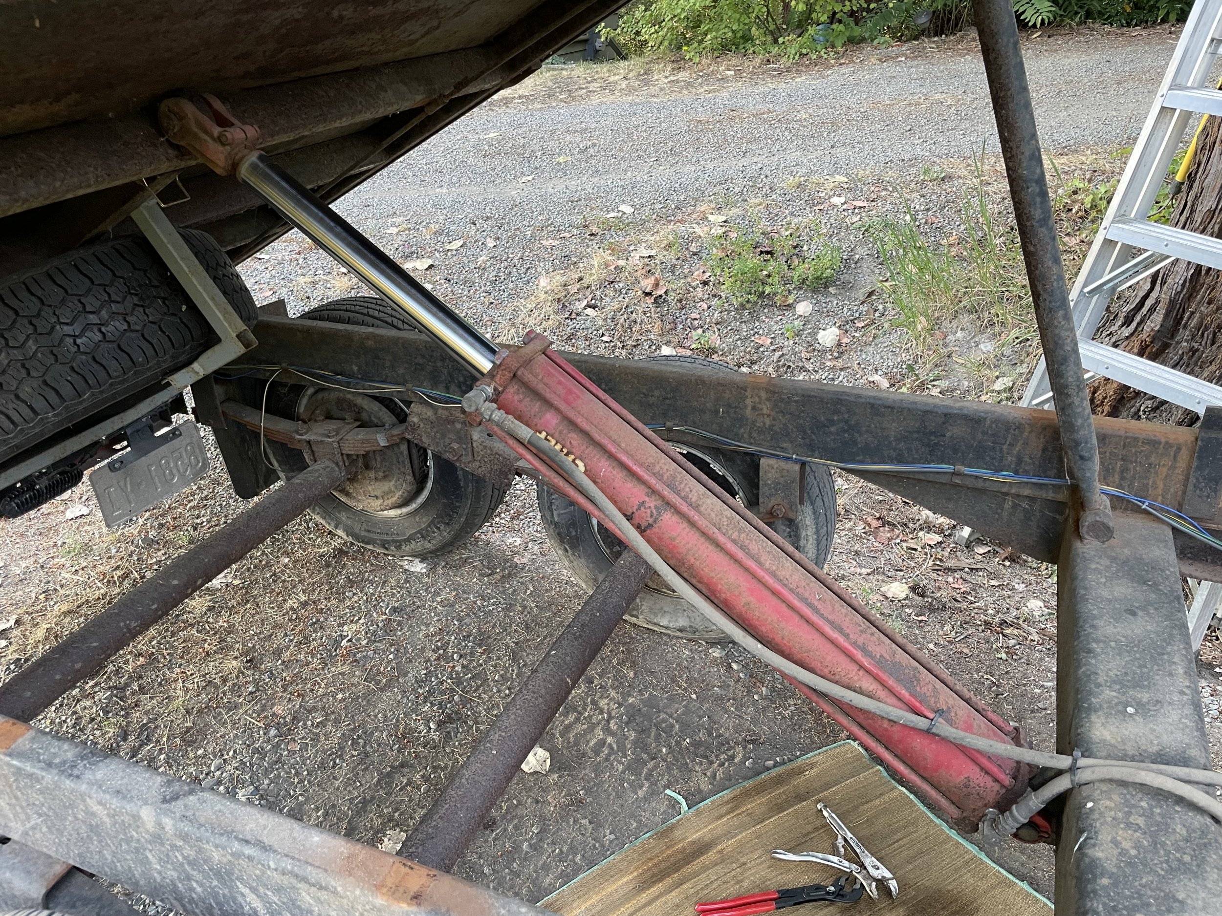

I blocked it up like this. It's heavy, full of dirt. I have the mfr-provided prop in, but since the bed is full, it's near the balance point.
I was feared it could tip up off the prop, and then maybe slam down. Probably not, the dirt would slide and it would stay up.
Even so.... I blocked it with a 4x6 on the other side, and chained it down onto the two props with a chain binder.
Watching the motion with the bed immobilized, I think it might be a problem with the valve.
Could it be a solenoid operated spool valve?
Could the hydraulic pressure be moving the valve against it's electrical solenoid force?
Closing the valve a little and thus setting the oscillation in motion?
   / Dump trailer bounces on the way down (if coming down heavy) #35
Yes valves can be overcome by flow forces. I suspect there is also some form of speed control - flow restrictor in that unit to try and control - limit dump speed when loaded. If not the drop speed would change significantly between empty and loaded.

I bought it used in 2018 (mfrd 1998). It has chattered since 2018 (only coming down heavy). It doesn’t appear to have much use, no dents in the bed etc.
Here’s a video of the behavior.

Having seen that video, and knowing next to nothing about hydraulics...
Strongest suspicion for me is the solenoid. It sounds like the pump has consistent power, so the "down" switch should be ok (I'd still double-check it by using wires to jump around it and actuate the "down" circuit; verify that there's no fizzing going across the switch).
You're certain that you only have the one solenoid? A trace of electric wires should verify.
How much for a new solenoid? Probably wouldn't hurt much to swap it just to be certain it's not the problem.
   / Dump trailer bounces on the way down (if coming down heavy) #40
Sodo
Not sure on how your dump trailer is supposed to operate but can you get access to take pictures of power from different sides. Also would suspect valves are either bolted to or part of the housing between the motor and reservoir. At least that is how most of the ones I have seen are made. Would expect there to be a start solenoid for the motor and also at least one coil or solenoid operating a valve or valves. These pictures might help us trouble shoot this system with you.
Should also be a system relief in this block.
Does the load drift down if you leave it raised for any period of time?
