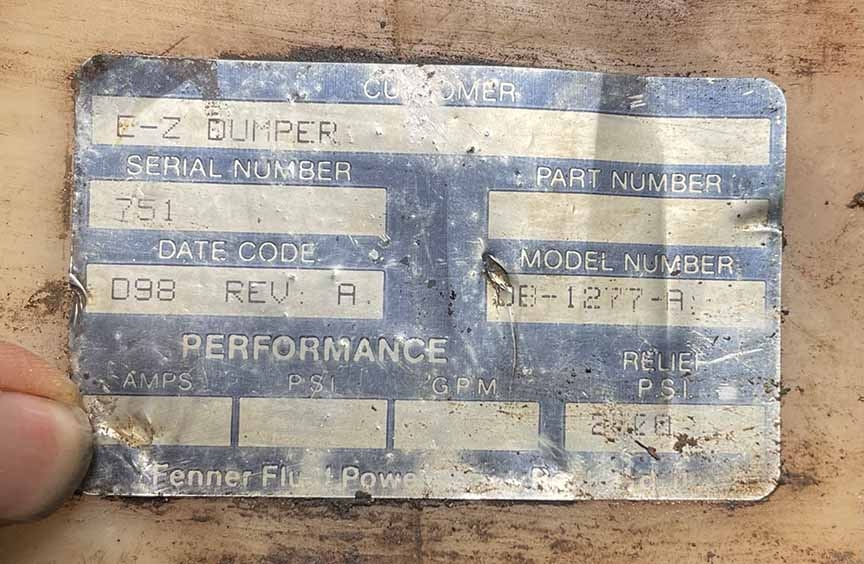

Searching the DB-1277-A returns only a "new model" that has the same partnumber. The new model is clearly a different pump.
I have never changed the hydr oil, I bet it's the original 1998 oil.
I don't think it had a hard life, I think it was used by a wood-floor company to dump tearout wood floors. It doesn't have any dents. But I will definitely change the hydr oil!

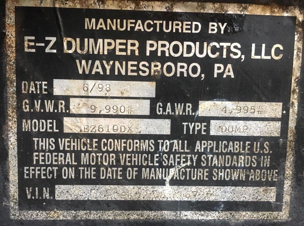

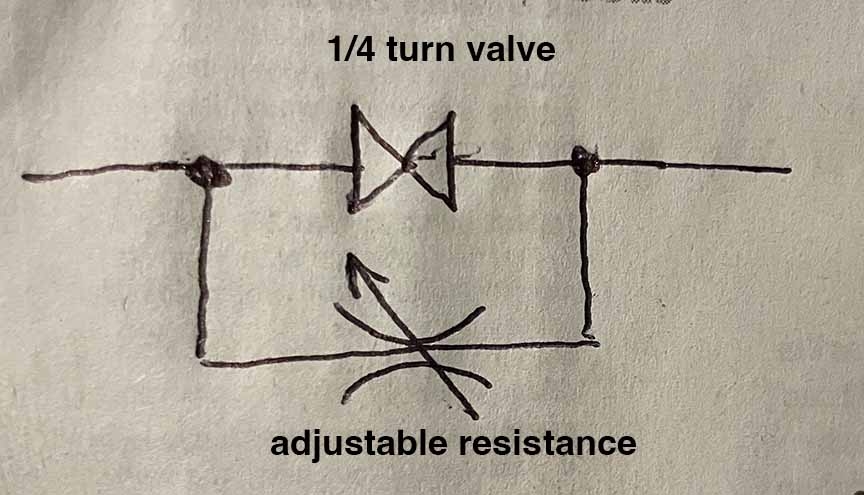

If power down suspect there could be Pilot operated check in the load holding circuit. There is some load induced pressure so you need xx amount of pilot pressure to open the check. Then gravity takes over and load starts to run away so pilot pressure is lost and check slams closed. Then cycle repeats.
Putting a flow restrictor will help when loaded but could potentially slow down dropping an empty bed.
oldnslo this explanation makes sense.
I should probably call EZ-Dumper first before calling the pump mfr.
How likely would positioning the cylinder such that cycling it would eject an air..... be the easiest solution? I can go under the trailer and do that if the pins coooperate.
What about adding a bypass circuit that has a restrictor, with a valve.
In normal conditions the valve is open and it runs fast / normal.
So I'd never close the valve except if I know it's gonna chatter.
But on those few conditions while heavy I close the valve and it restricts and of course lowers slowly.
This would be placed in the pressure side of the power-down, right?
