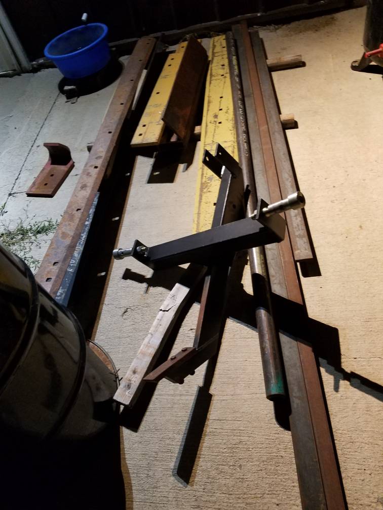

And you just drop the 3pt. The angled foot on the bottom pulls it down as far as you lower the 3pt.
Found a photo of mine laying around. Haven't used it much recently. But at under $200 new its not worth selling. I "plowed" 3 of my 5 acres with mine before hitting it with the rototiller. Worked well.
