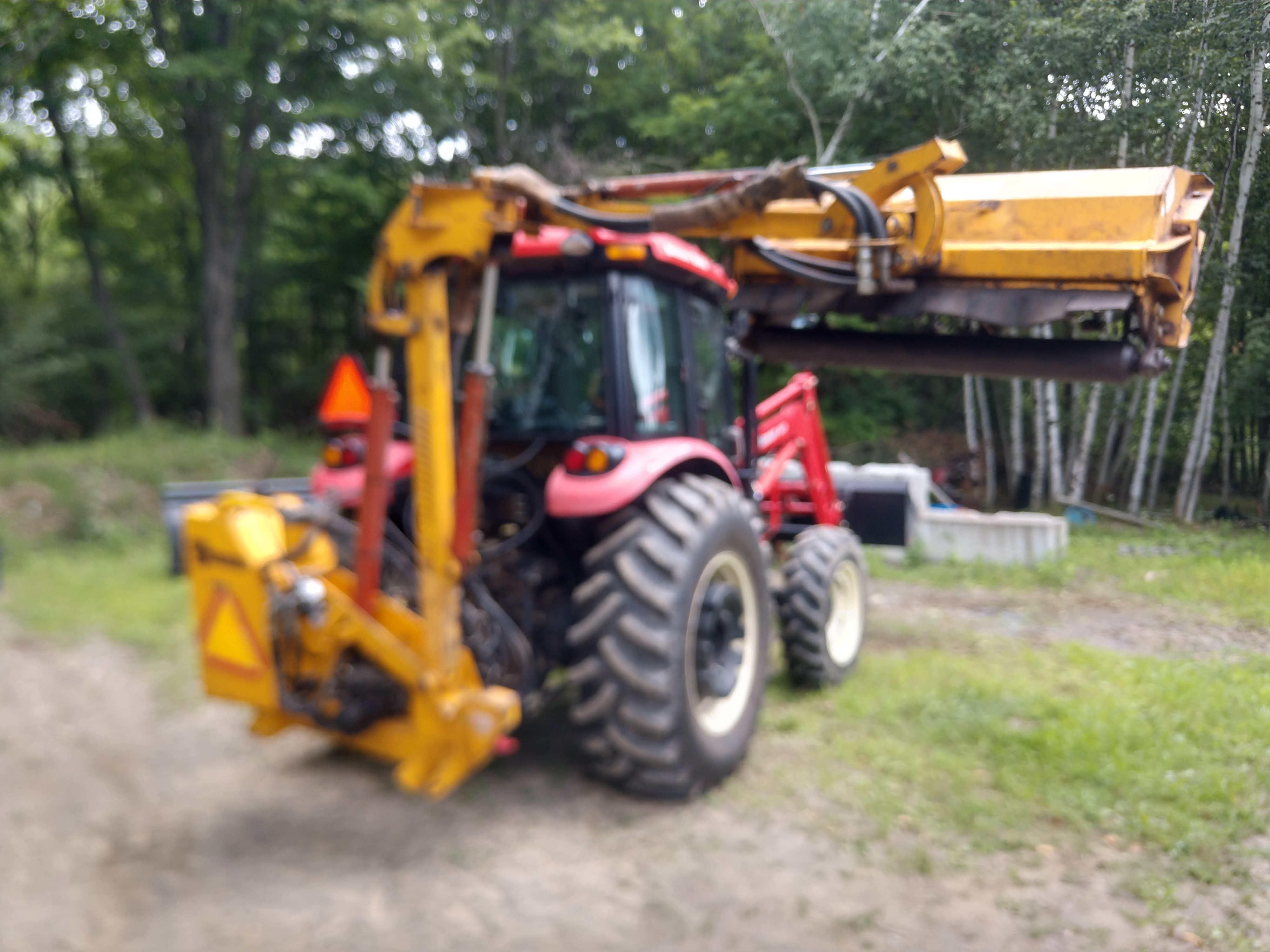

Or if you really want to offset;
I just picked this up, been a couple of days figuring were to mount the controls and how to.
making slow progress.
this unit has 5 cable operated valves that need to be in the cab, Branson didn't leave any easily accessible locations to mount stuff,
I've got the cab beam covers pulled and going to be setting up a couple of different mounting locations

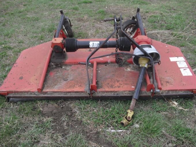

Bush hog has been doing it for years with there 7 ft twin spindle. View attachment 553326
That is the like ours. Actually we have two with one for parts. I saw the one that we use for parts first ($400) that had a brand new 3PH but needed other work as well. The $1100 we got is well worn but OK and the 3PH had been welded on.
The 3PH soon broke and BH wanted $350 for a new hitch so I went and bought $400 one so I now have other spare parts. :) I will add a Tractorhouse ad with three photos.
In waist high Johnson grass it is a load on the 3600 Ford. It is my go to cutter but for waist high stuff and bushes > 1.5 inch and a lot of large dead limbs like in the spring I use the super heavy 6' bush hog behind the 265 MF for the first pass. The offset on the PTO is steep so I do not like to load the cutter really heavy because the PTO joints are already very sloppy from wear so I try to grease it after every 1-2 hours of use but that is not a problem because I try to start around 6 pm seldom mow for more than two hours.
