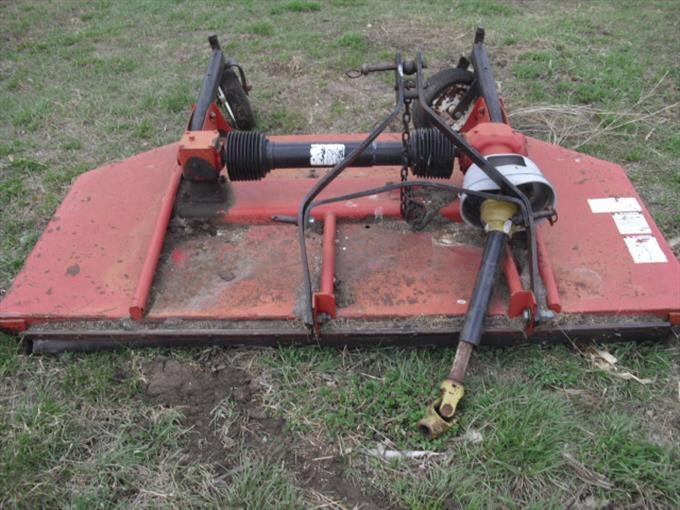

I think its galvanized , There was a company that was making them with galv metal I just don't remember the name at the moment
   / Dumb question - can you offset a rotary cutter? #12
Yes, it was galvanized.

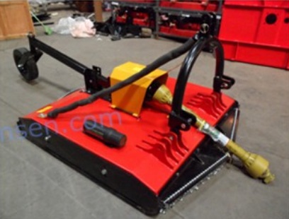

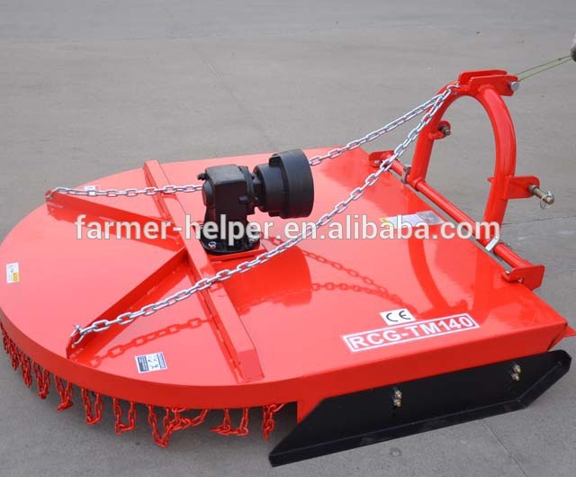

Here's another Chinese offset method.
This looks like a 2-way sliding offset:
You can find some of these with a search of alibaba.com.
And a TBN modification:
