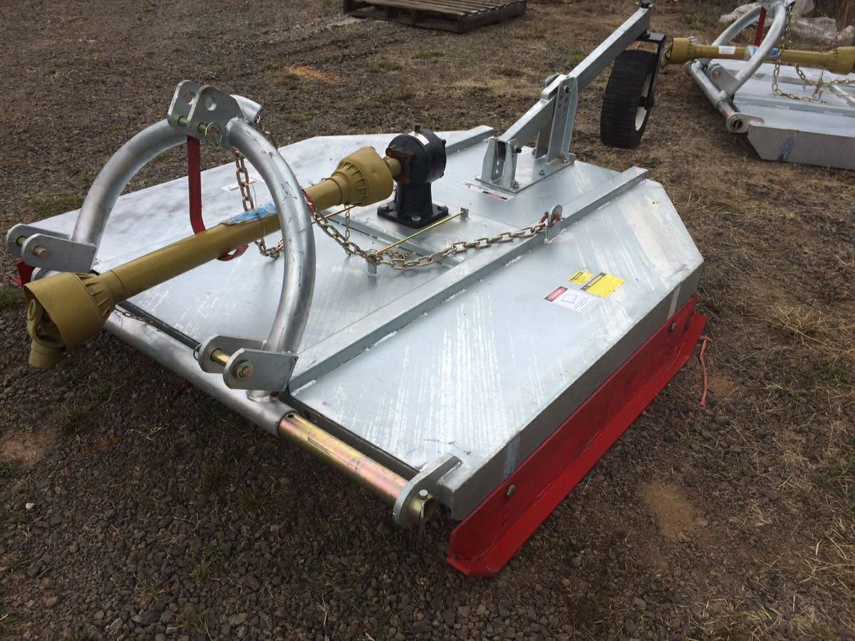

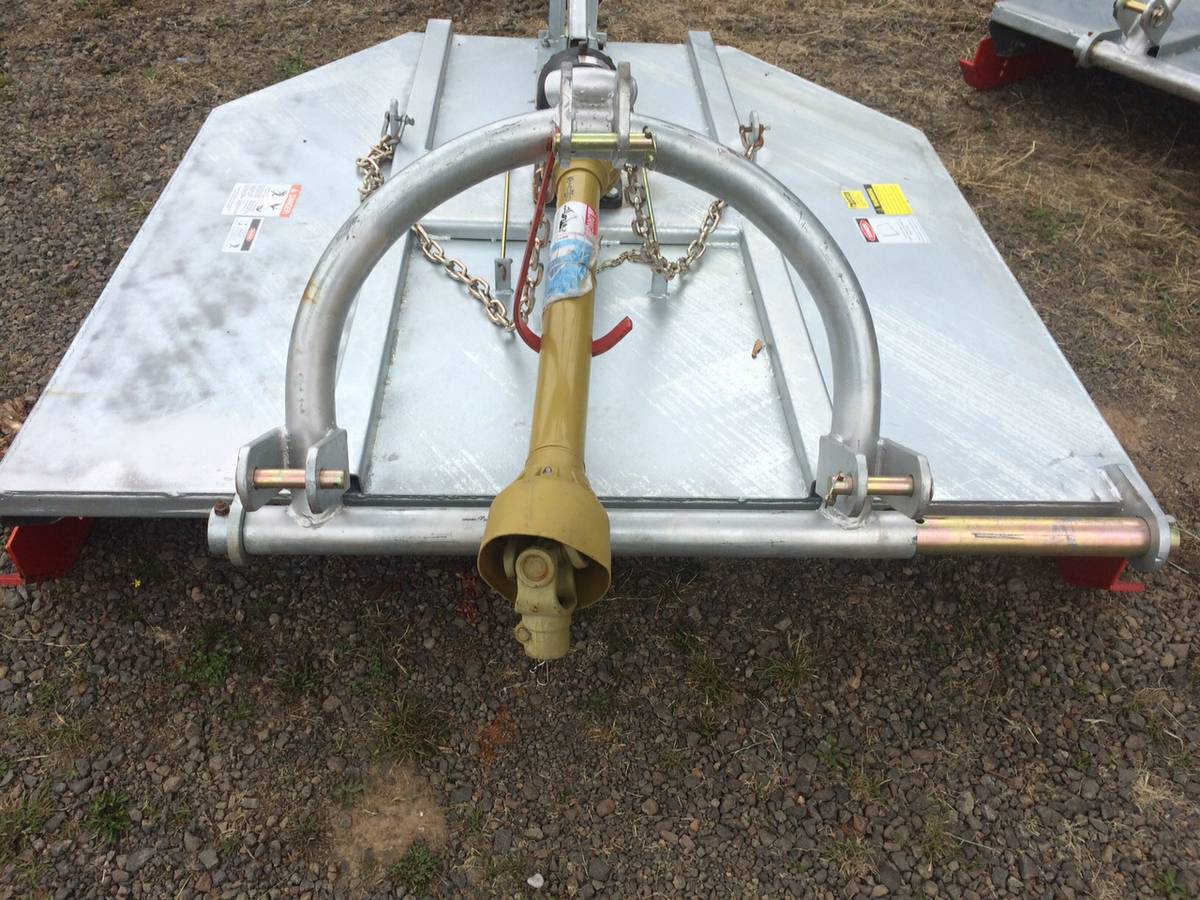

I don't really know if they are available in the US. I'm thinking it's not available.
These are slightly different from the ones in the US as these can use Chains or Blades accordingly to the use. Chains will deal with rocks, stumps and whatever is hidden in the brush but it's still possible to run a set of blades. Chains will also heat more HP.
These offset mowers will offset to both left and right sides and will offset about 10 inches, depending on the model and width of the mower, which might not be enough to mow the sides of the driveway. There are light, medium and heavy duty versions available.
Shipping one of these can be cost prohibitive. It all depends on what you're trying to mow. Maybe an offset flail mower, like it was suggested, can work.
Anyways, here is a brochure with English translation for those mowers:
Agriduarte: https://agriduarte.com/v4/wp-content/uploads/2019/07/FT_470070_Capinadeiras PT_FR_EN.pdf
