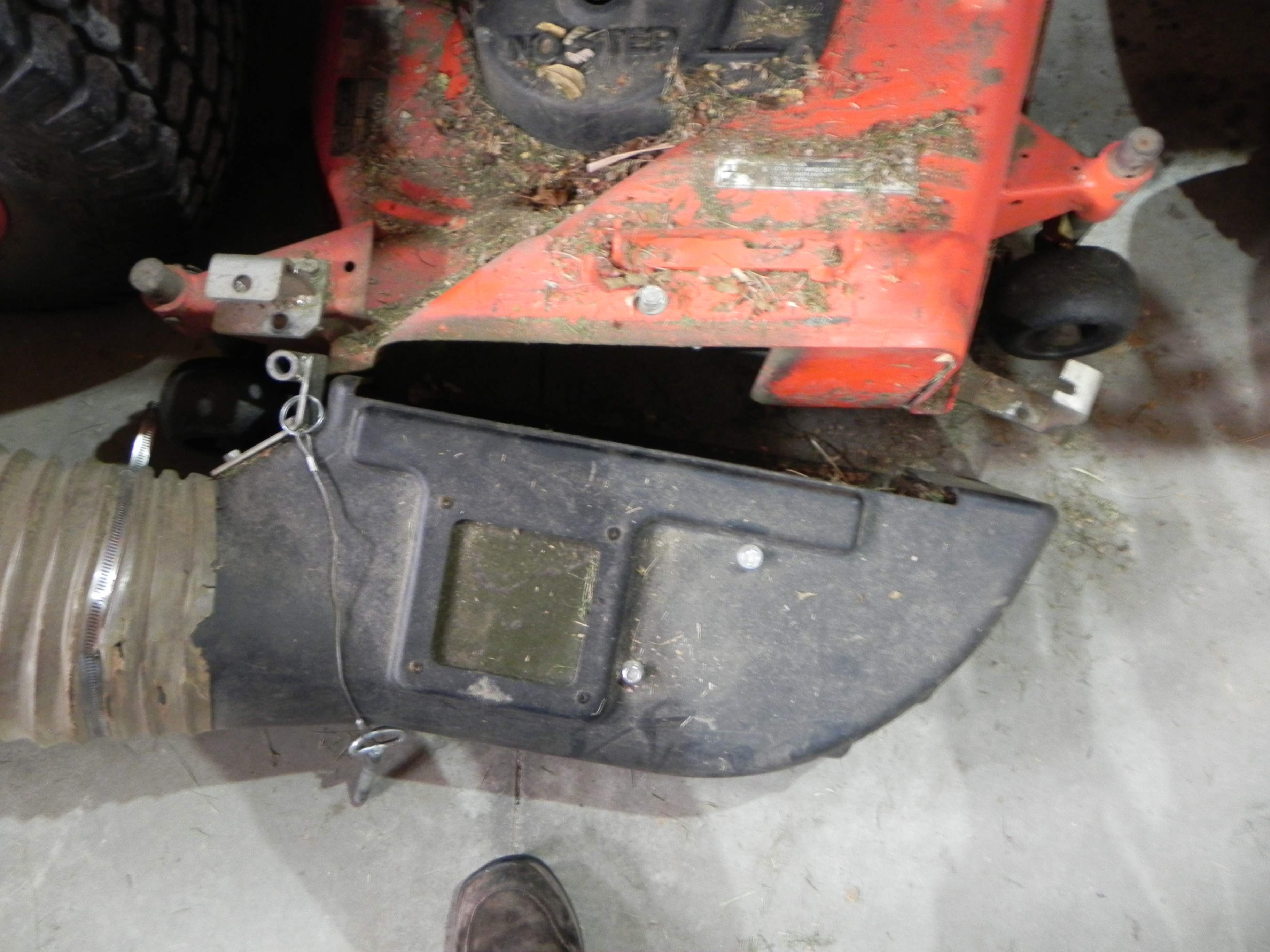

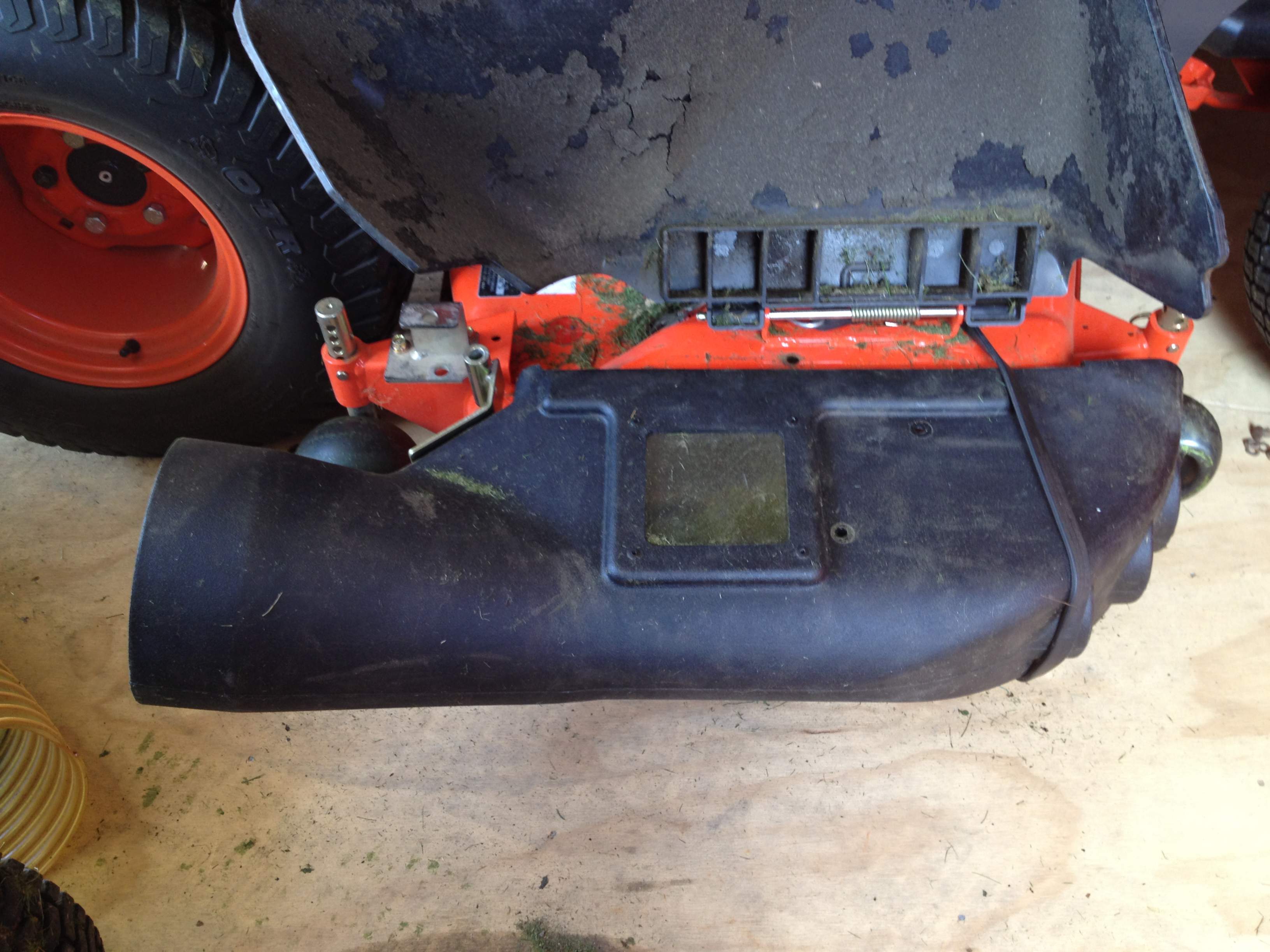

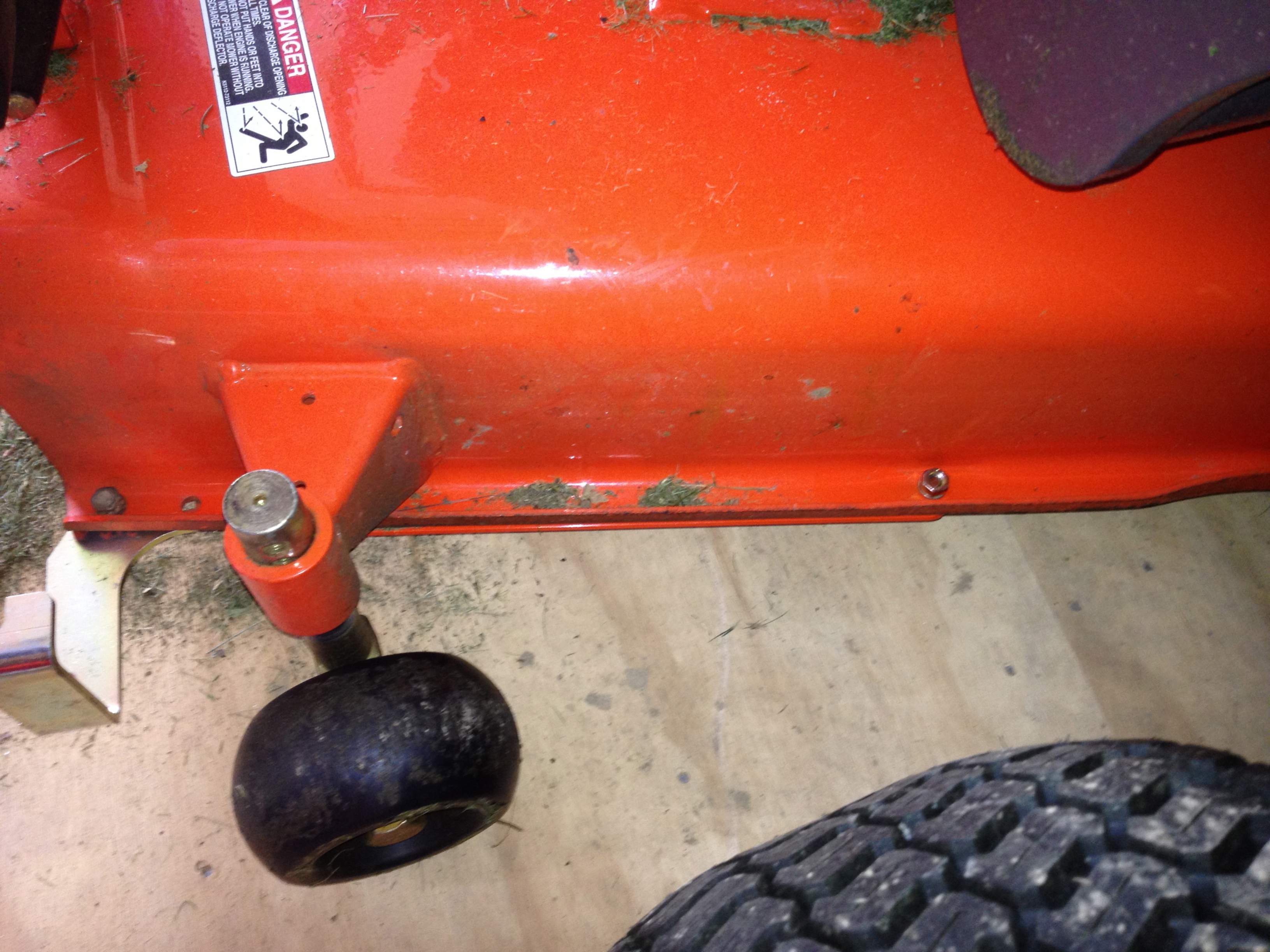

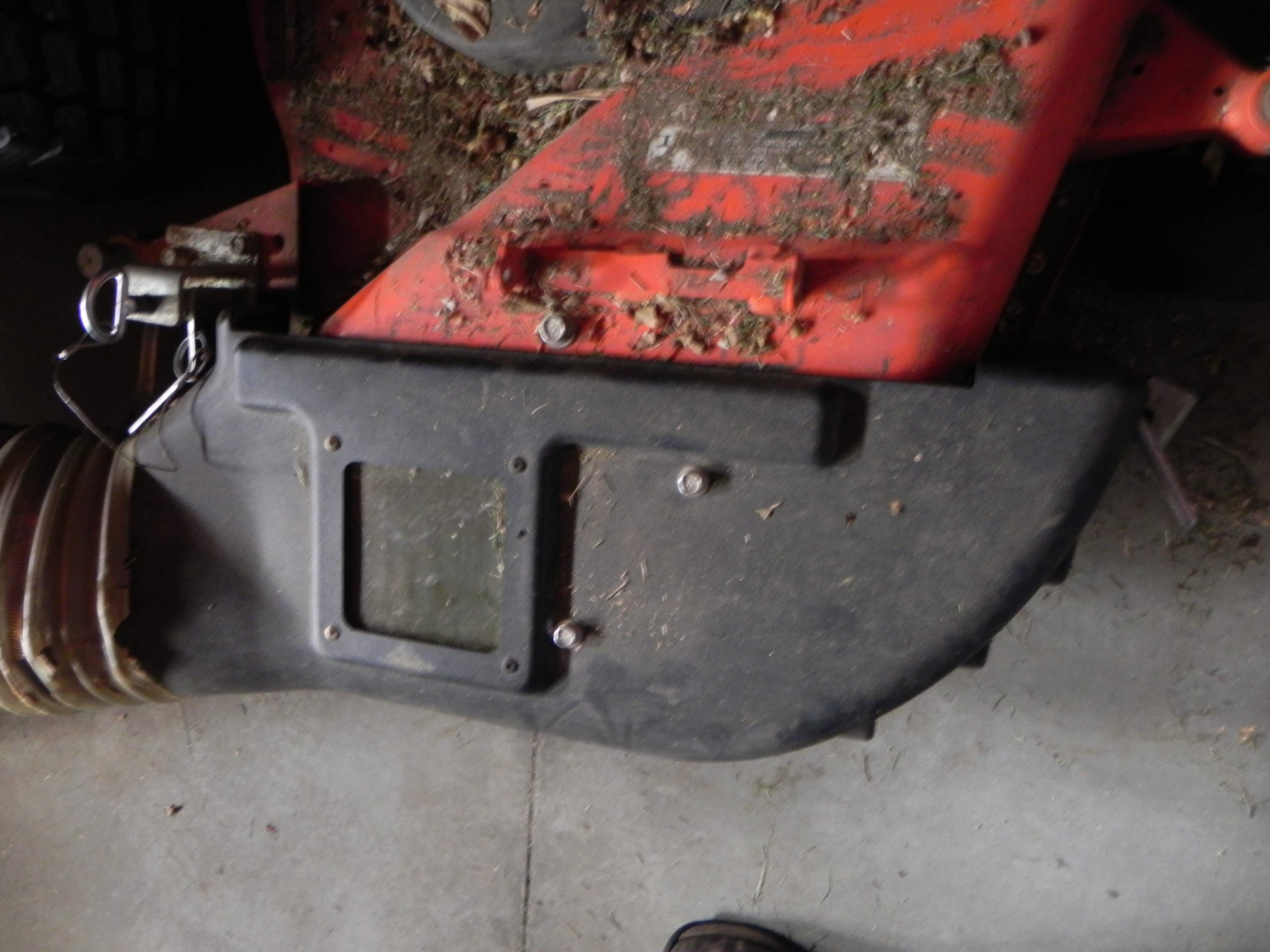

I have the 60" deck which may be part of the problem. I have removed the baffle inside the boot. I was experimenting to see if I could get it to engage the deck more fully. My deck does not have a deflector on the deck shoot. There appears to be a mounting hole for one. I guess this is what I get for trying to save a few dollars and buying a used one. It was in excellent shape and claimed to be only used once. I suspect the one time the previous owner may have hit something and decided it wasn't worth it. I can't see how the front bracket would be bent otherwise. It worked great with my kludged assembly. If I can get it figured out it should be nice with the leaves once they fall.

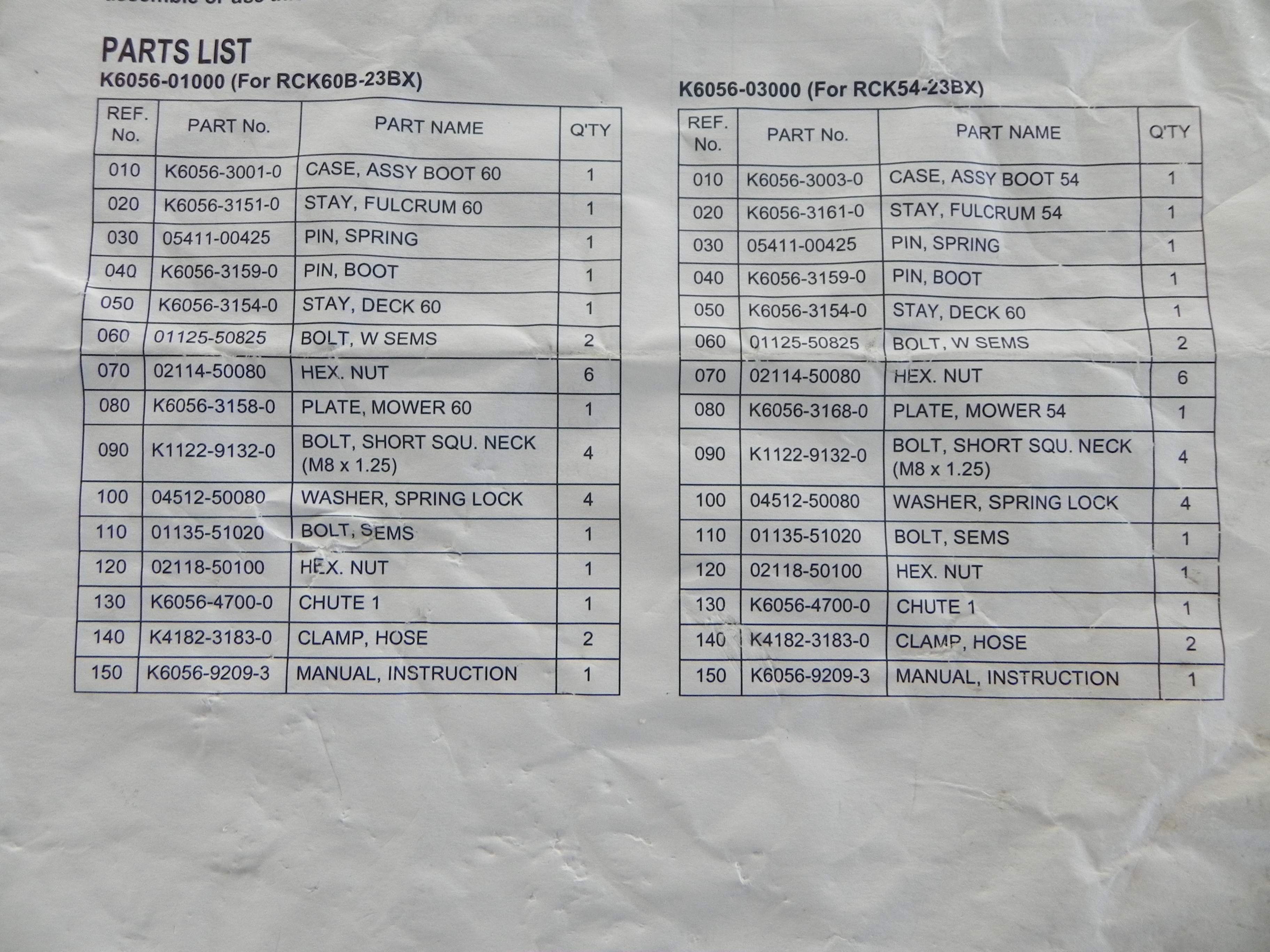

I dug out my boot kit assembly instructions which cover both size decks, and appears they got you the wrong boot kit. It looks to me that the parts you showed are the boot kit for the 54" deck (K6056-03000). A few of the parts in the 54" kit are the same as for the 60" kit, but there are many key parts where they look very similar and everything mounts the same way and all that, but the part numbers are different and slightly different sized, etc. I now understand why it won't all come together. BTW, it also appears there was one part missing from the kit you got, the "Plate, mower 54" (K6056-3168-0) which is that shoot deflector thing I was calling the inner deck baffle thing. (one of the many parts that is slightly different between the 54" and 60" deck.)
If you got a pretty good price for the used catcher, I'm sure you'll still be money ahead even if you have to order the correct boot kit for the 60" deck.
For the 60" deck the boot kit is K6056-01000.

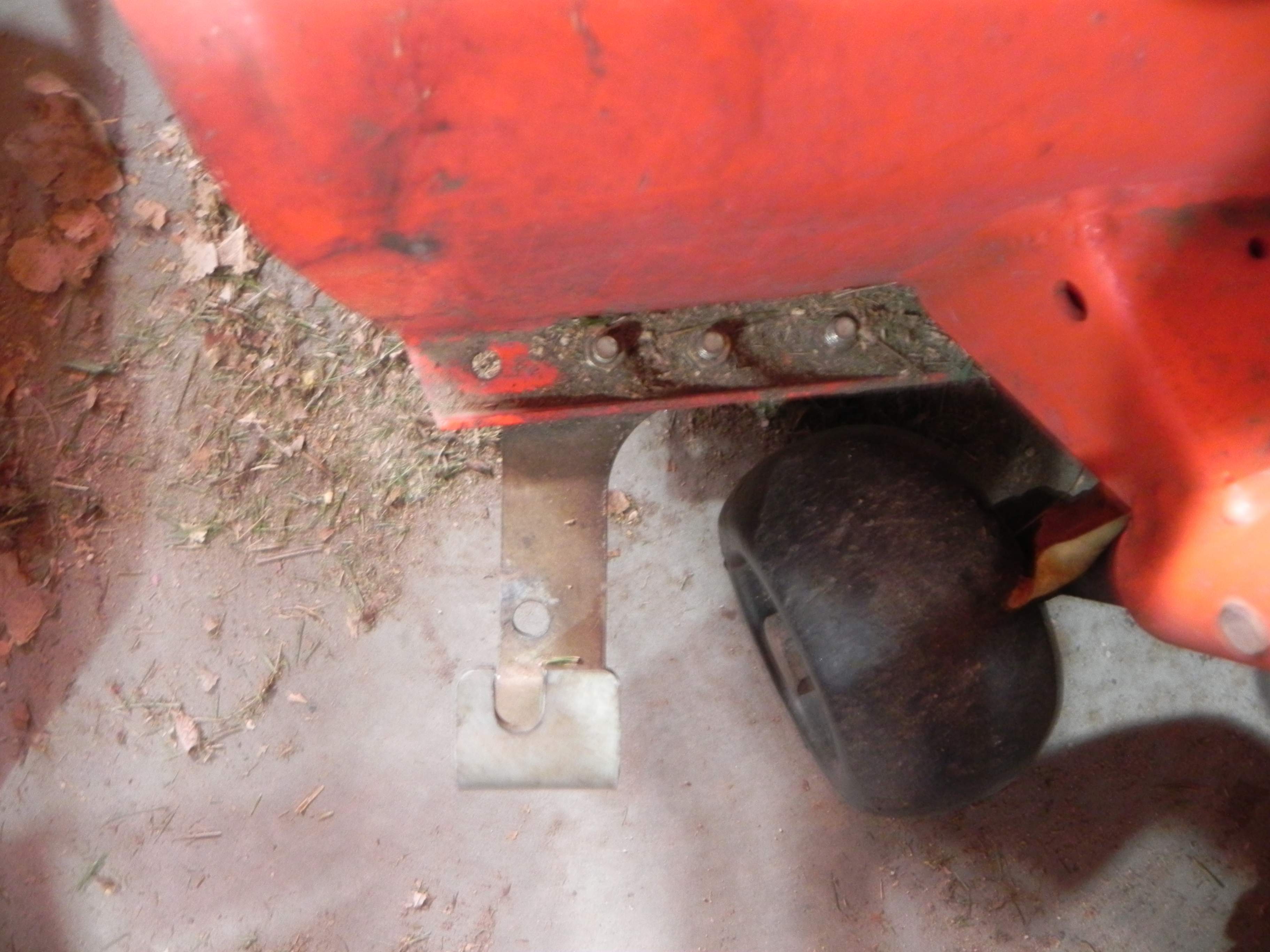

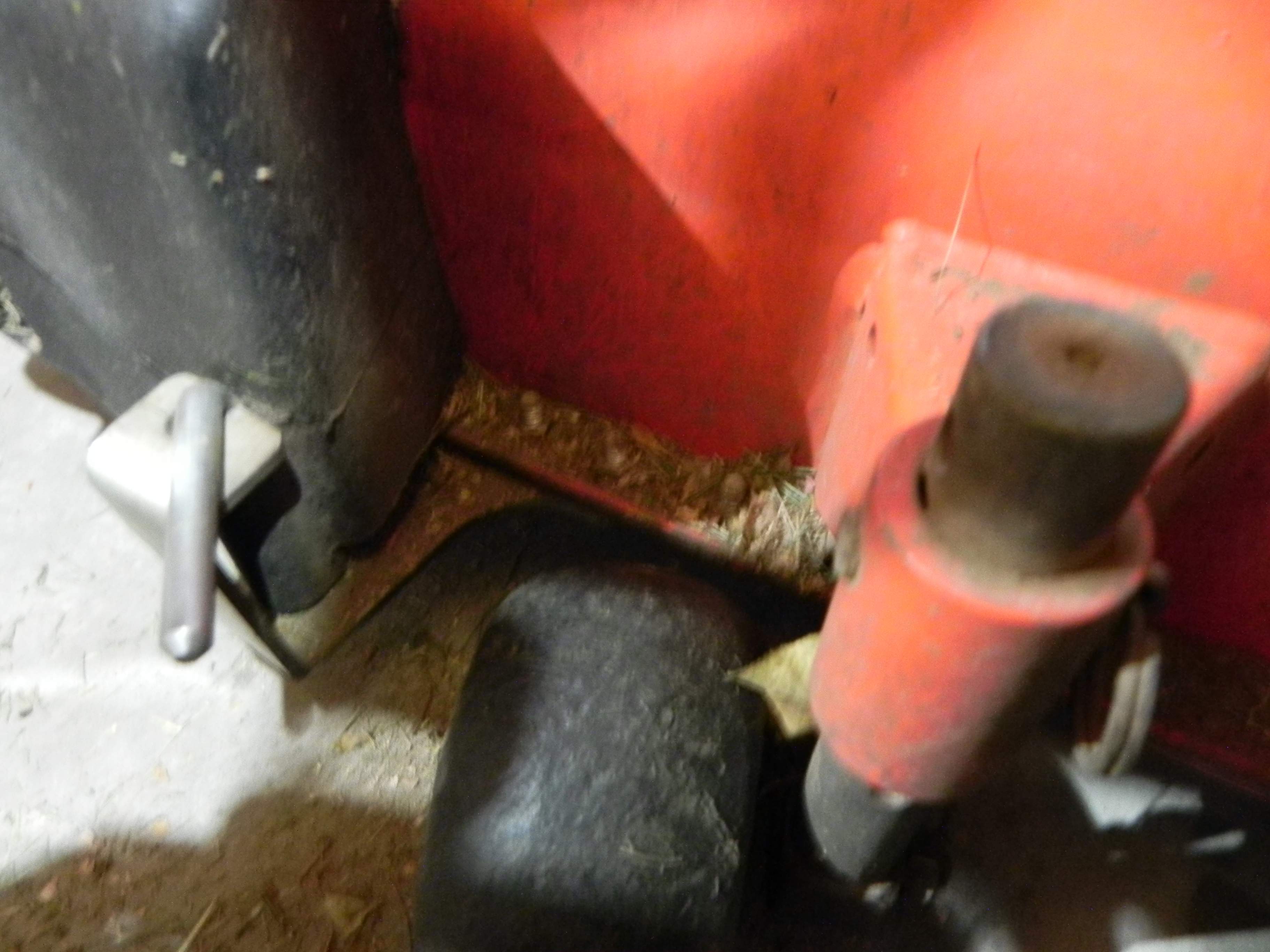

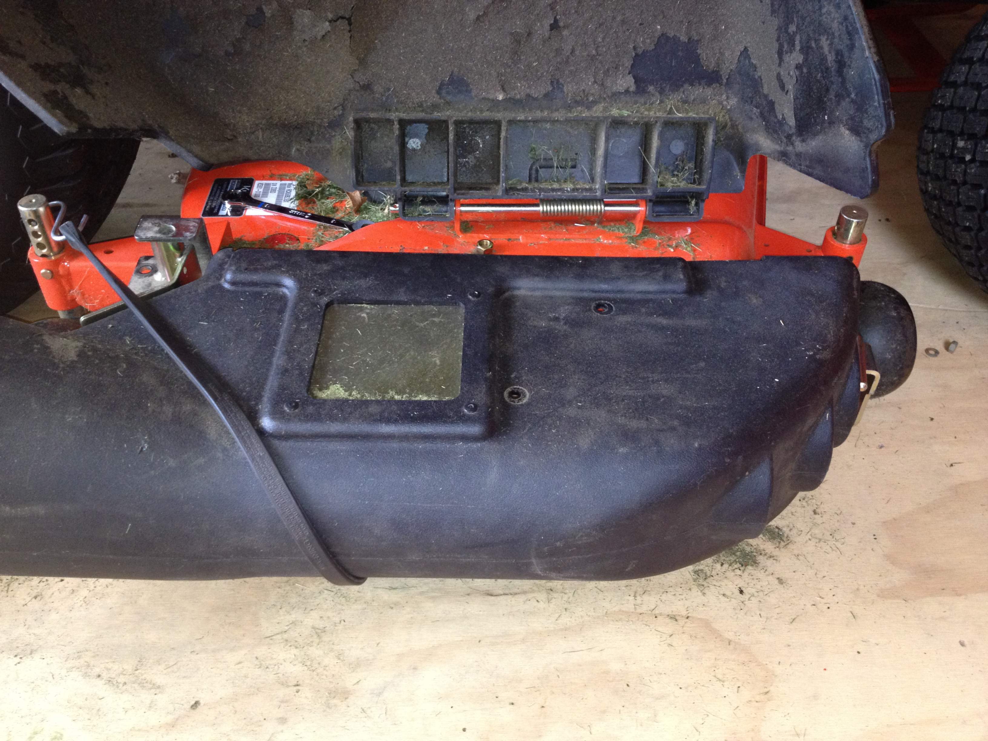

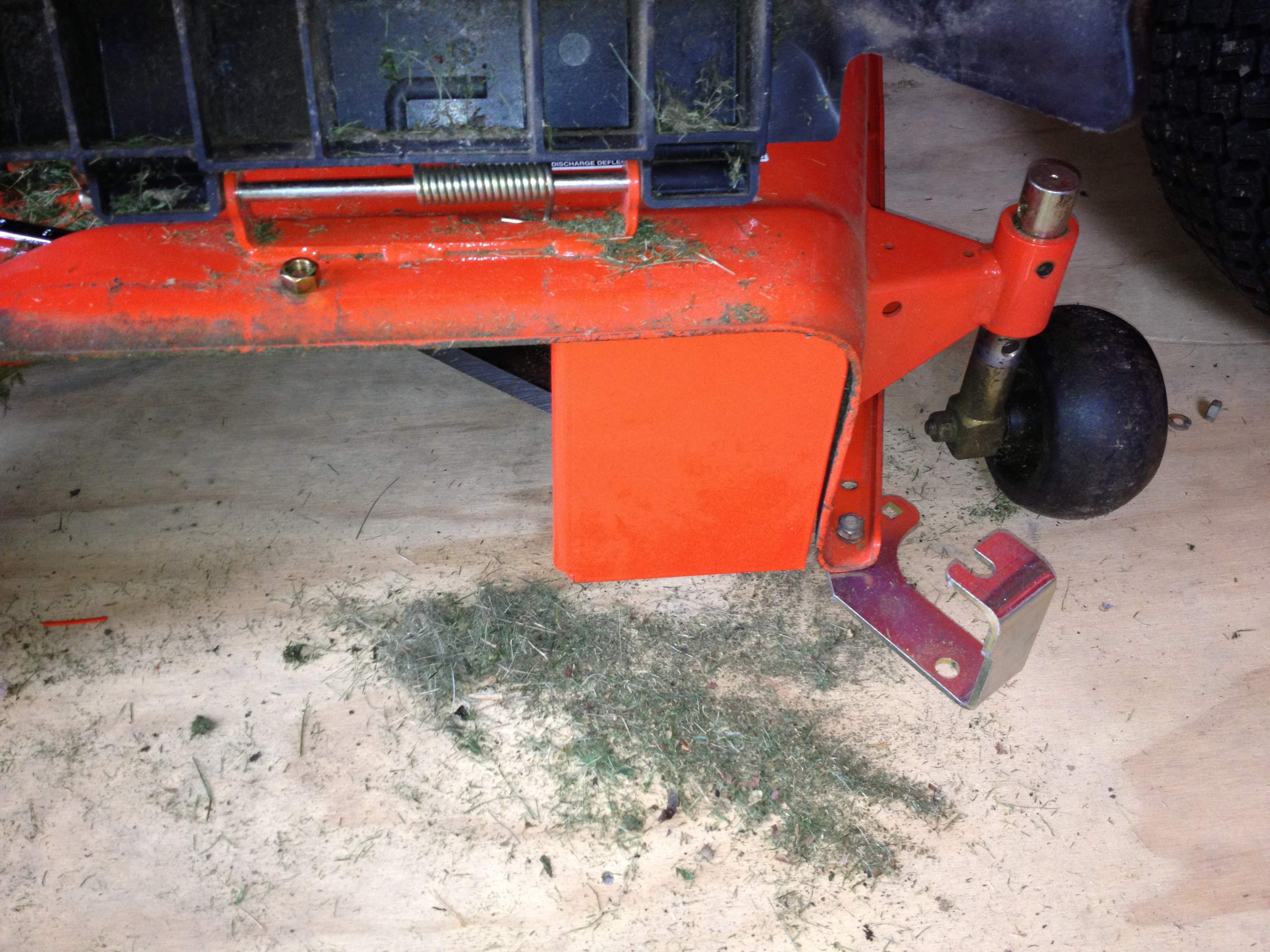

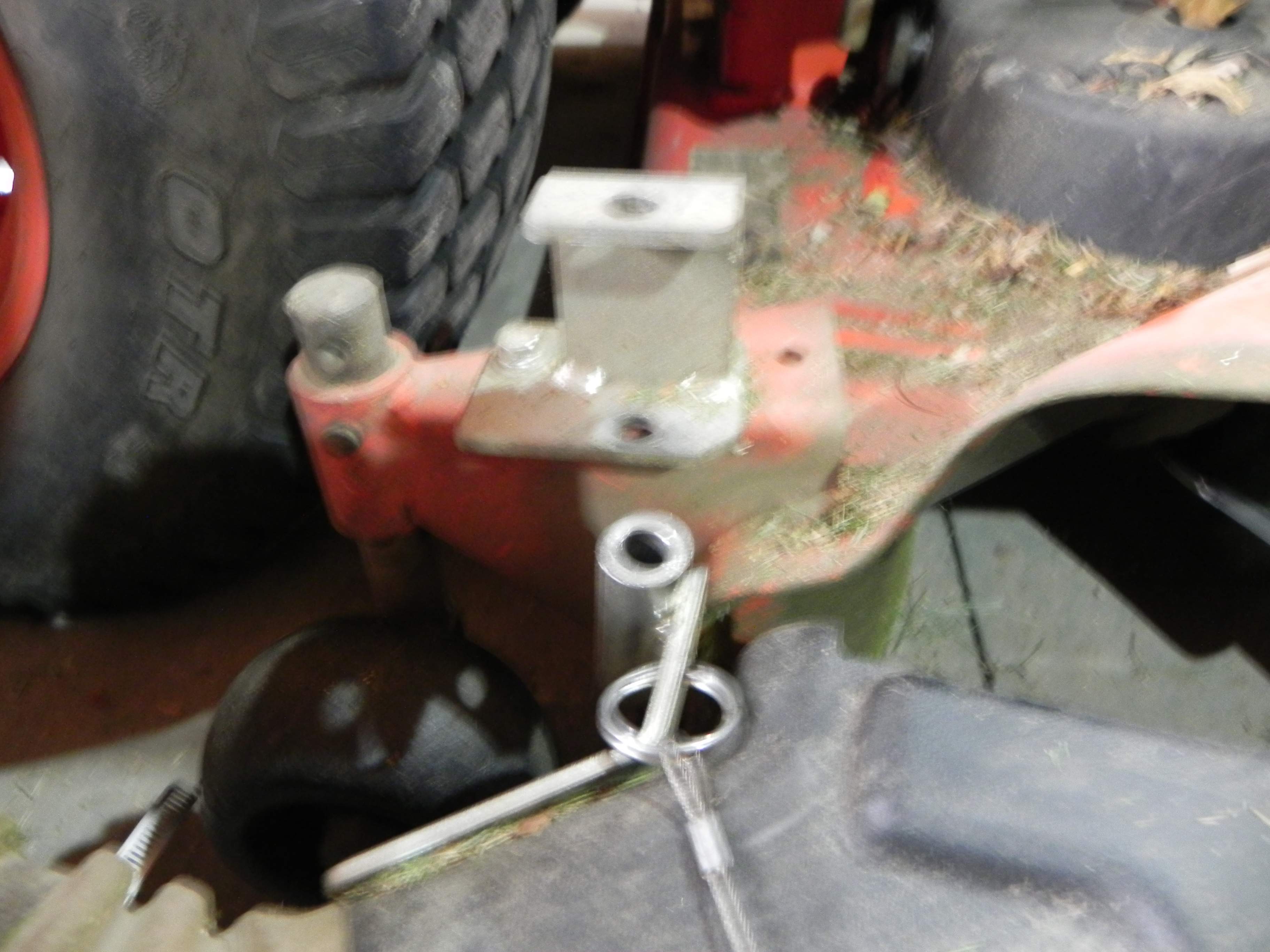

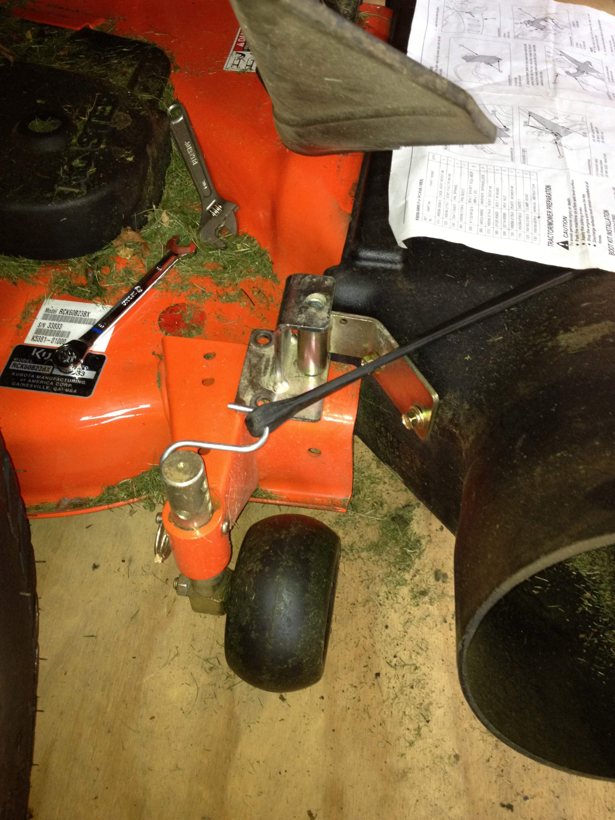

Last weekend as I was going out of town I stopped by the dealer and picked up what I thought was the correct boot kit. I attempted to install this weekend with no success. the only thing that seems to match is the mower plate. The second front bracket I received does not match the holes in the deck. The second rear bracket is the same as the first and mounts into its holes but boot will not reach the bracket when installed. I am really at a loss. I have a RCK60B-23BX deck and think I have all the correct parts but still it does not fit! IMG_0578.jpgIMG_0579.jpgIMG_0580.jpgIMG_0581.jpgIMG_0582.jpgIMG_0583.jpg
/ Dumb question (?) BX grass catcher #24

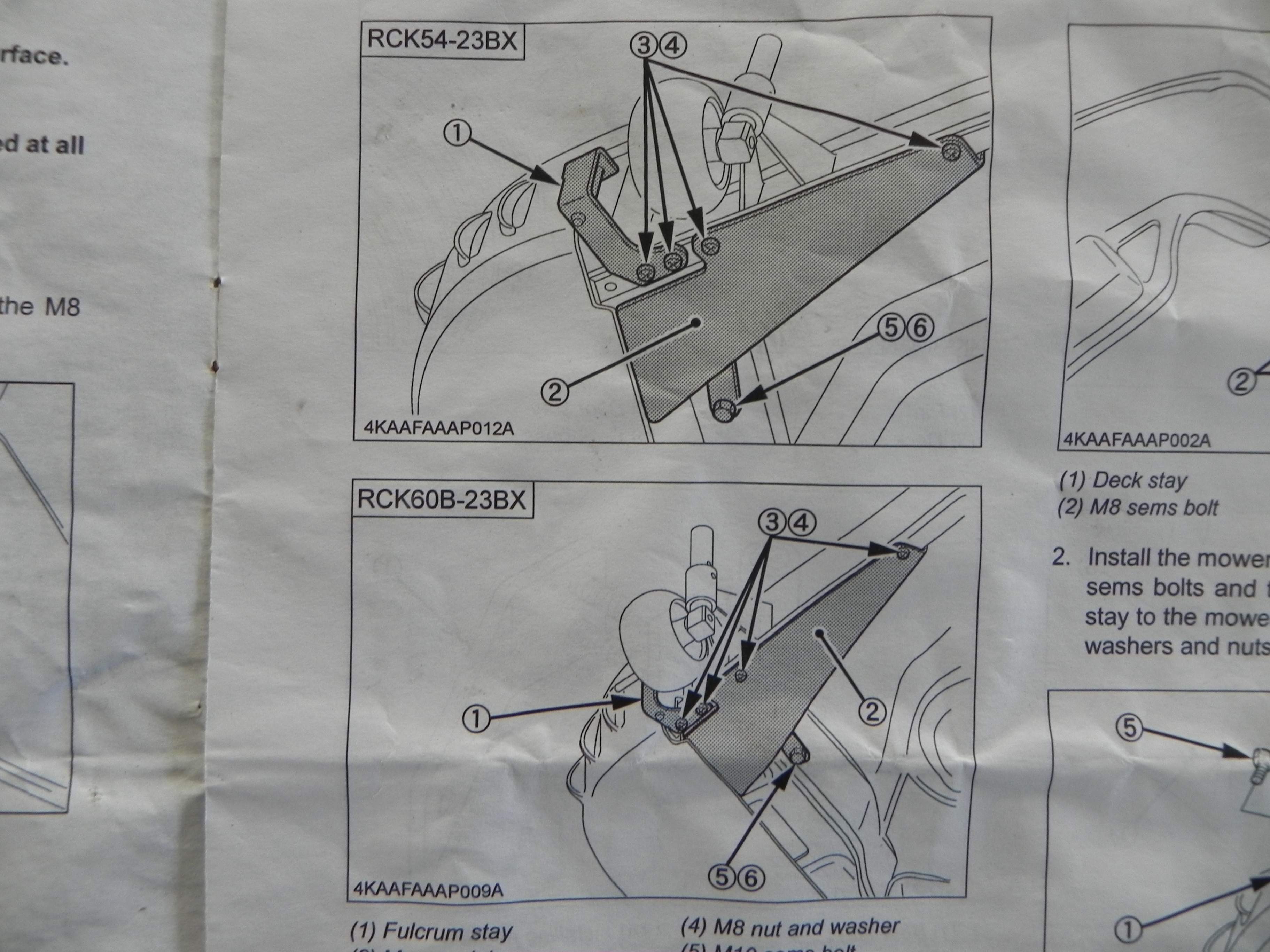

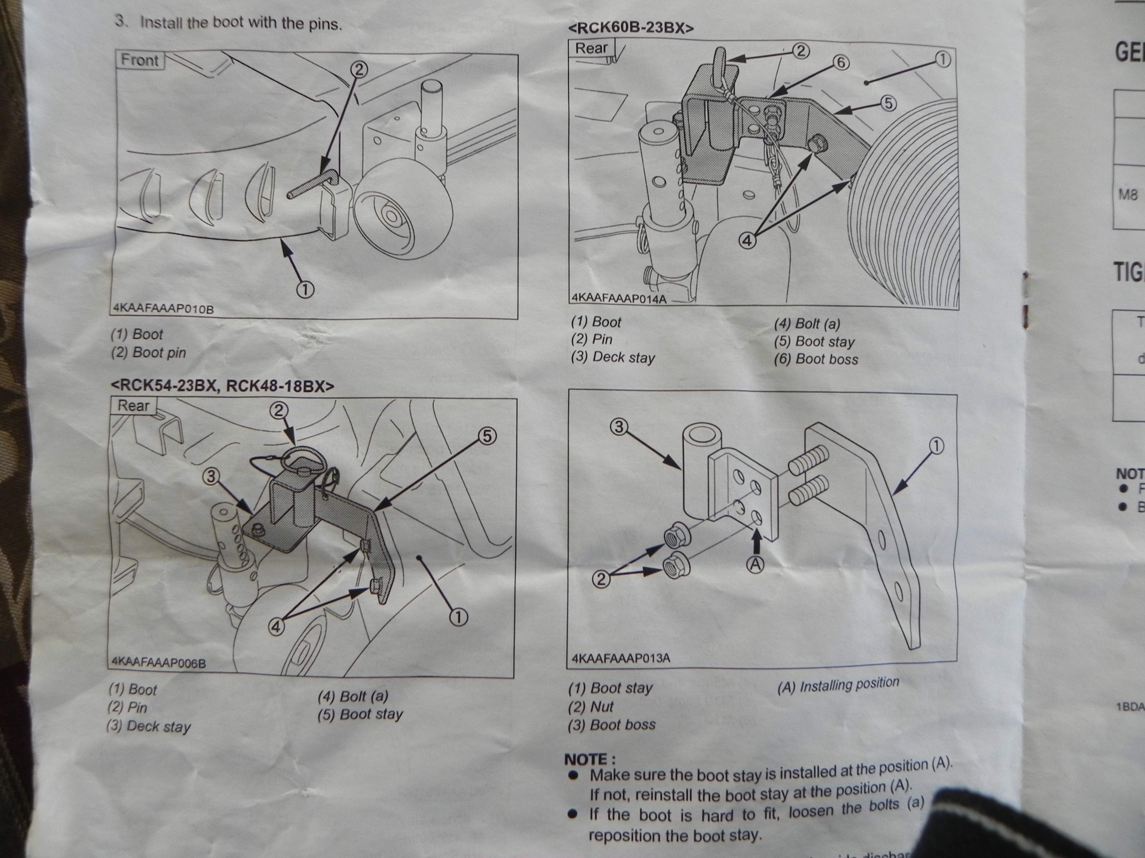

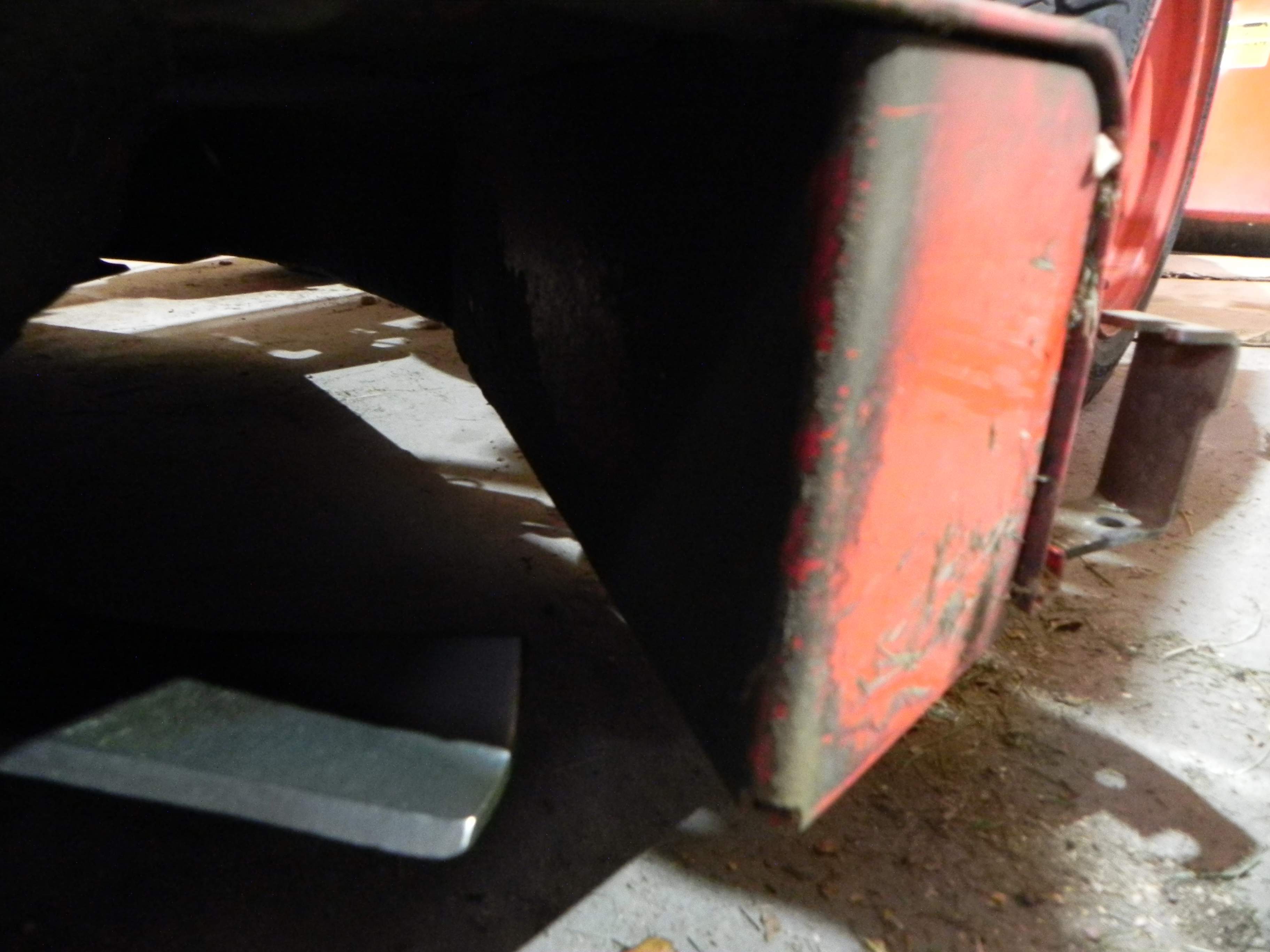

This has to be pretty frustrating for you. I hate to say it, but I think you still haven't gotten the right parts, or at least not all the right parts according to what I see in my instruction manual. Note - I got mine a couple years back, so it's possible some of these parts have changed, but I don't think that's real likely... I believe if you had all the correct parts it should just go together like mind did.

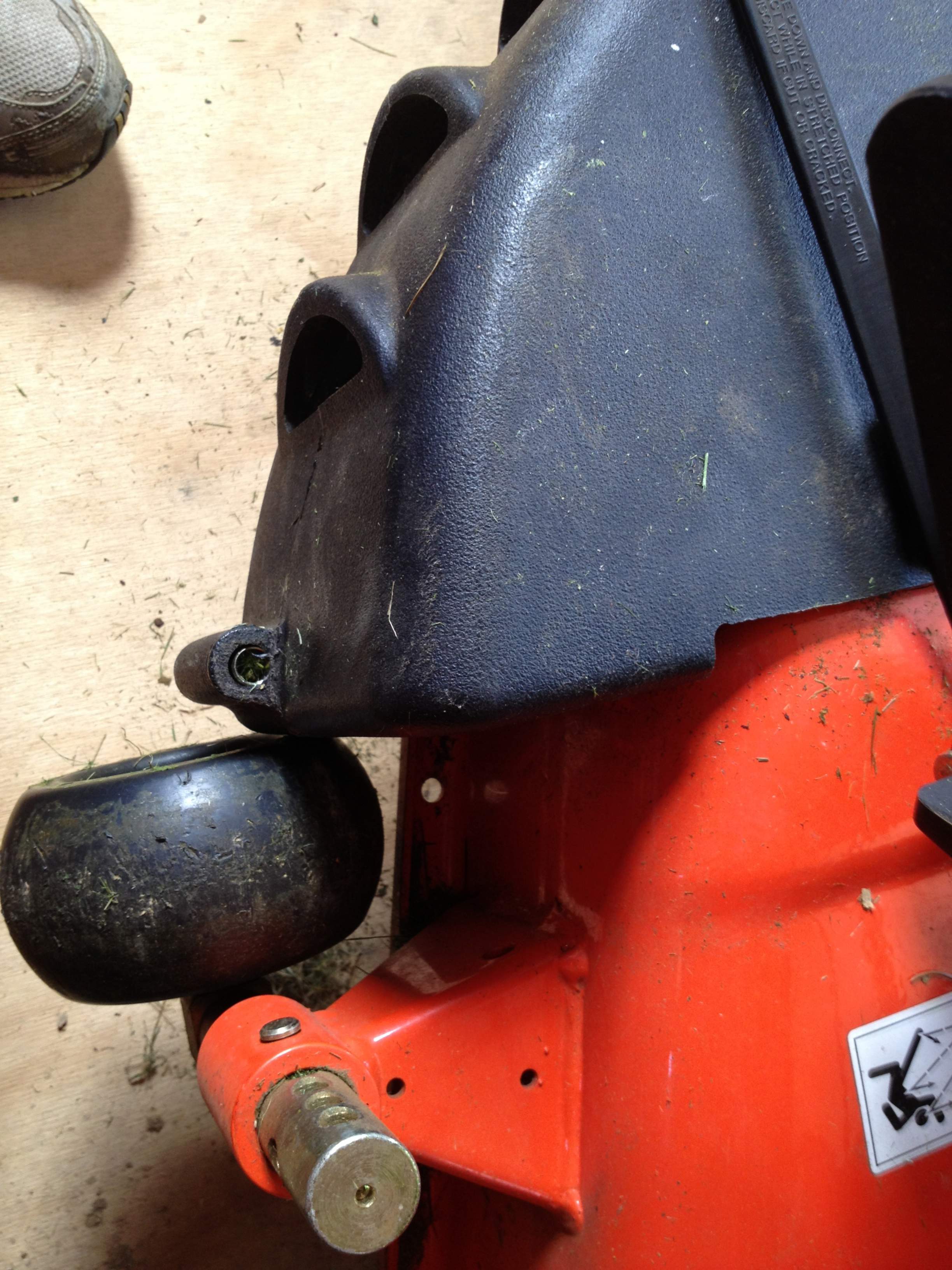

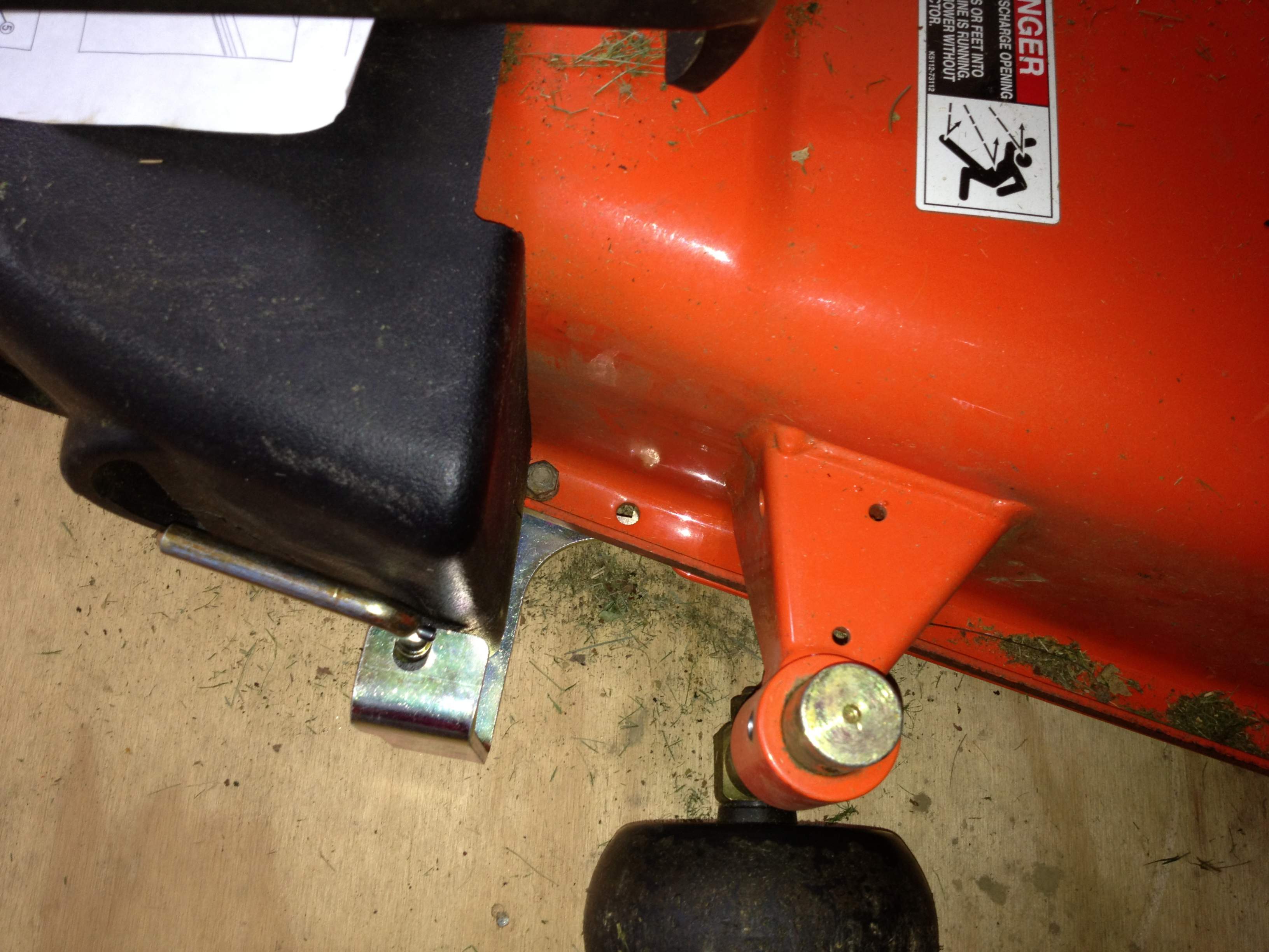

In my instruction manual it shows that the "Deck stay" (back bracket that mounts on the deck) is the same part number for both the 54 and 60 deck so that's not an issue. However, the "Boot stay" is a different part number. (This is the bracket bolted on the rear of the Boot that mates up with the rear Deck Stay.) The Boot stay for the 54 inch deck is a single metal bracket that is bolted onto the boot. It looks just like the one you show in your pictures. The correct one for the 60 inch deck is actually two metal pieces bolted together that then make up the complete Boot stay. The assembly of those two pieces (that make up the Boot stay) is bolted to the boot.
Left is 54 inch Boot stay, right is 60 inch boot stay.

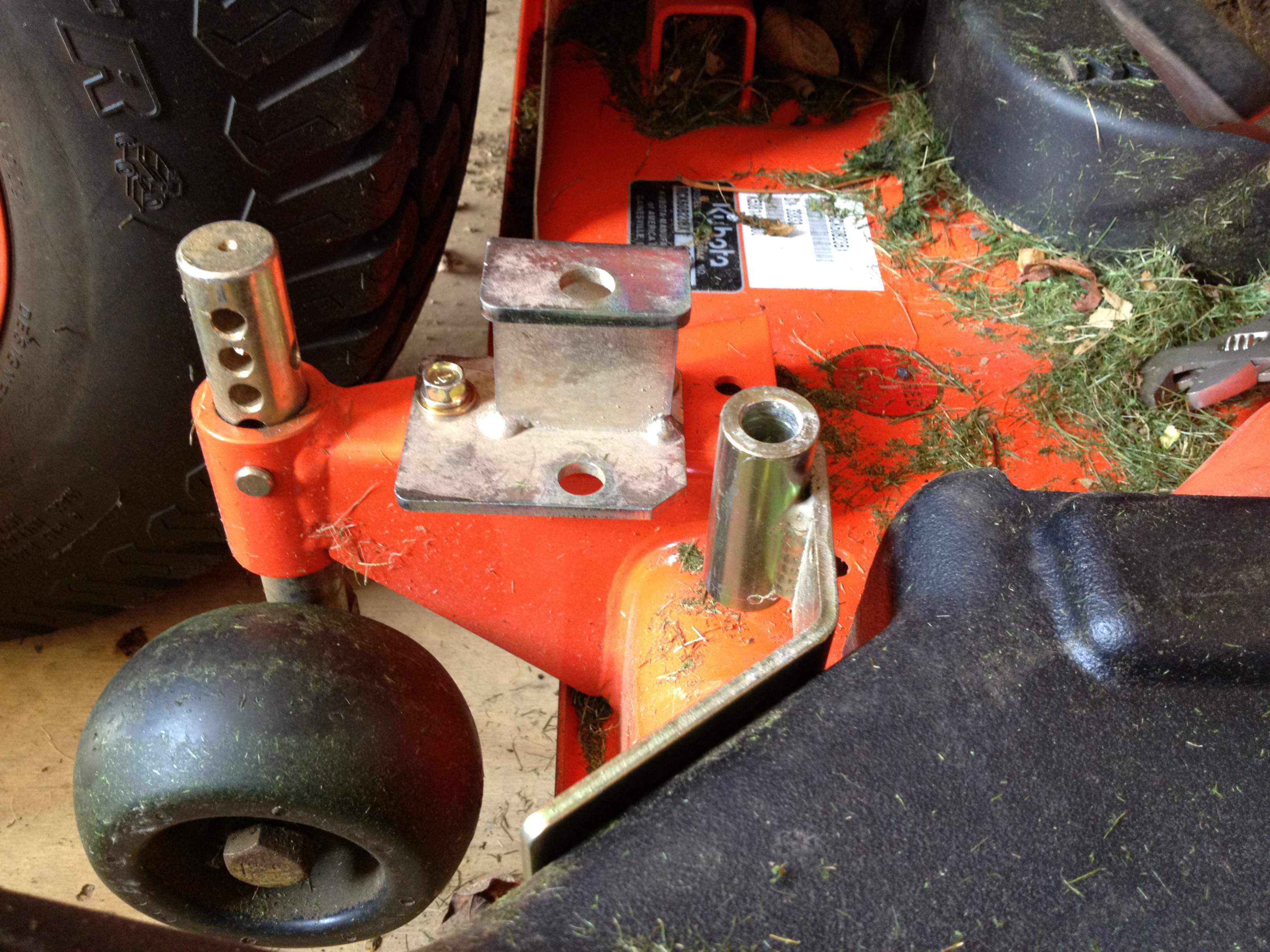

The "Fulcrum stay" (the front bracket that mounts on the deck in front of the chute opening) is also a different part number for the two sized decks. To me, looking at the drawings in my instructions, it looks from its shape like the one you have may also be for the 54 inch deck. I think that's why it won't fit your deck holes.
However, you said that the inner Mower Plate mounts correctly, so seems you may have gotten the correct one for the 60 inch deck??? (Unless that it is also the 54 inch deck version but just happens to line up with your bolt holes...) The Boot itself looks basically the same between the two sizes (although two different part numbers) so I can't guess if you have the right one of those.

Looking at the part list again, I see there are only three parts different between the 54 kit (which I think you have) and the 60 kit. Of course they are the most critical parts. They are:
Case, Assy Boot
Stay, Fulcrum
Plate, Mower
I noticed there is no separate part number for just the "Boot stay" that is referenced in the installation instructions. I think the "Case, Assy Boot 60" must come with the Boot Stay installed. I recall the Boot came as one item in my kit. That is, the "Case, Assy Boot 54" came with the Boot Stay already mounted on it. I am guessing that you have the 54" boot assembly (with the 54 Boot stay installed). This leads me to think, as mentioned prior, that you also have the 54 front Fulcrum Stay - particularly since it won't install in the deck holes.

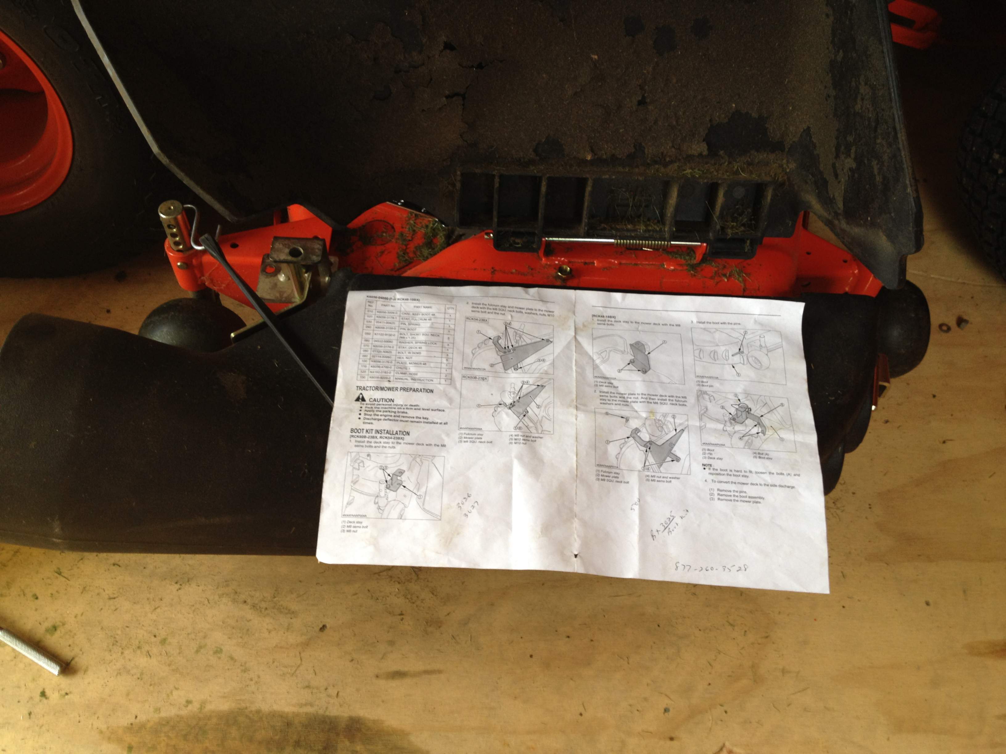

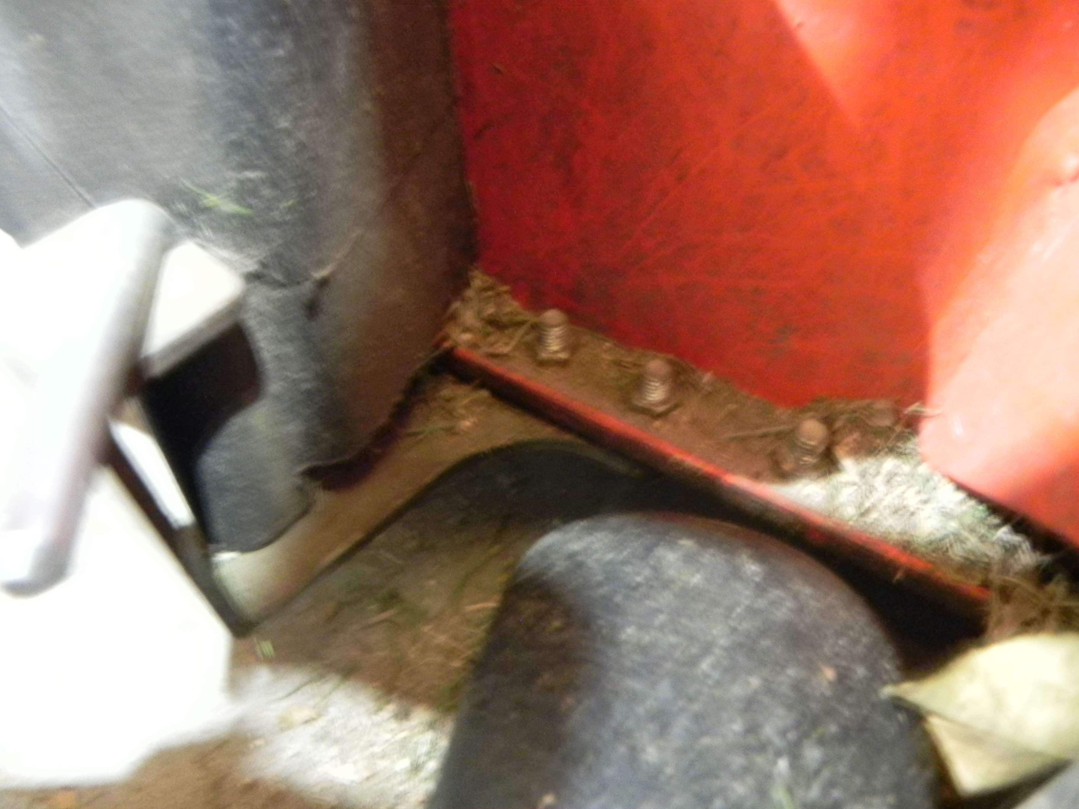

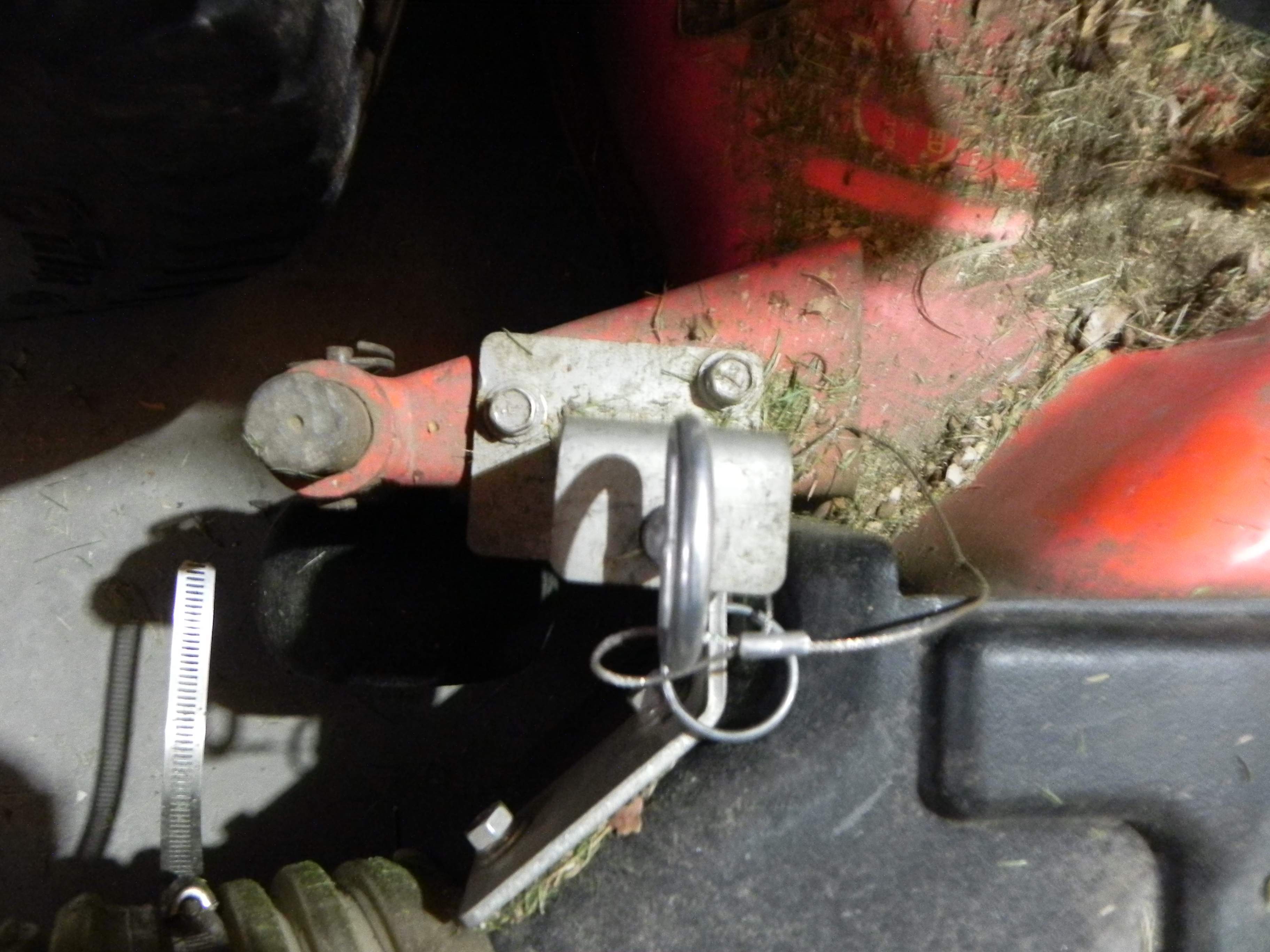

Thanks to everyone for your support. The dealer ordered a new boot kit. I got there this morning to pick it up. I just installed it. There are some alignment issues but overall the boot is different from the original two I was trying. Also the front bracket had a completely different design. The internal deck grass deflector is the same and I still have the issue with a missing mounting hole. I did not install the deflector into the deck this morning as my need to use the grass catcher won't be until next Spring now. The short of it is I had the wrong components and that is why it would not work. Thanks again!
/ Dumb question (?) BX grass catcher #31
Good to hear they were able to finally get you the right kit!
