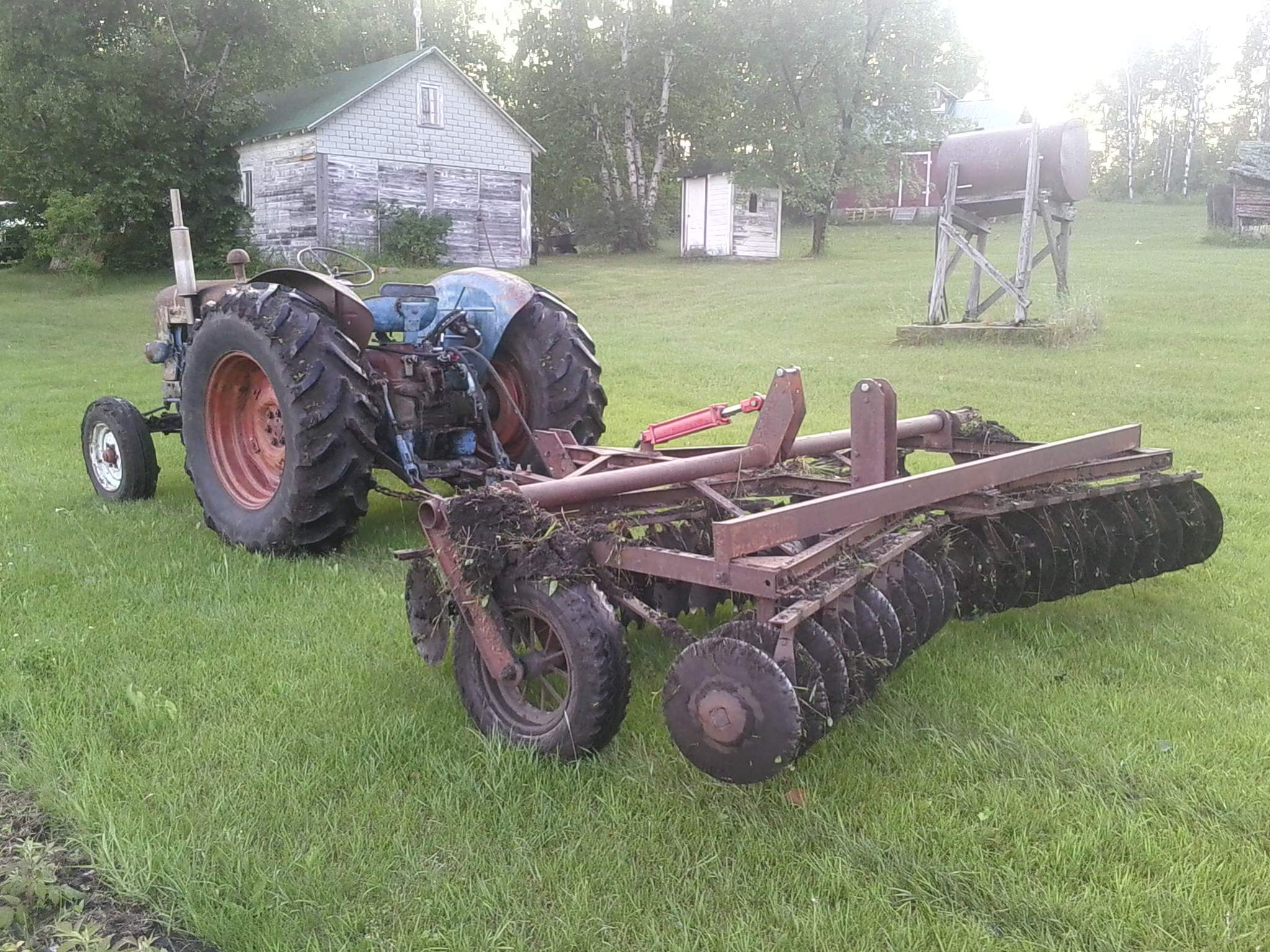

Double check your disk, my tractor was able to pull a 16' transport disc, but i had to keep bumping the hydraulic lift because the front gang was plowing dirt over the axle. I think it was partly due to the tractor sinking so far into the freshly plowed and disced ground. I need to modify or adjust the tongue to correct the problem.
What size are your rear tires anyways? Are they bias or radials? Have you ever checked the air pressure in them? To much pressure and they could act like pizza cutters.
I will have to check the disc a bit closer. My rear tires are 16.9-30 bias, filled with calcium chloride and inflated to 7psi.
Joe
Sent from my XT907 using TractorByNet
