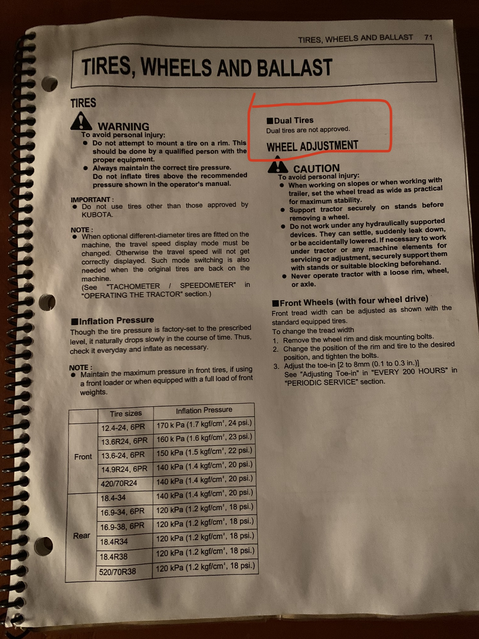

My Kubota M7040 operators manual states very clearly that dual wheels aren't approved.
   / Dual wheels #14
Some Kubota manuals also say remove tire ballast before installing a backhoe...a very practical suggestion?
Just saying...
How about wheel spacers...and so on...
No dog in this race as I will never use duals on either of my tractors. But if there was a reason, I probably would. Once out of warranty anyway...LOL

From my Kubota M-126X/M135X owners manual. Maybe other models are approved?
