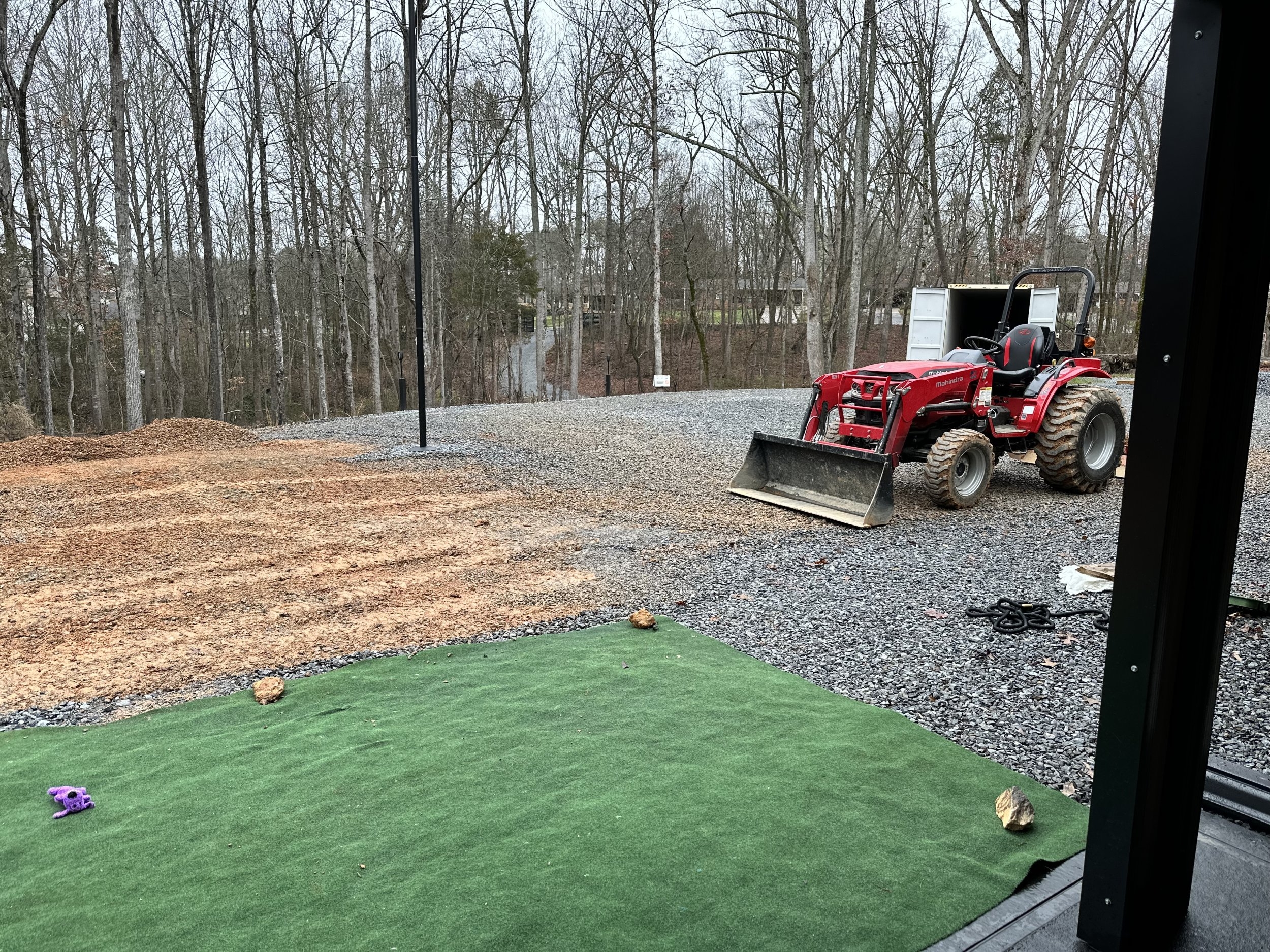

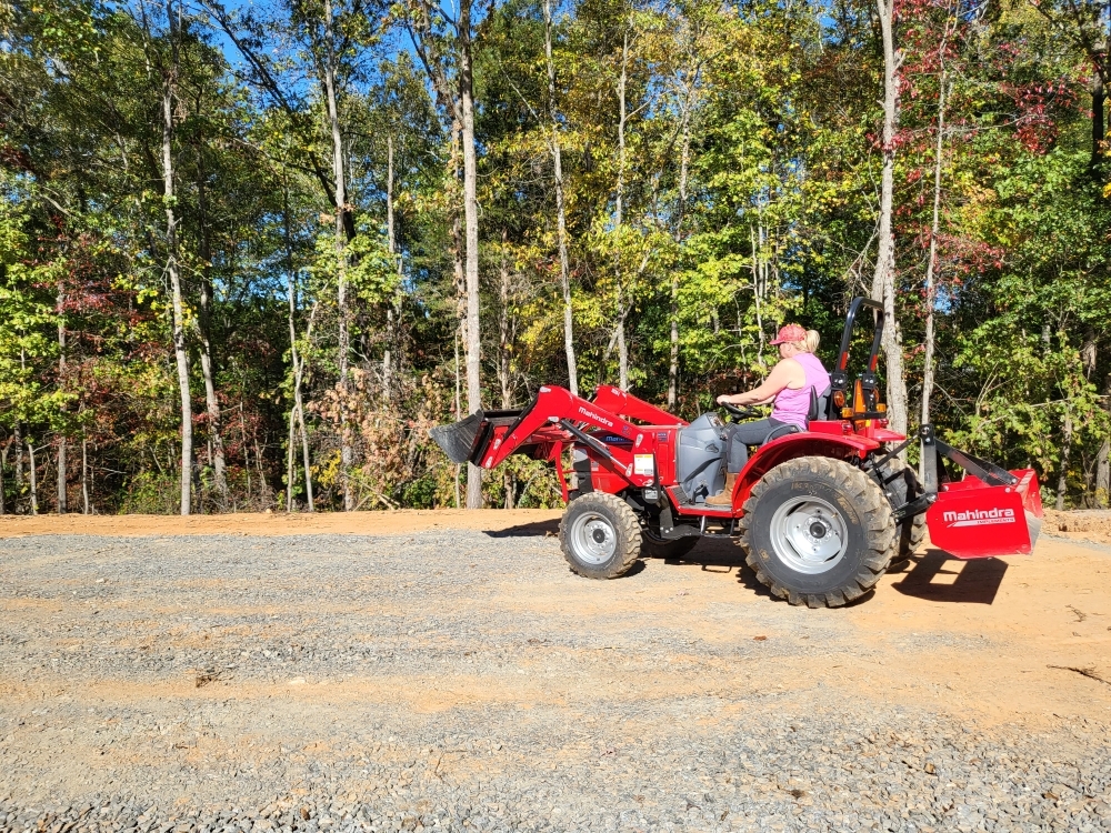

Hello I just found this forum and looks like a great place for information with me being knew to tractprs. I have a mahindra 1626 HSE that I woulkd like to put dual rear wheels on. I cannot find really any info on how to do it on the internet was wondering if anybosy has some info on kits rims what I would need. Thank you in advance. Joe

Hello & welcome to the forum. be interested to hear on a sub compact that size why you feel you need dual rears? are the current rear tires loaded? also sounds very expensive for what you'll end up with given the tractor hp. what's the application? regards

I have 30 acres and it's crazy up and dwn. Use my auger a lot. Want them for more rear stability. Thank you for the help

As you have a Front End Loader on your Mahindra AND are new to tractors, you may be concerned with your tractor feeling tippy.
If this is so, rather than attempting to add dual rear wheels, cost effective solutions would be:
1) Add rear wheel spacers to spread your existing rear wheels.
You may be able to purchase 2 X 3" rear wheel spacers from Mahindra.​
2) Fill your rear tires 50% with liquid ballast to lower tractor center-of-gravity.

I'm not really worried about the cost
I have had some experience with spacers. Have them on my Maserati Qp and range rover SVR. MAKE A HUGE DIFFERENCE. but that said i bought what the engineers recommended. I was told by my deisel mech. That works on the tractor that the bearings and axles would be fine since I do not use it for heavy work. Just box blading and using my 12 inch x4 foot auger for fencing. I've done some searches and have really found nothing as far as kits ect. All the info is much apprcted. Thank you
