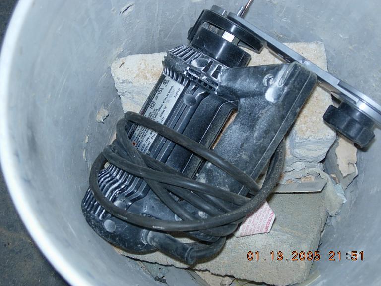

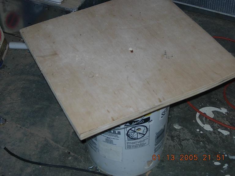

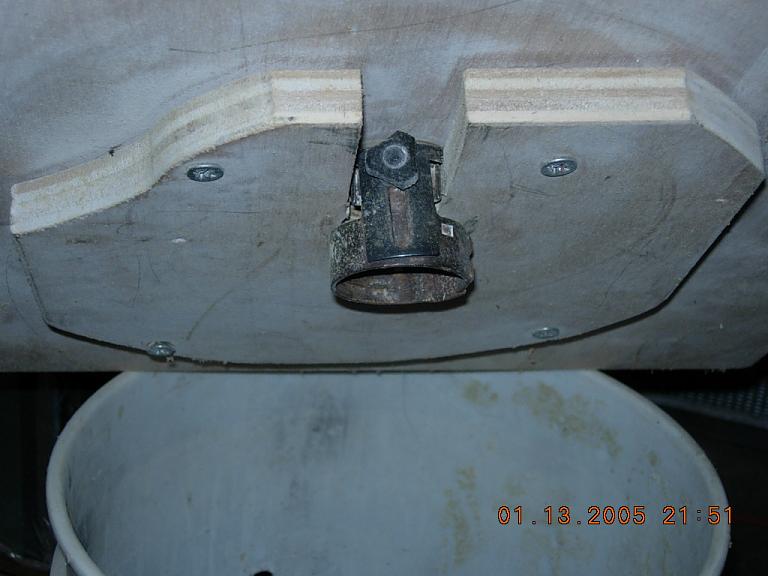

The roto zip is the cats meow. Something I did with mine, was take a 5 gallon bucket, filled bottom with rock/block material for weight. I then took a 3/4" by about 18" square piece of plywood and cut a small hole in it's center. I rigged the roto zips height spacer piece on the UNDERSIDE of the plywood, with the cord comeing out a hole for on/off abilities. I also put some small blocks of wood on underside of plywood to help hold it laterally in place on the bucket.
Why did I do all this? So that when we did our tile installations, I'd have a working flat table with the roto zip bit sticking up so I could do some freehand work where I needed to fine tune some curves or some such.
Just be careful when someone is looking for a cheap seat to sit on /forums/images/graemlins/crazy.gif /forums/images/graemlins/shocked.gif /forums/images/graemlins/blush.gif Other than that (lack of) safety item, at the risk of not sounding modest, it was one of my ideas that worked out rather well.

Here are some shots of what I did, this is the entire thing (though the rotozip is inside & no cord sticking out)
   / drywall/router tool #37
Inside bucket
   / drywall/router tool #38
Underside of the "table"

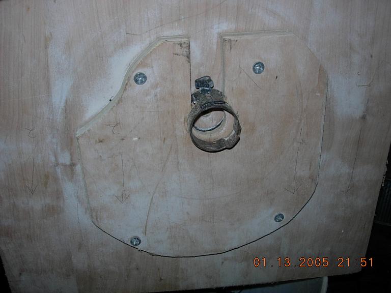

   / drywall/router tool #39
Close up of "the holder".
This was used primarily for wall tile, though as I recall, I needed to custom shave/fit some wall plates that were too close to some trim. Sooooooo, I tried my fancy invention on that (found out that mitre saw worked better /forums/images/graemlins/shocked.gif)
Anyways, you can see the adjuster piece of the rotozip that I worked into there...kind of a pain to take screws out to take that part OUT, but as long as it's left inside, you can just twist the tool on/off
/forums/images/graemlins/cool.gif
