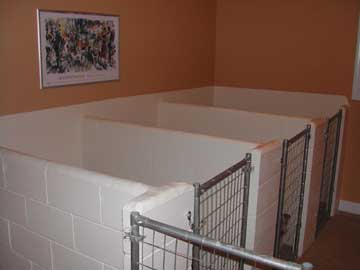

Maybe this is off subject, but we put Kennels into our new house built in 2004. We used Cinder Block for the walls, and Cement board for the Studded Back wall. Here is a pic of the Kennels.

Once the Cinder Block was up, we sealed everything with a combo of Latex paint and Portland cement. Fills all the holes in the Cinder block, Then sealed everything with 2 part epoxy paint. We used pet doors that had a plastic collar in the inside and outside the house with a plastic filler to fill the 2 x 6 stud wall. No wood!! My wife is into this dog stuff, and we did a lot of research. Everyone said avoid anything that will absorb moisture. Here is a pic of one kennel.

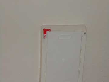

Used this new 2 part water clean up epoxy, paint store said in order to bond with the latex / portland undercoat this was best. I am sure there are better sealing systems out there, The price for this was in our budget. Last pic of a pet door.
