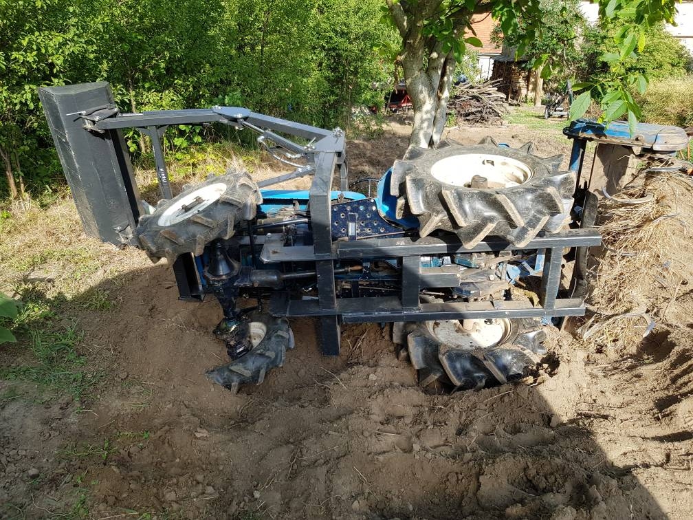

This is what happens to you when you run the FEL too high....

The real question is what was in the bucket? Did you come down off the hill behind the tractor on an angle? I know that with the bucket on my tractor I need a counter balance on the rear because the rear end is light when the FEL is on. That counterweight could be anything from a grader blade, woodchipper, logging winch or a mowing deck.
Not a lot. Just 2 bags of instant concrete as extra weight.
Behind my 600 kilo iseki tx1300 I had my tiller, which is over 100 kilo, and is always kept low for obvious reasons.
But because the front axis of my iseki is pivoting, anything in the FEL being raised can quickly get nasty.
Having this iseki for 5 years now, there are countless times that I had to change underwear
