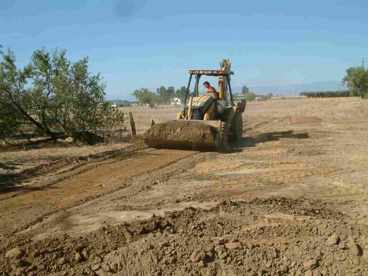

Here's a photo of my septic system leach line trench being backfilled and packed. The Cat TLB weighs about 13,000 lb. Mike, the operator, backfilled the 100-ft long leachline trench and then backbladed the trench with the bucket full of soil for added compaction. Did the same for the 1250 gallon concrete septic tank.
Don't think you have a problem with your tiny BX.

Oops! The attachment didn't show up. Here's another try.
