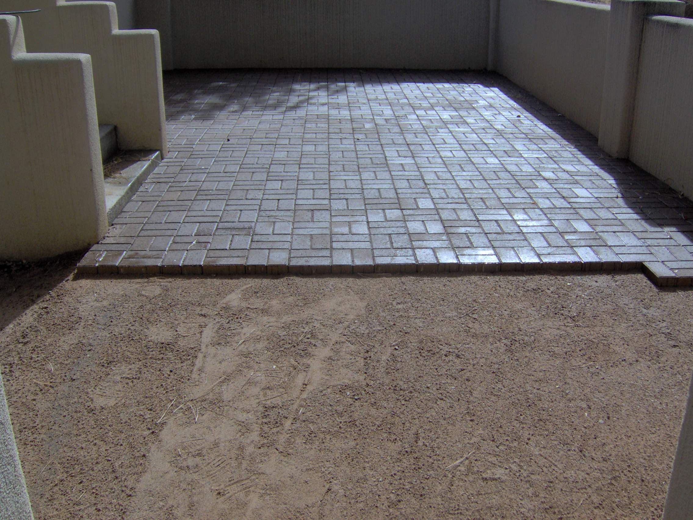

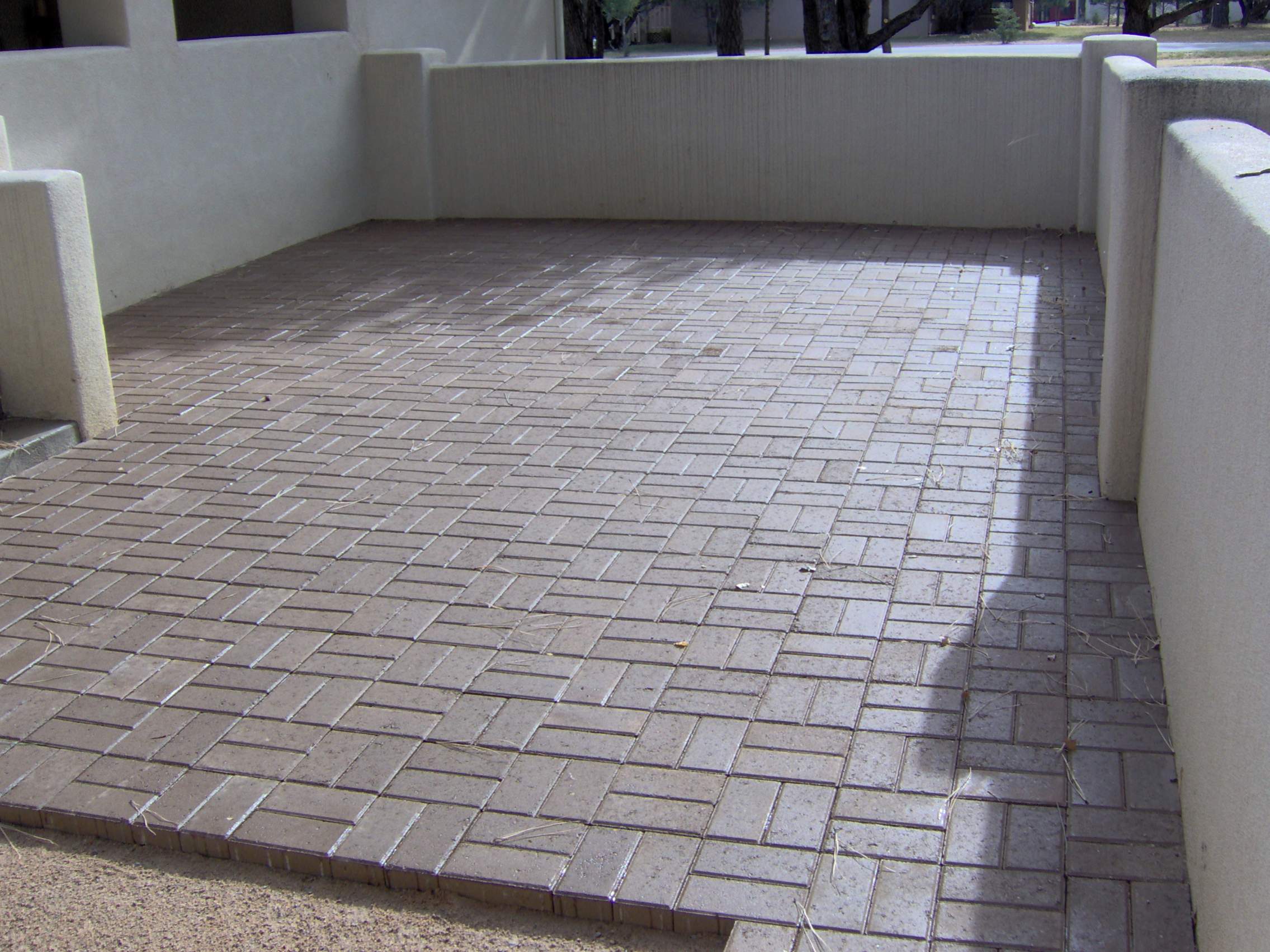

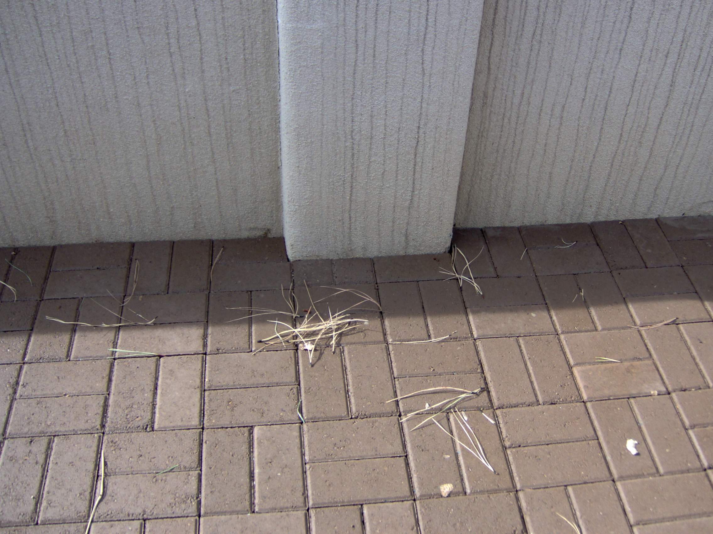

I can't seem to upload pictures right now but do have a couple of pics in my TBN folder. Pics of the 4x8 inch pavers from a patio install a few years ago.
That looks great!

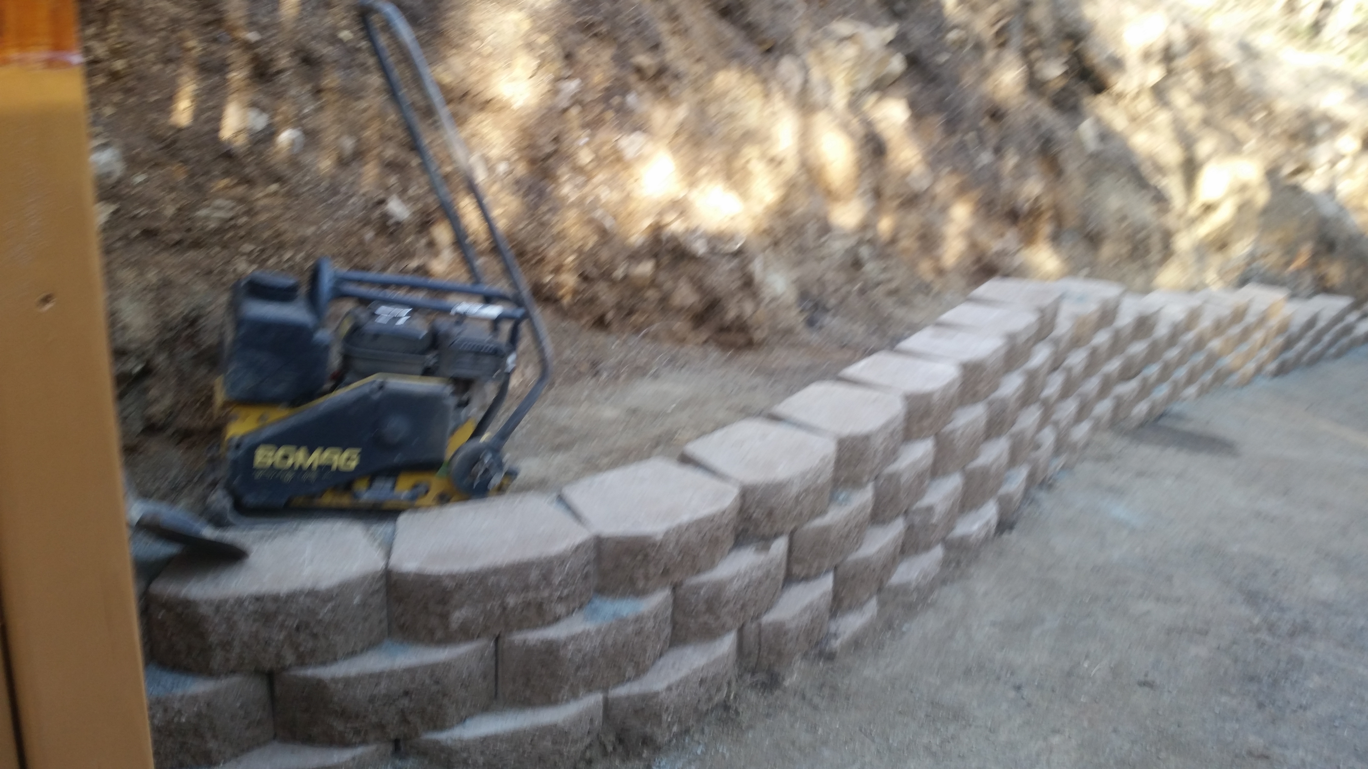

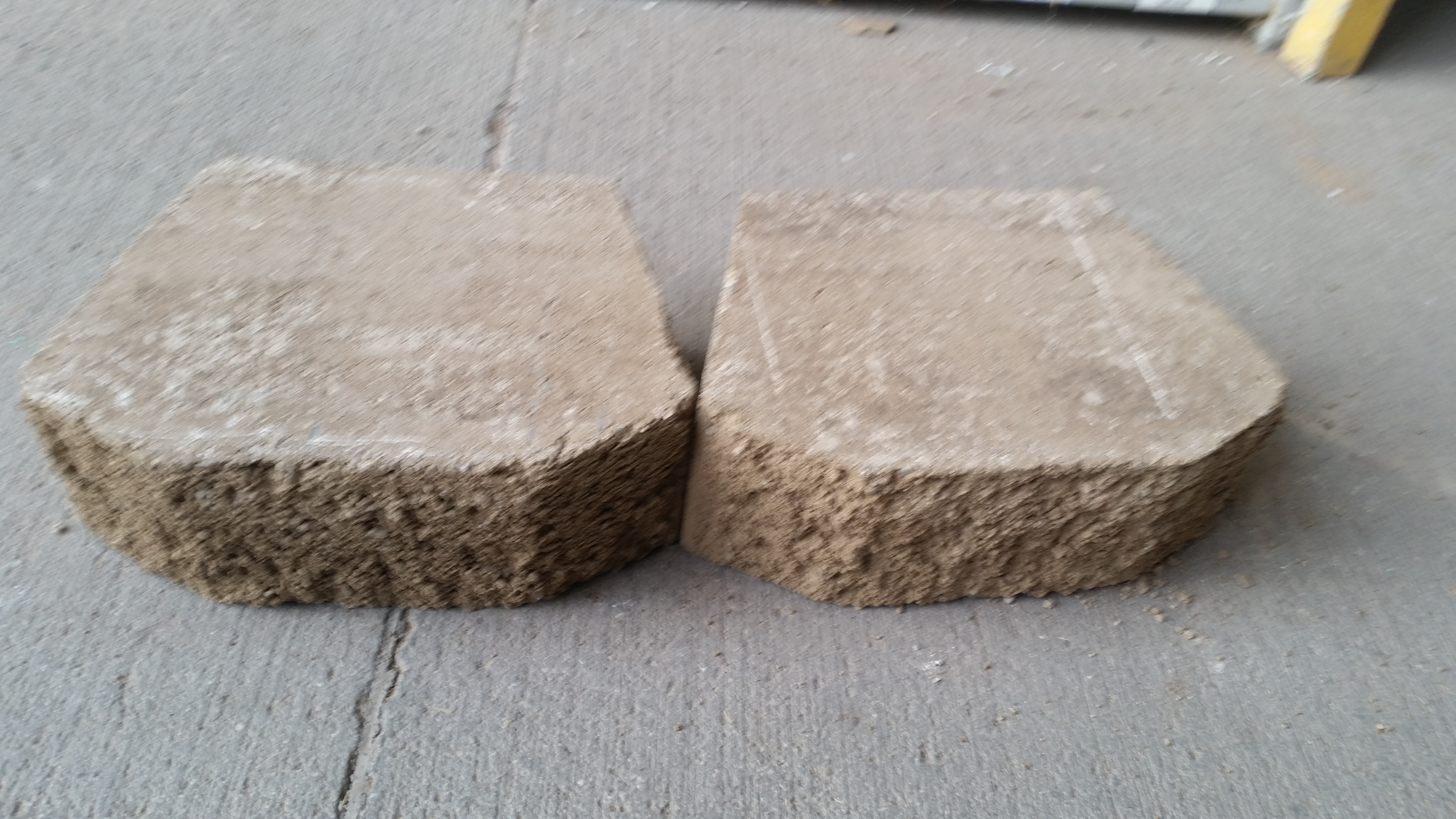

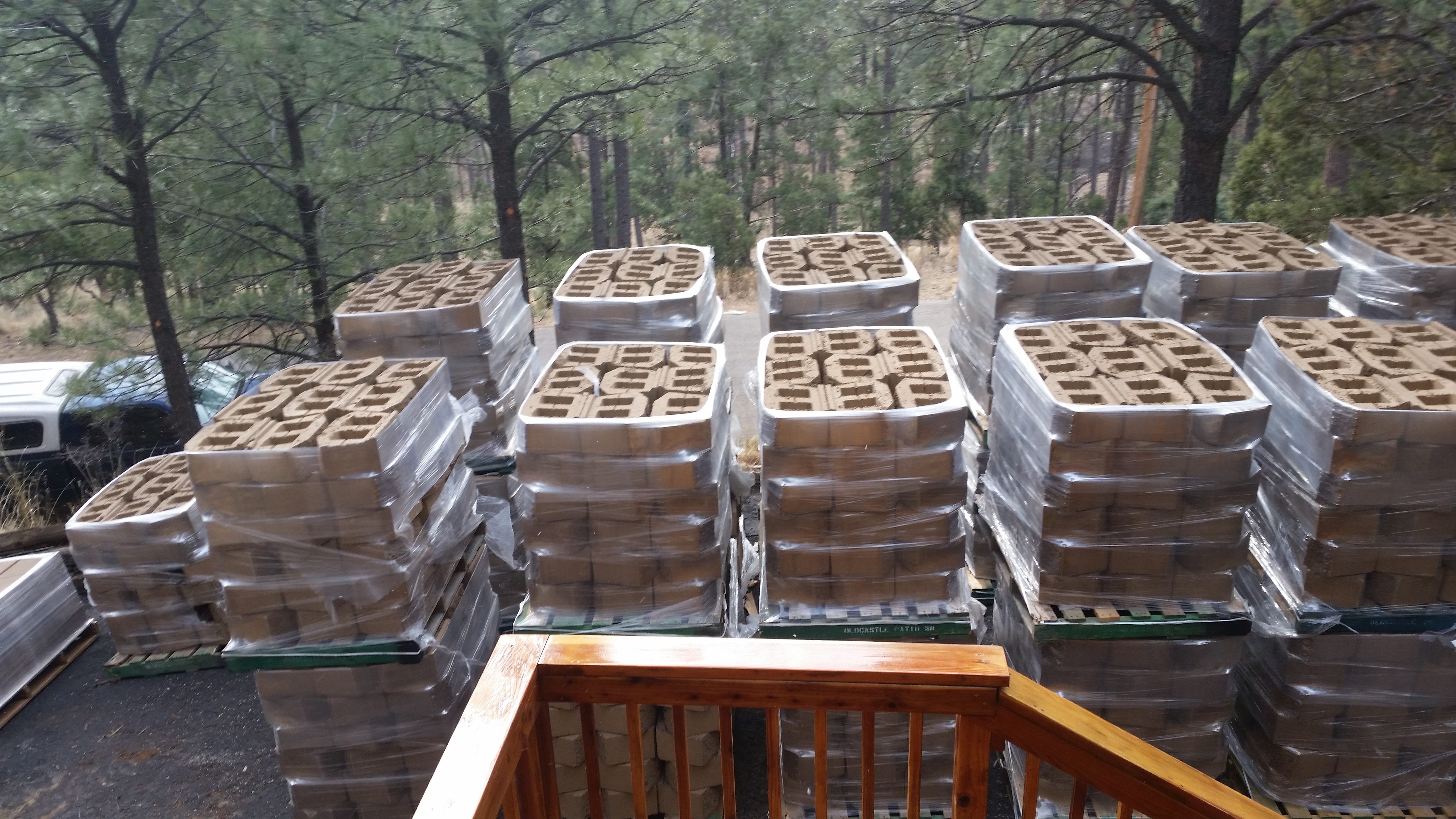

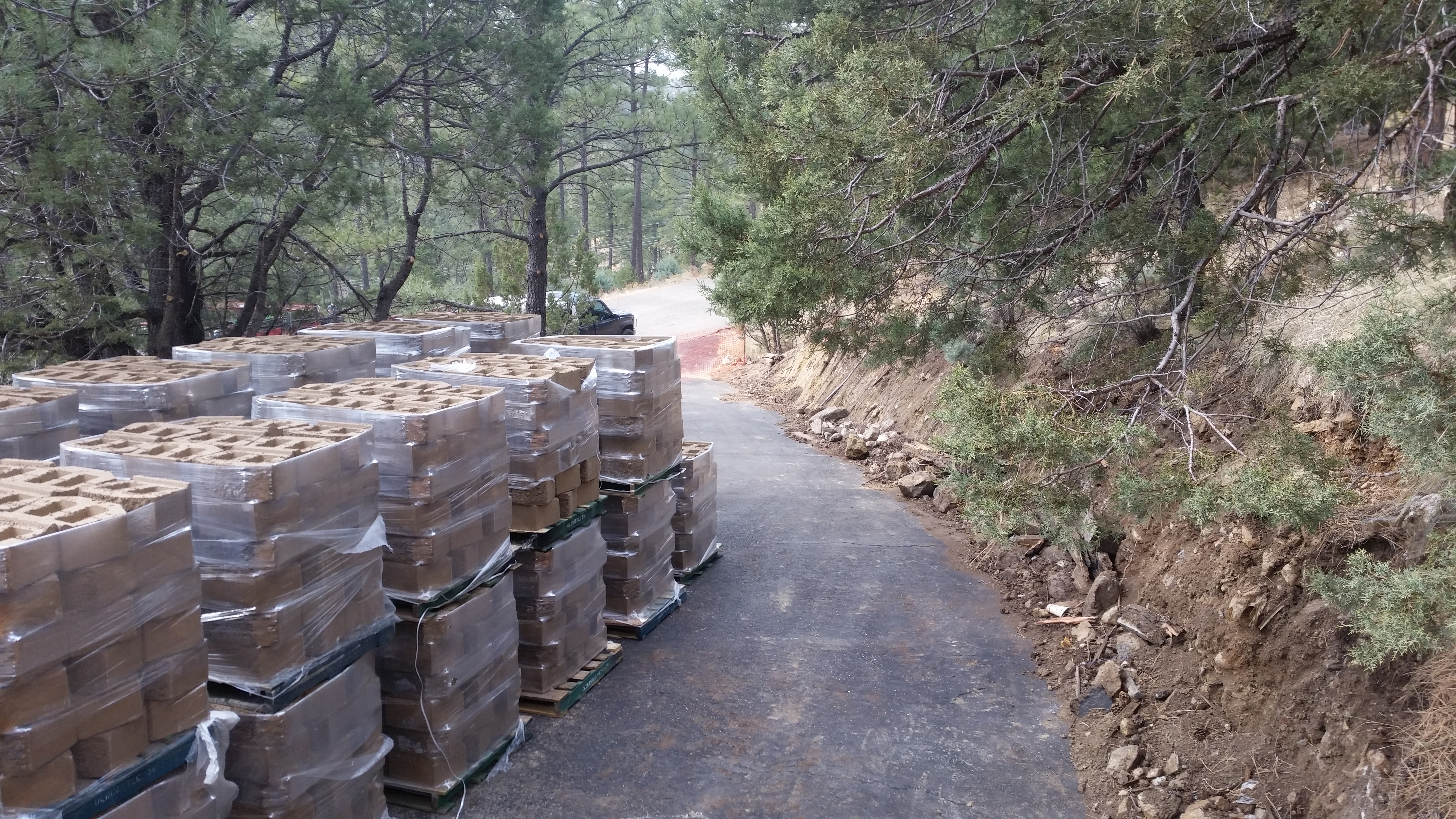

High end pavers and polymeric sand are good for small projects. For most of us operating on a budget cheap pavers, cheap retaining wall block and engineered fill works extremely well. I bought the retaining wall block for this job for $3.50 each delivered up near the top of a mountain. These are concrete with the color all the way through and 62 lbs. each 16x12x6 lwh. Engineered fill is $20/ton delivered. I ordered 2200 block and `12 tons of fill to start. If I had chosen a block that was expensive and used polymeric sand the customer would not have signed up.

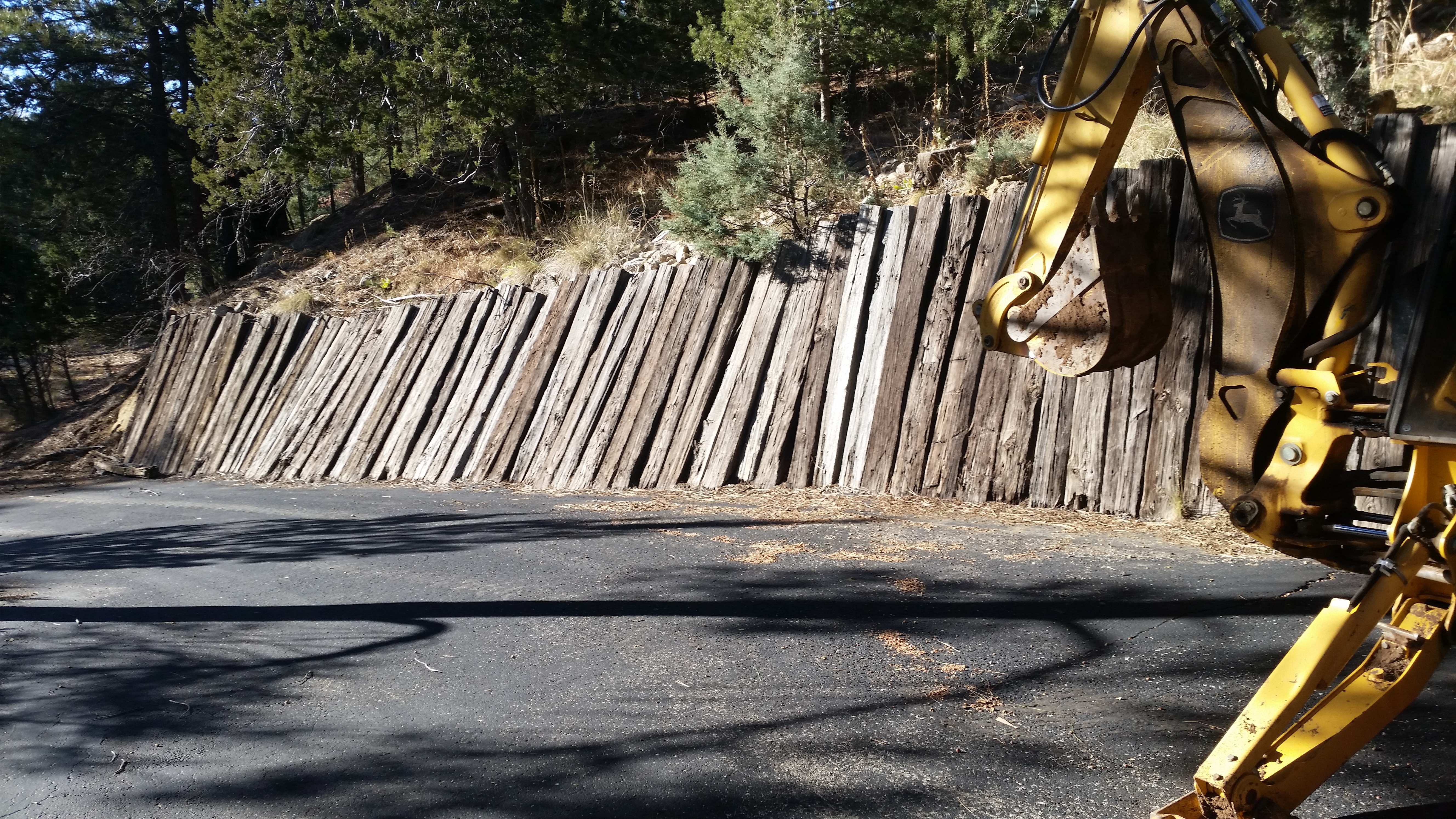

The railroad ties along the 180 feet of driveway have been removed and are being replaced with the retaining wall block. Should be finishing this job in the next week or so.
If any one wants to learn how to do this I will teach you for only $25 per day. Just meet me next week and bring gloves.

Is it just me who likes the look of the railroad ties better?
Lots of people in both camps. The railroad ties in this case were leaning against the bank. Rain had caused enough erosion that the problem needed fixing.
