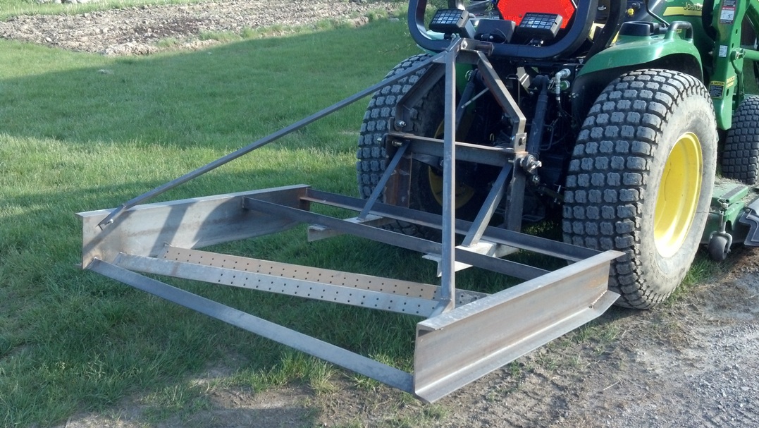

I didn't see any replys by yesterday morning, so I went ahead and gave it a shot. I kept the articulating mount with the chains as I mentioned, and put the grader blades flush with the bottom. See picture below.
Problem 1 - the blades definitely need to be lower, I'm going take Gordon's advice and start at 0.75. I might even go ahead and spend the time to make this adjustable, haven't decided yet.
Problem 2 - the whole thing lifts up at the rear end as I start to pull it. I put 4 12" cinder blocks in the front rack, it helped, but it still lifted up at the rear. Looking at it, it's all about where the pull force is acting. The pins are 16" off the ground, and my 3pt at it's lowest is 12". I could probably lower it a bit, but I wanted to leave some room so the arms would never bottom out. I'm thinking the two solutions would be - weld another weight rack along the back to get the weight further back, or go ahead and mount rigid arms in place of the chains. Both pretty easy to try.
Any other idea's, comments are welcome. This is my first 3 pt attachment build. Still learning and remembering how to weld (it's been a long time since I did anything more than light wall tubing).

I think you would be better off making the whole thing stiff. If you did you would find that the top link adjustment has alot of control over how aggressive it cuts and the back end won't rotate up. It is even posible you would not have to lower the blades. If you wanted to follow the road contour you could put the flex in the top link.
But, if you add enough wt to the back, like you said, it will hold it down. To work good it should be pretty heavy anyway unless you are only working with loose pea stone.
/ Driveway grader question
Thanks Gordon. The more I think about it, i'm leaning towards doing the rigid mount. The drive way is pretty flat for the most part, and this will allow me to flatten any areas if need be better than the pivot mount would. I'll try that and see how it works before I cut out the tack welds and lower the blades. Will update when I get a chance to work on out next. Thanks again.

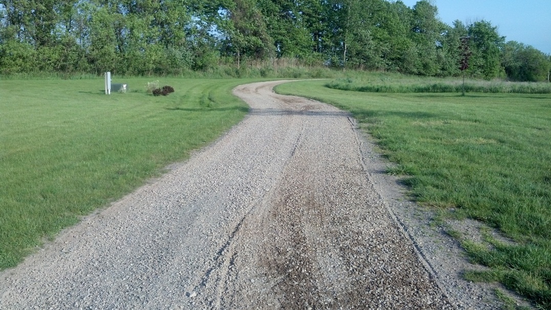

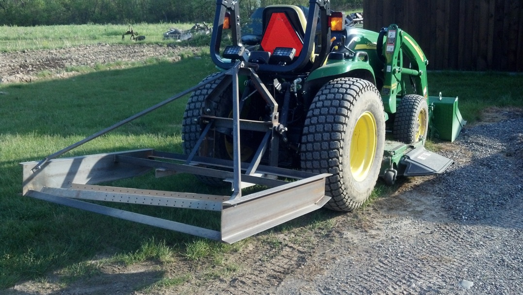

Just an update to this post. I removed the chains, and put in ridgid angle bracing. I also lowered the cutting edges 1/2" below the skids. It works like a charm! OK, I don't know how the factory ones work, but this does a beautiful job. I lowered it down, and with in 3 passes, the driveway was looking great. I did find that it moves a ton of gravel if it's not packed yet, but most of the time I will be using it on a packed surface. I'm very happy so far with it. Here are a couple updated pictures. I still need to finish the welds, weld in some gussets, and get some paint on it. I have had a quart of JD green kicking around since I touched up my bucket hooks. Should look good when done. Thanks again for the advice!

Looking at the pics I think you might want to consider moving the blades forward a bit so that you have about eight inches or more skid trailing the blades. With the top link you can adjust the trim of the skids to cut aggressively (short) or lightly smooth over the surface (lengthen) even with the blades set at 0 depth. I use the landplanes primarily to smooth lawn areas and they work great for this.
