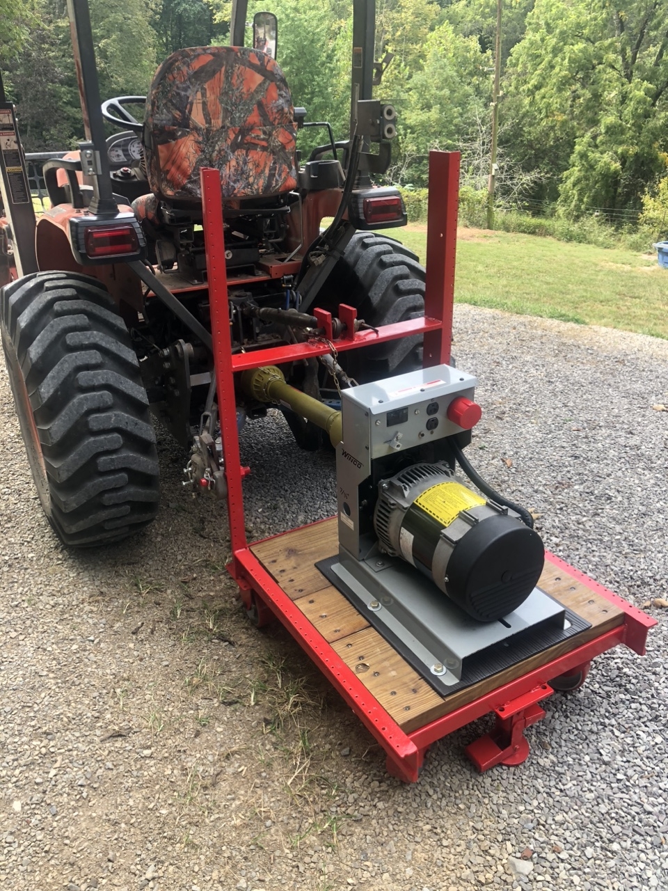

Got mine at TSC then cut it off to the length I need. Works fine.
Also mounted the generator on a 3 point hitch frame, and welded legs on it so that when set on the ground, the driveline is level with the PTO shaft on the tractor.
That way, when you engage the PTO, the generator won't go flopping around and kill someone. Added a scrap sheet metal roof because my electrician said rain could cause issues.

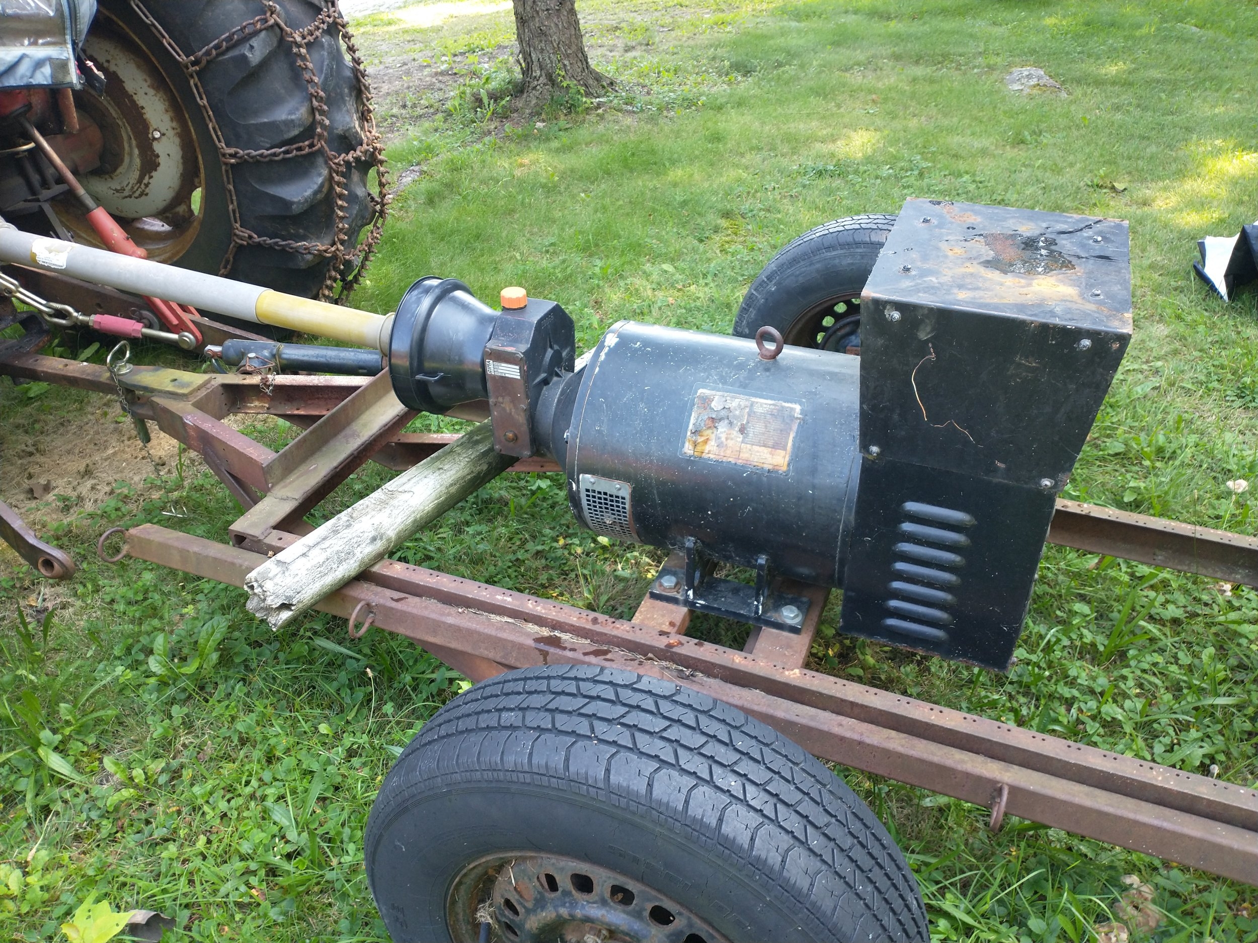

The 3 point mounted generator chassis are nice and compact, but that also means tighter and for me at least more difficult to get in and connect the pto shaft. I prefer a trailer mount with a longer driveshaft that I can actually straddle and hold up to connect.
Much easier on my back while hooking up. And lots more room to reach around and work with.

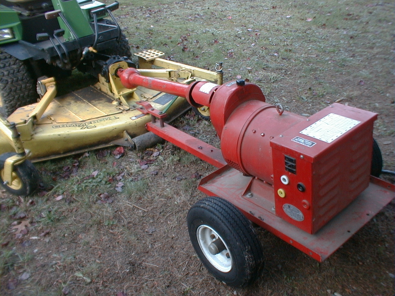

Run mine off my lawnmower
