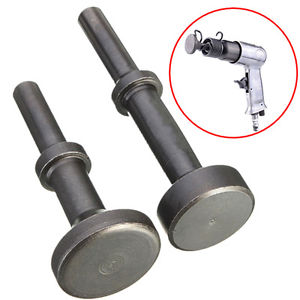

Ditto Dont run without the retainer pin. The pto shaft end, yoke, is expendable, the tractor side not. unless you are an ace on a real torch, I would stay away from heat. that can melt the shaft seal on tractor and then that can be a whole nuther problem. After generous soakings and pin removed. Id park tractor and would put some tension on the yoke with a come along or similar pulling through the u joint and tap (not beat like it owes you money) around collar that on yoke and see if it starts to move. Increase tension tap harder until you arent comfortable with it. A decent air hammer good for things like this. I made my own head for u joint cups and pins on backhoe. If still stuck wrap a cotton(synthetics melt)rag around pto shaft at seal maybe an assistant to direct water on rag and the transaxle (preventing as much heat transfer as possible) while heating at the u joint end, not end closest to tractor and see if that helps. If you havent taken shaft totally apart where its just the piece(yoke) on the tractor you should now, to make easier access and just split the splined yoke end in half with an angle grinder being careful of heat transfer, not cutting too deep into you shaft itself and where you are sending the sparks flying. Im guessing most of these are just cast, not much heat treatment and once get most of way through a chisel would finish job and fall off
