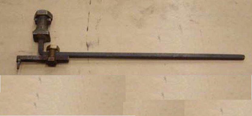

MJNCAD,
I don't want to scare off the O/P, but judging from the finished product in that hook you posted the picture of, I would say you might have messed with a little bit of metal before...
A lot of patience goes a long way when working with metal, doesn't it?

MJNCAD,
David from jax
Thanks David, and you're right that patience is the key. I have tons to learn about metal fabrication. I like working with metal; but am lousy with wood. I find it frustrating.
