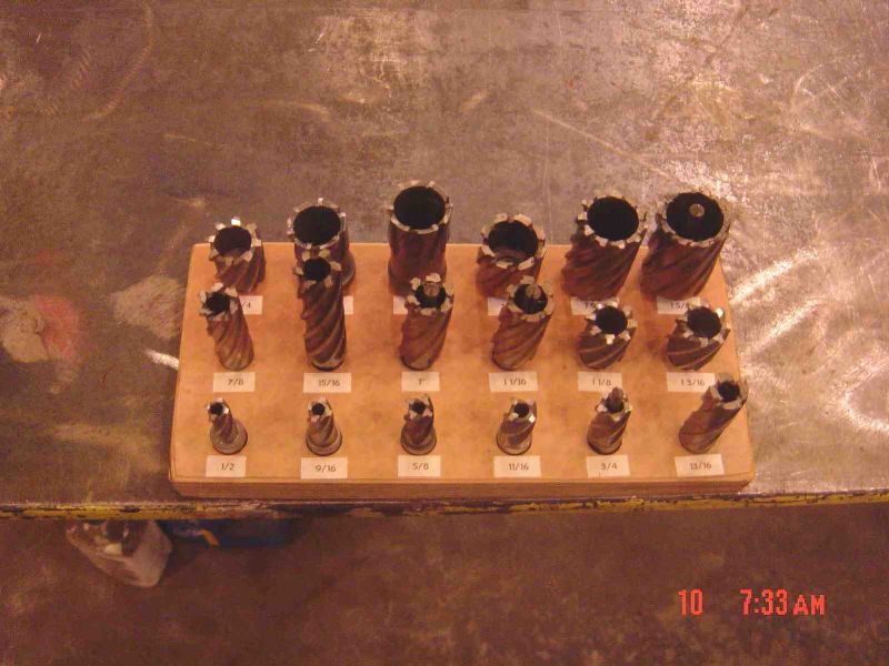

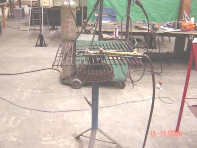

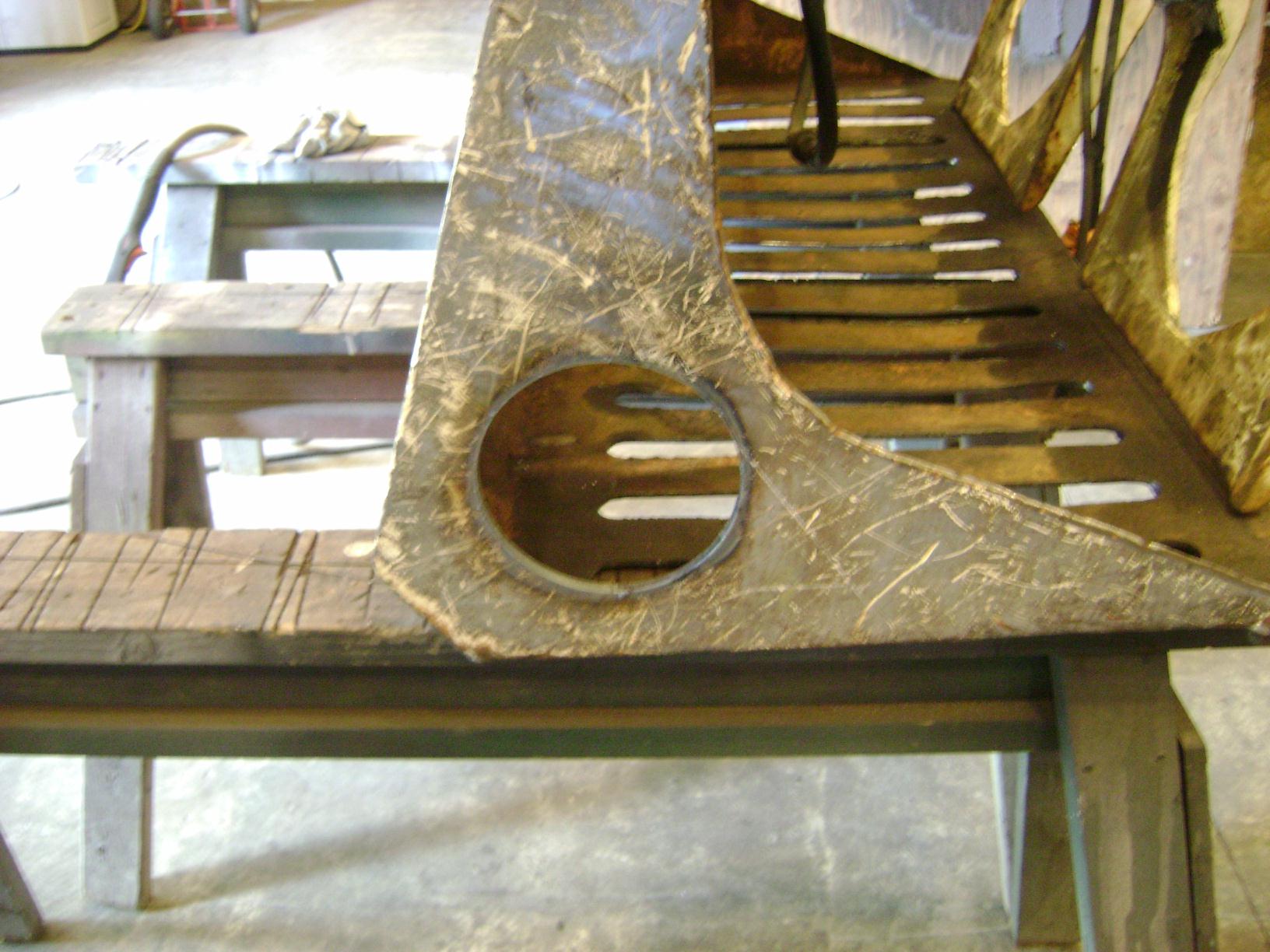

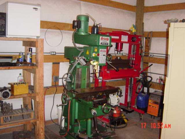

I have a mill and a pretty good selection on roto broaches. Took a 3/4-inch R-8 adapter, and modified it to accept the roto broaches.
I also have a shop built rotating table, with a shop built circle burner. I can cut really accurate holes with it.

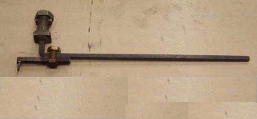

J J I use to have a circle burner like the flangewizard, guess someone needed more than I:mad:. I do have one for the plasma, (haven't used it yet). The one I made is fixed, works great on the rotating table, but somewhat cumbersome any other place, because you can't spin the torch around the center point very easily!

Of course if the hole needs to be precise then lots of good recommendations have already been made. Another alternative option is annular cutters. These work sweet but must by used in either a mag drill, drill press, or mill. I do not own any of these but have used them on occasion at work - much better than a holesaw but cost is more too - but still reasonable as they will last much longer than a holesaw. Annular cutters have been covered on TBN before so useful threads available with a search.

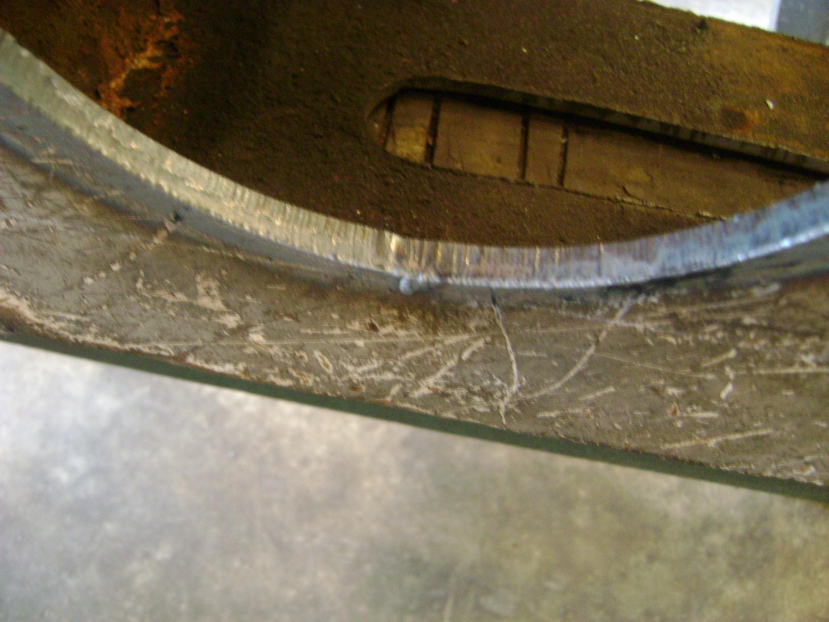

1/4" mild steel.
A new hook I made for my LandPride quick-hitch made from 1" plate. The large radius cut at the base of the hook was done with a hole-saw, and the pin holes were done with drill bits. The hook itself was cut with a 14" Wilton metal cutting vertical bandsaw.
