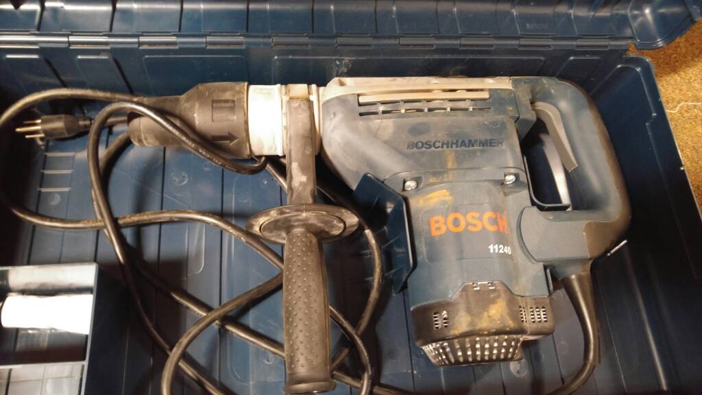

0207181229.jpgi bought this, and a $100 core bit to drill 10 holes.

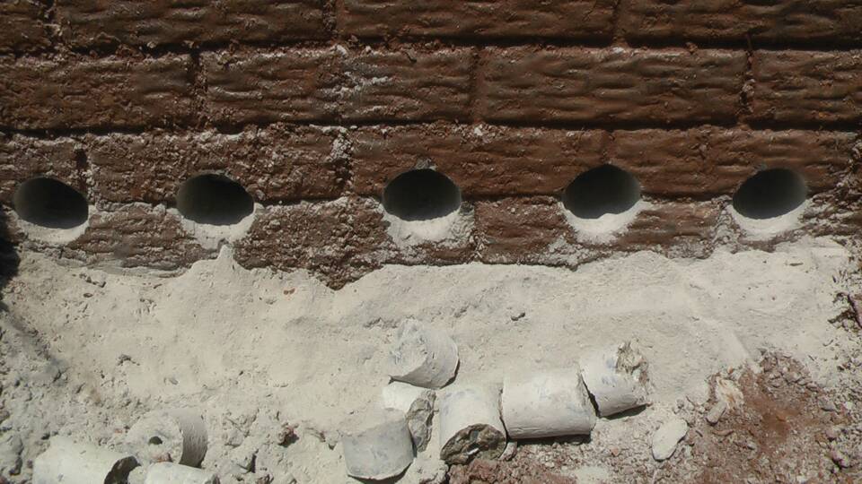

Is this hole in the wall above or below grade? Not that it matters if sealed.
Is there conduit from end to end, or is the direct burial wire and you just want a sleeve thru the wall?
I drilled from the outside to the inside, below grade outside. Sealed with hydraulic cement. No water leak issues.

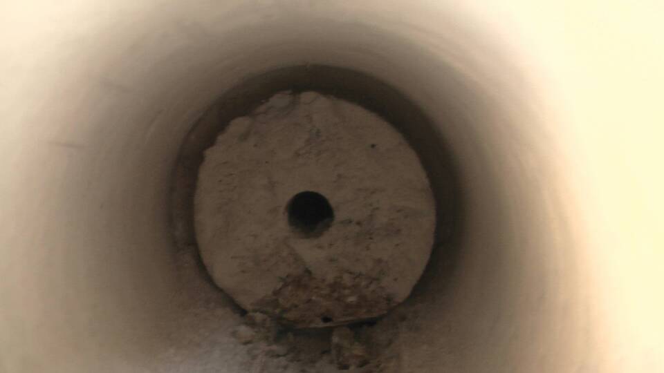

A friend talked me into him and I drilling the hole. The rental place has a 13" bit and my buddy has the drill that will work with bit. The hole will be below grade and we will drill from inside to out. I will then run 2" conduit thru hole and connect to the conduit I have already put in and covered. Need to get this done and get electricity ran. Will plug hole with hydraulic cement since I have a pail. The company didn't charge me to cancel and actually told me that is what I should do especially for one hole. Hopefully it all goes as planned.
