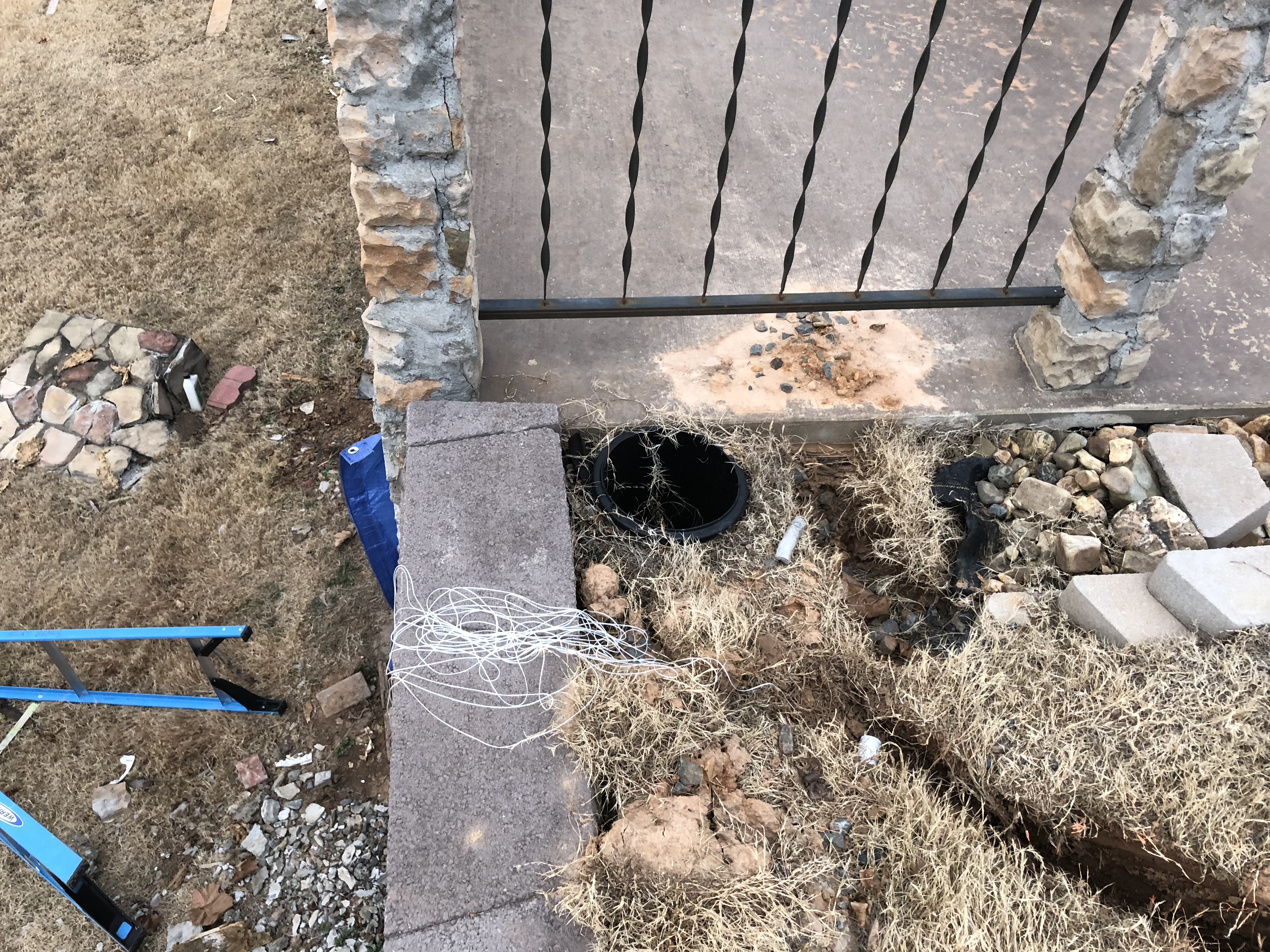

Well I trenched the ditch and put down the conduit and pulled the wire to the concrete building. If I 90 to the right and then 90 to the left and go out two feet I can then 90 down and then 90 into the building through the wood frame front. This would eliminate any holes drilled thru concrete. Here is a pic. I would remove the small piece of retaining wall cap and run it along side the building. What do you guys thing. Bore the hole or go around to front.

Remember that you can only make 360 degrees of bends between J-Boxes. 4 - 90 degree bends or the equivalent.
