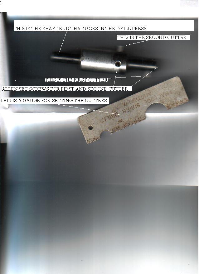

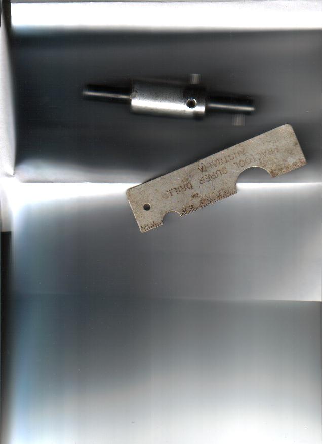

Hi
i am interested to Know if anyone has ever seen or used one of these. maybe a business opportunity for me.

   / drill
Hi fella's
This was invented in Queensland Australia
It is a drill as the heading implied for drilling plate steel
USE (only for drill presses) It drills from 1/2 to in excess of 2" holes
(1) drill a 1/2 " hole with a normal twist bit
(2) adjust the bottom cutter on the shaft to suit the hole size you wish to drill then drill on the slowest spead possible.
(3) If you want to drill bigger than 1" do no1 then set the bottom cutter to 1" and drill that first, then adjust the second cutter to the size you want and then drill that.
I hope this makes sense.

   / drill
Hi fella's
I am having trouble explaining this tool but maybe this helps, (see attachment)

   / drill #10
Yes that's what it looks like to me too. Something like a fly cutter for boring. you adjust your cutter arm to set the diam of the hole you want. I would check out some machinists tool catalogs before I invested in it. The Chinese have made serious in roads to the low end tool market so you may not have the world by tail with them in the game.
