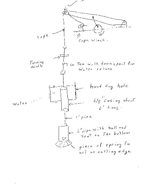

My Grandfather and Father had a home made well drillring. It did drill many wells and was simplicity in itself. :D:D:D
Egon,
This looks interesting. I unfortunately some of the notes on the drawing didn't scan very well. Could you describe the components and how it operates?
