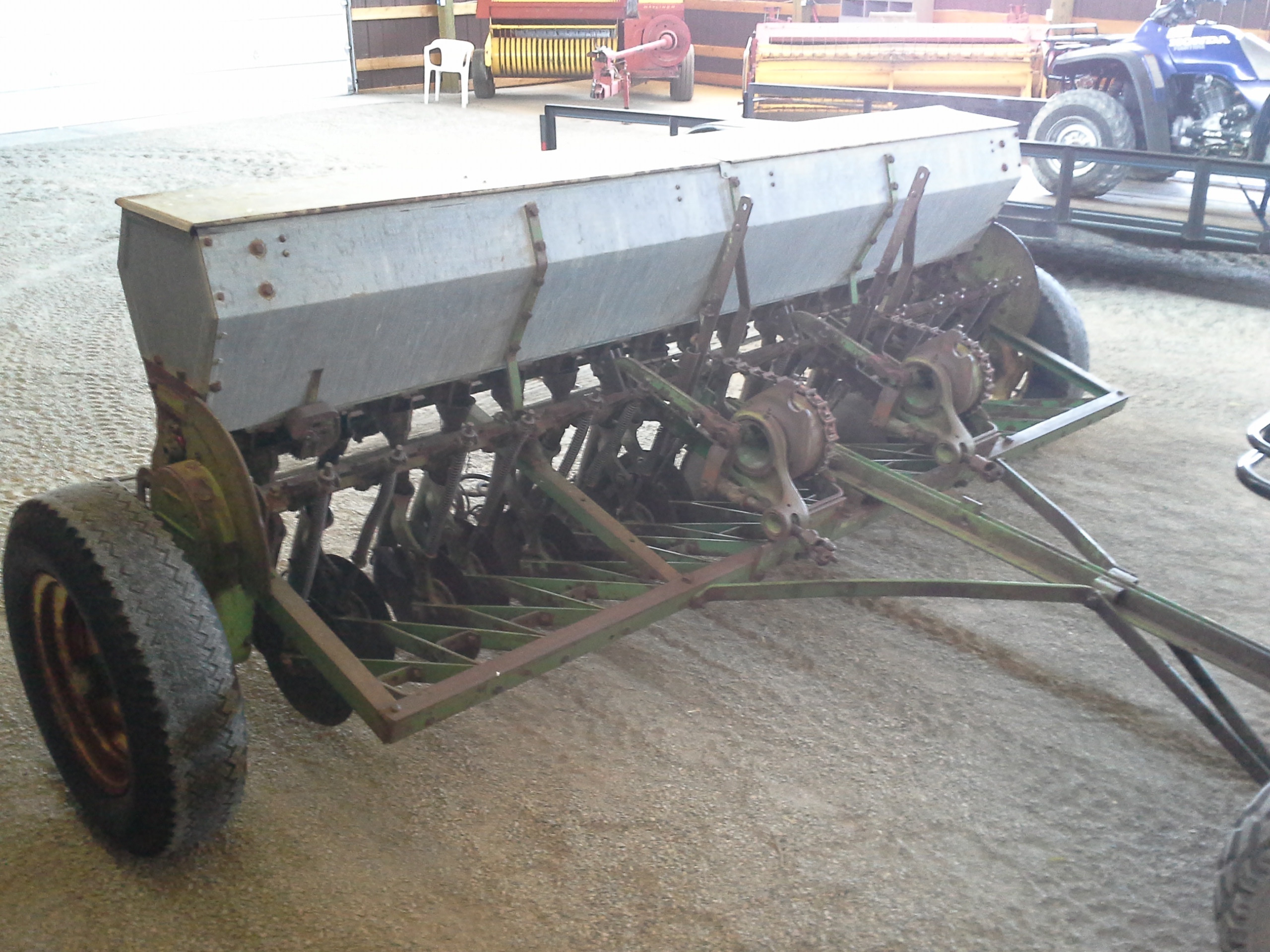

I have a John Deere Van Brunt drill seeder. As you can see from the picture it does not have the small seed box.
Here's my question; could I duct tape the seed outlet mostly closed and then seed with alfalfa? In my head it would work but I'm not sure it would in the field. :laughing:
Hopefully TXJim see's this post and replies.:thumbsup:
I have that exact drill and yes there is a chart under the right hand lid. I setup all my equipment to run on 6' widths so I blocked off the ends to get the 6' dimension. I used thin sheet metal from a piece of junk lying around and held it in place with RTV. Has worked fine for many years. On partially blocking off a hole from inside the hopper, I don't know if that would work for you or not. I have repaired worn places on mine, from the underside with the same thin material....soda pr beer can works great, and RTV so that I could use the minimum settings.
