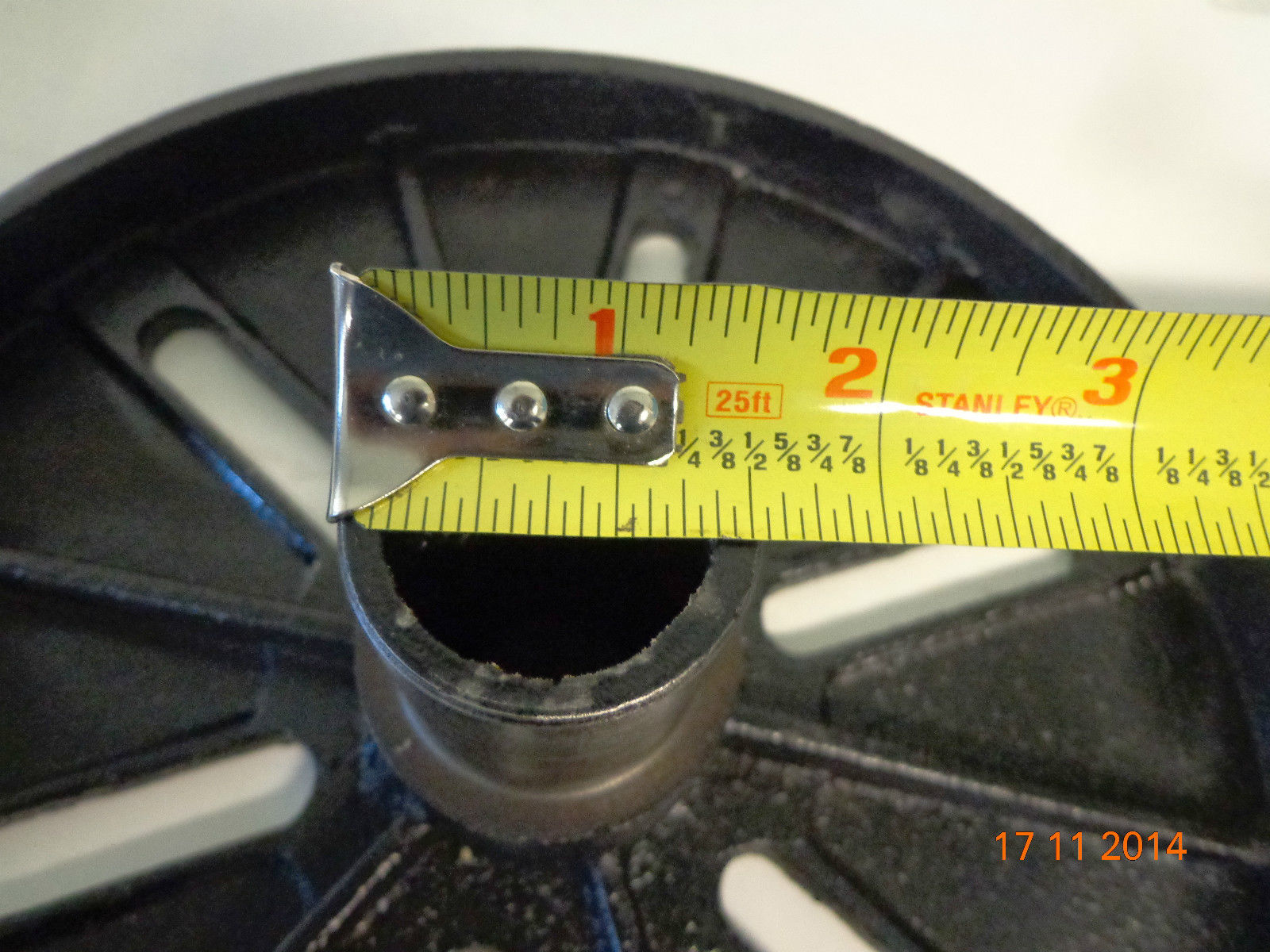

Confirming the stem on your table is 3 ¼ outside diameter and not length? Can it be punched out? Will there be enough material for me to machine it down to 1.9 inches...or insert/weld one that will fit my bracket?

Here is a pic of the stem or bottom of table
Here is the top, It has been cleaned since this pic was taken.
Can that stem be punched out? I can easily turn a stem to press fit or weld onto the table portion. Where are you located? Seeing what it takes to get that hunk of metal from your part of Seahawks Country to mine.

It doesn't look like a 16" diameter table will fit your drill press looking at your last picture with the tape measure.

It would be easy to make a bushing to fit yours, if the table is big enough for you.

I saw that on eBay too...thanks. May fabricate one at this point. Have access to a lathe and a mill. Problem is welding the stem to the table portion...I'm not a welder and don't have ready access to a welder or a person who can weld for me.

Xfaxman,
I decided to get one ready made and ordered it from eBay. Will need to wait for it to arrive to determine the size of the bushing needed.
What raw material would you use if you were to make a bushing. I'm thinking I got only about 0.4" to play with. Think a split tube design? Your thoughts?

Yep I was thinking split tube, since it clamps to keep from rotating. Here is your picture, showing where it will set.
For the bushing I would try PVC tubing first, if it doesn't work, aluminum or brass.
