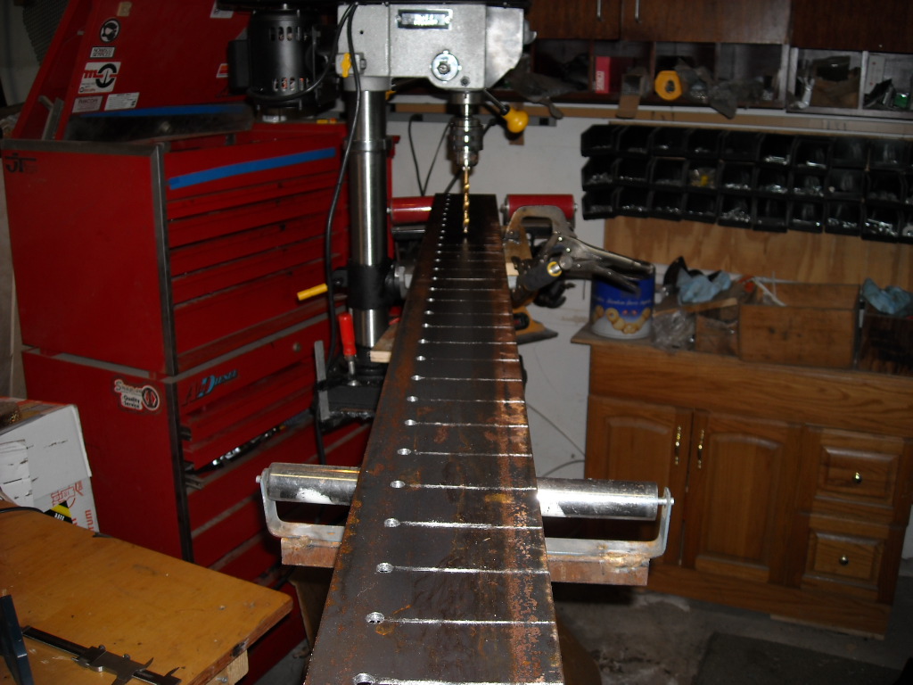

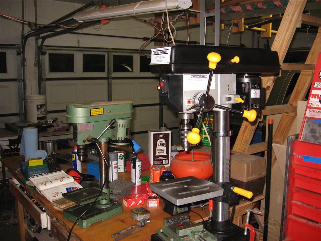

I swapped out the old DP for another HF model. more speeds and a little newer. I have it mounted on a pedestal. Hey it's cheaper than a floor model and everything I drill is smallish. Works great for drilling 60 holes while making a rake for the tractor. Put a block on the table as a guide and just slide it down to the marks. Less than an hour with cool down breaks..
Coupld pics...1st pic you can see the old and the new.
Rob
