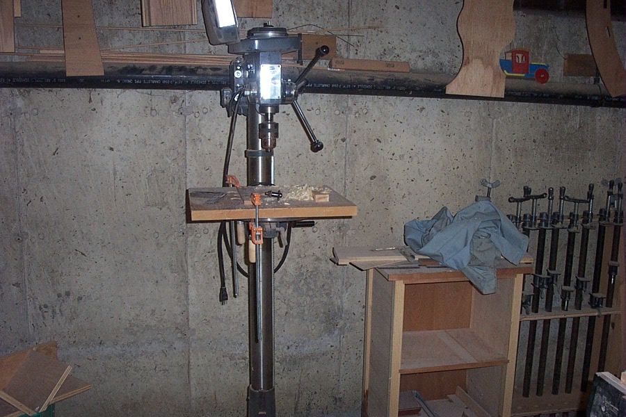

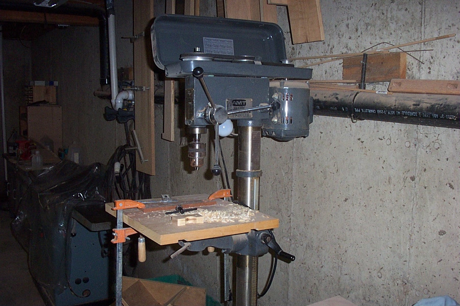

Good Evenin Eddie,
I bought a free standing drill press for my wood shop many years ago. I ended up purchasing an AMT unit, its a nice little machine, it has 12 speeds that range from 250 to 3100 rpm. The chuck is 1/2" and can be removed if you want to insert a drill shank with a morse taper or another sleeve. I use it mainly for my wood working projects but it occassionally does some metal drilling, usually nothing larger than 3/8" or 1/2" holes and then I will drill a starter hole with a 1/8" bit so the hole is accurately centered ! The base and table are cast and I fabricated an auxillary wooden table for a bit more stability. Way back then I believe I payed about $250 so Im not sure what it goes for now.
Here are a couple of pics of the machine, feel free to ask any other questions on it ! ;)
