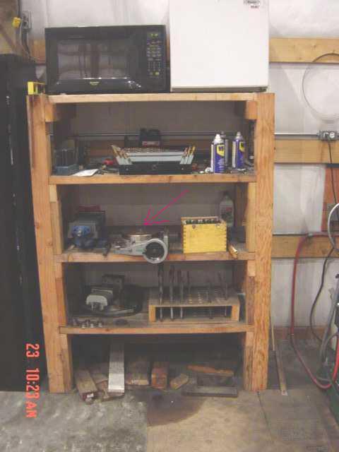

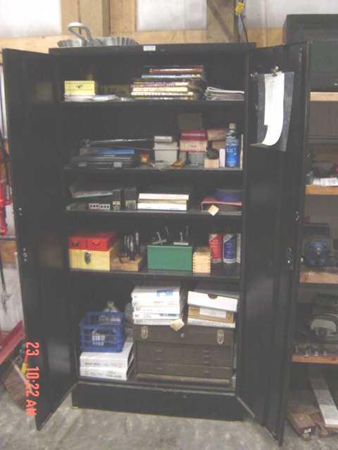

The problem with a mill, the mill is the cheap part! :laughing:
/ Drill Doctor #32
This is what i have heard..LOL..I see the arrow pointing to what i think is a 360 rotating vise....LOL..you have to forgive my ignorance as i am still infant stages of my knowledge..
From what i have read about milling hold the work piece is just as important as the machine cutting..
